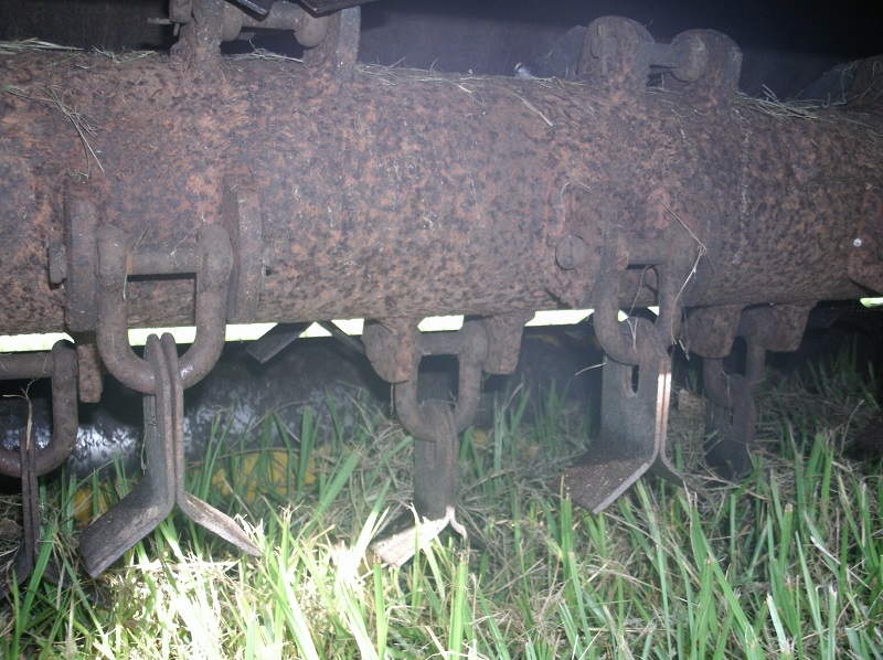

The grass is cut, but only part of the total height. The blades during use are 2 1/2 inches from the ground, but it cuts the grass leaving it 4 to 6 tall. It cuts less and bends it over more in thick grass. The picture here is in the grass it just cut 2 days ago.
Hello justbob,
Are you sure you do not have a rear roller on it????????????????
The image of the flail mowers rotor is good enough to show you have a rear roller there.
The other issue is the belts if they are old they do not grip very well.
The mower should be run at 540 RPM with a slow grouns speed- your stating the grass is simply pushed over tells me that either the belts are wadded/shot , the engine/PTO speed is too low or the ground speed is to high.
NOW- from the photo the skids are fully raised and the mower is in the ground. The rear roller is very large in diameter as well and judging by the image you have side slicers that are too short.
The side slicers in the photo are thick not thin, are they 3 inches long in total length from the top of the knive to the bottom edge???????????
You need to reinstall the rear wheels justbob. they are there to simply prevent the corners of the mower digging into the turf as the skids are non adjustable.

Its entirely possible they bought the wrong knives bob- these knives look exactly like the ones I have on my Mathews Lawn Genie.
EDIT: Is the flail mower level from front to back when it is on the ground bob? That would be big issue if the top link is not unthreaded enough to let it follow the ground as the skids contact the ground.

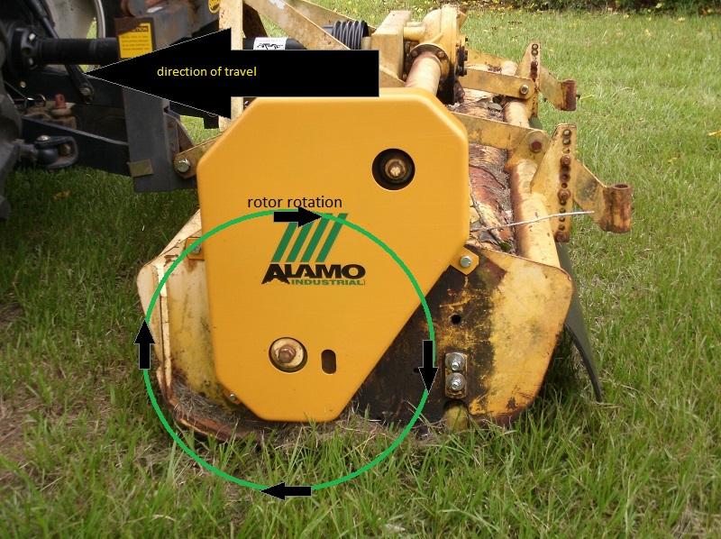

The normal state of affairs is that the flail mower rotor should be spinning towards the back of the tractor-looking at the left side of the flail mower the rotor will be spinning clockwise which permits it to carry the clippings over the rotor and throw them down to the ground.
A forward spinning flail mower rotor is typically used for highway mowing machines where if the flail mower knives and rotor will toss any object it impacts forward rather than backward towards an oncoming vehicle.
NOW if you can adjust the position of the rear roller(raise it) you should raise it up one position and then try mowing with it as the mower will create a higher pressure gradient,
meaning more suction to pull up the grass blades and aid the side slicers in slicing the grass blades and the mower will sound like a big household vacuum cleaner.

The cutter shaft rotates in reverse of the wheels on the tractor...
Changing the rotation would be fairly easy if needed. I searched and couldn't find anything, are there any advantages to either forward or reverse rotation?
/ Let's talk flail mowers #1,373
Ok, I checked today and the belt and pto are not slipping, but the bearings are definitely bad.
You want to leave the rotation as it is bob as it is best for mowing.
