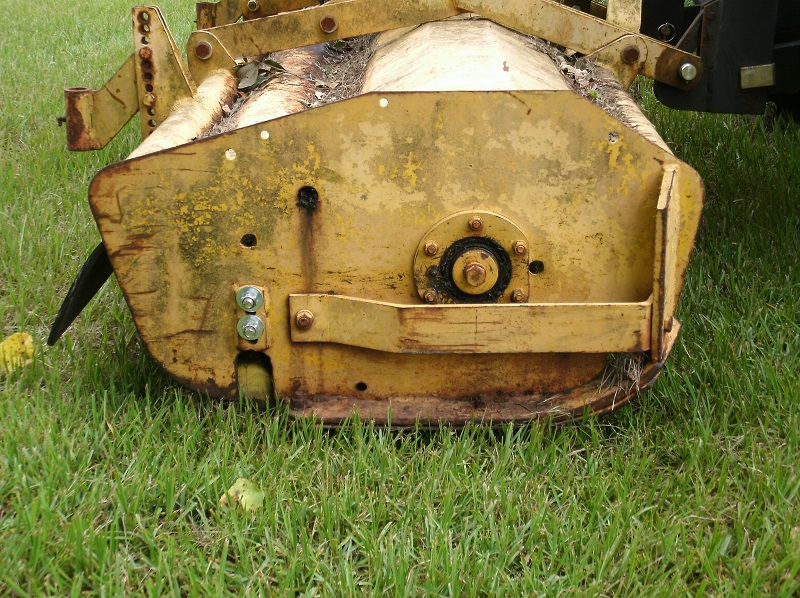

Thanks to this thread, I purchased a flail mower. I am hoping you can help me with a couple of problems I am having.
This is what I have, a Mott 88 flail mower. When I purchased the mower it had tail wheels instead of a rear roller. I purchased the rear roller assembly, rear deflector, bearing for the drive pulley(extension housing), idler pulley, belts, belt guard, and idler spring. It had a new set of knives on it.
First problem is, it does not cut very well. It lays the grass over more than it cuts it, but does ok cutting other than grass. The blades are only .093 thick and 3 inches long, could they be the problem? I had planned on ordering some new ones at the end of summer anyway, I am just not sure which ones to get... is thicker or heavier better?
This thing is annoyingly noisy... I have seen videos and other flails in person, I believe it may be the cuttershaft bearings. It is almost unbearable with ear plugs, is that normal for these Mott's?

Can you give us a pic of the blades as they sit on the ground? The cutting problem is probably adjustable.
Also by "lays the grass over more than it cuts it" do you mean that the grass id just bent and not cut?

The grass is cut, but only part of the total height. The blades during use are 2 1/2 inches from the ground, but it cuts the grass leaving it 4 to 6 tall. It cuts less and bends it over more in thick grass. The picture here is in the grass it just cut 2 days ago.

The blades look good and th4 height is good so the other two parameters are RPM & ground speed. RPM need to be at 540 and ground speed needs to be less than 3mph (brisk walk).... IMHO.
As for the noise it should be a loud hummmm ... about 80db, but that also depends on how far you are from the flail - mine is about 6ft from my ears. Anything noise other than the hum is a mechanical issue. AGAIN IMHO.
