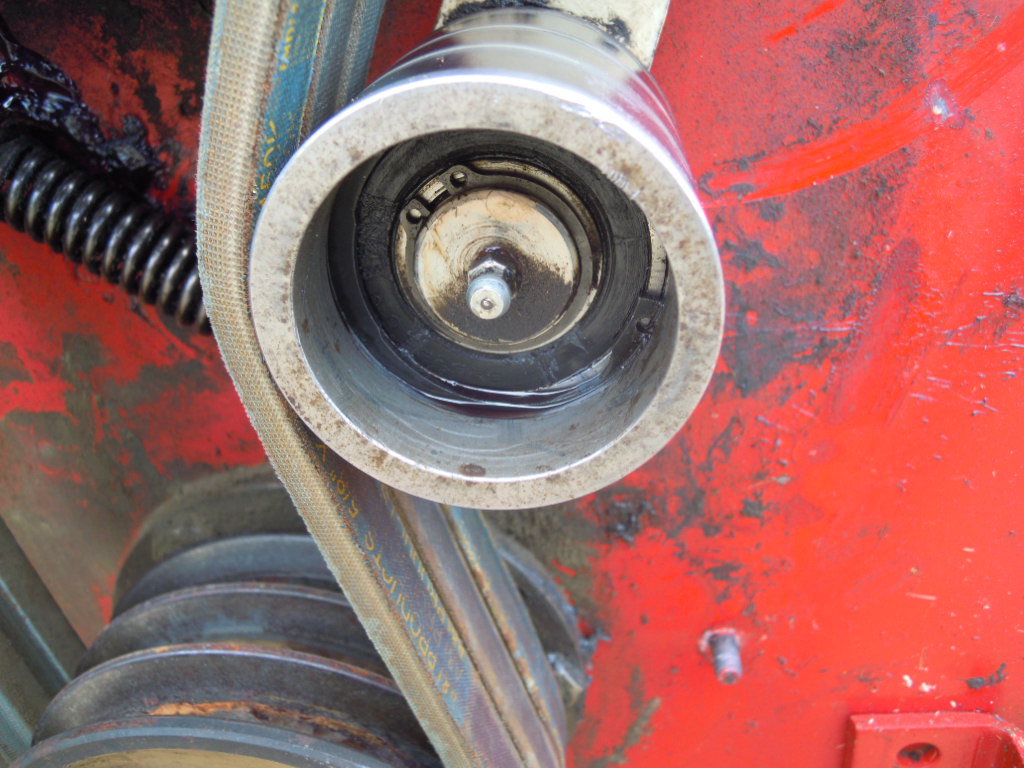

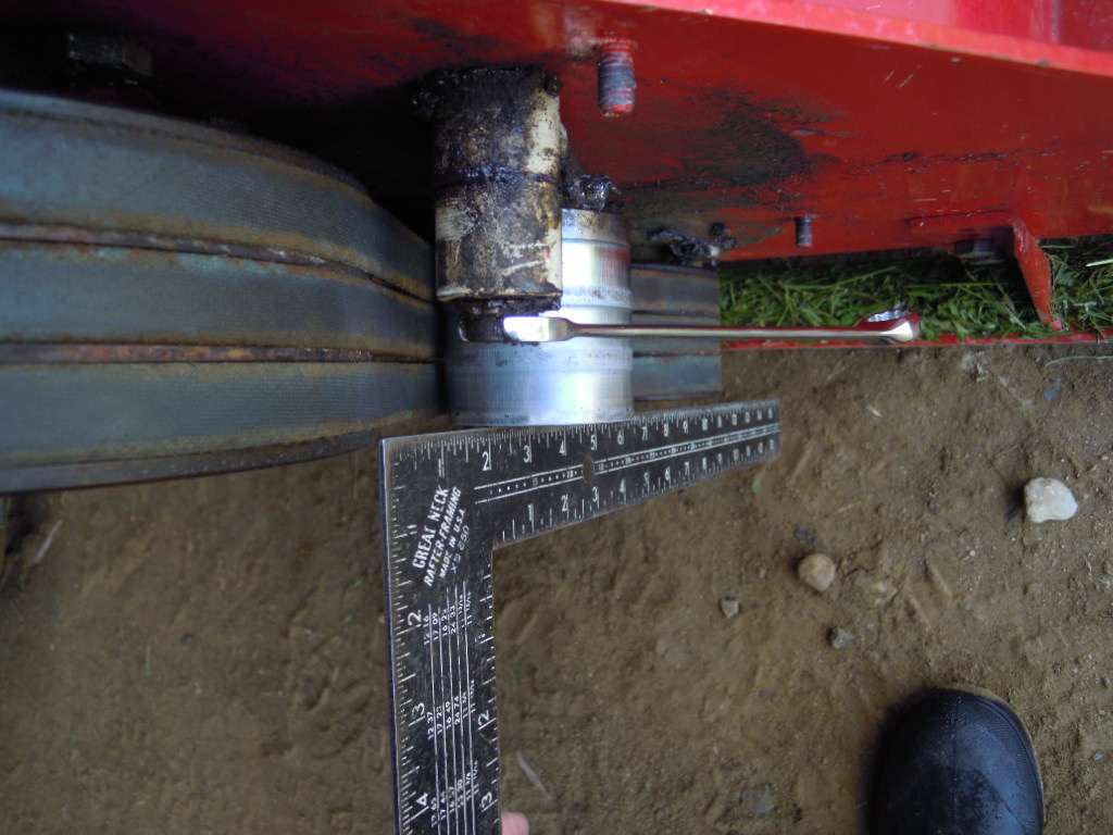

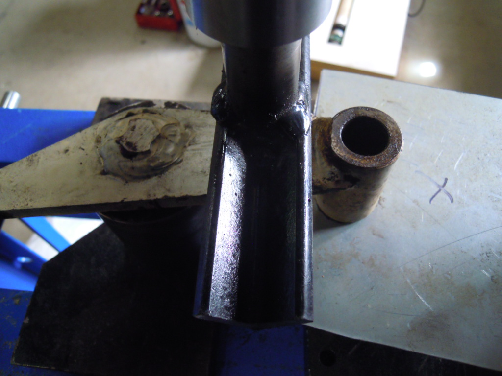

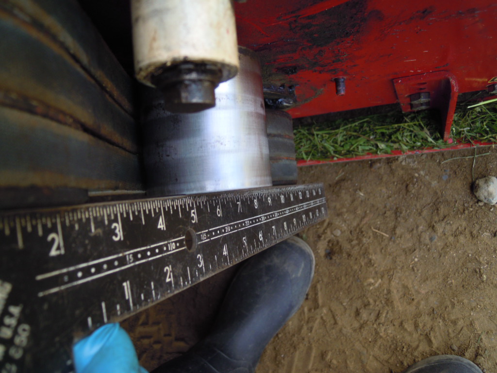

I pulled the belt cover and checked the idler. Looked out of alignment to me (first pic). So I took it into the shop and used the press to bend the support plate slightly (second pic). Back and forth a few times until I got the alignment looking good (third pic). Back together and then a trial run. After 45 minutes of cutting some light grass, the temps on the idler and belts were up to 240*. Seems too hot to me but it was a little cooler than before. There was also what appears to be some liquid grease in the bottom of the idler (fourth pic). Probably not a good sign.
Why not just replace the bearings at this point. Should be cheap.
There is no signs of the bearings being bad but I might as well replace them since nothing else is working. The only other thing I can think of is that the belts are tensioned wrong. These bearings will likely be a PITA to replace. I'm pretty sure they are pressed on.
View attachment 660000View attachment 660001View attachment 660002View attachment 660003
I agree that sounds like a pretty high idler pulley temperature.
Just an observation:

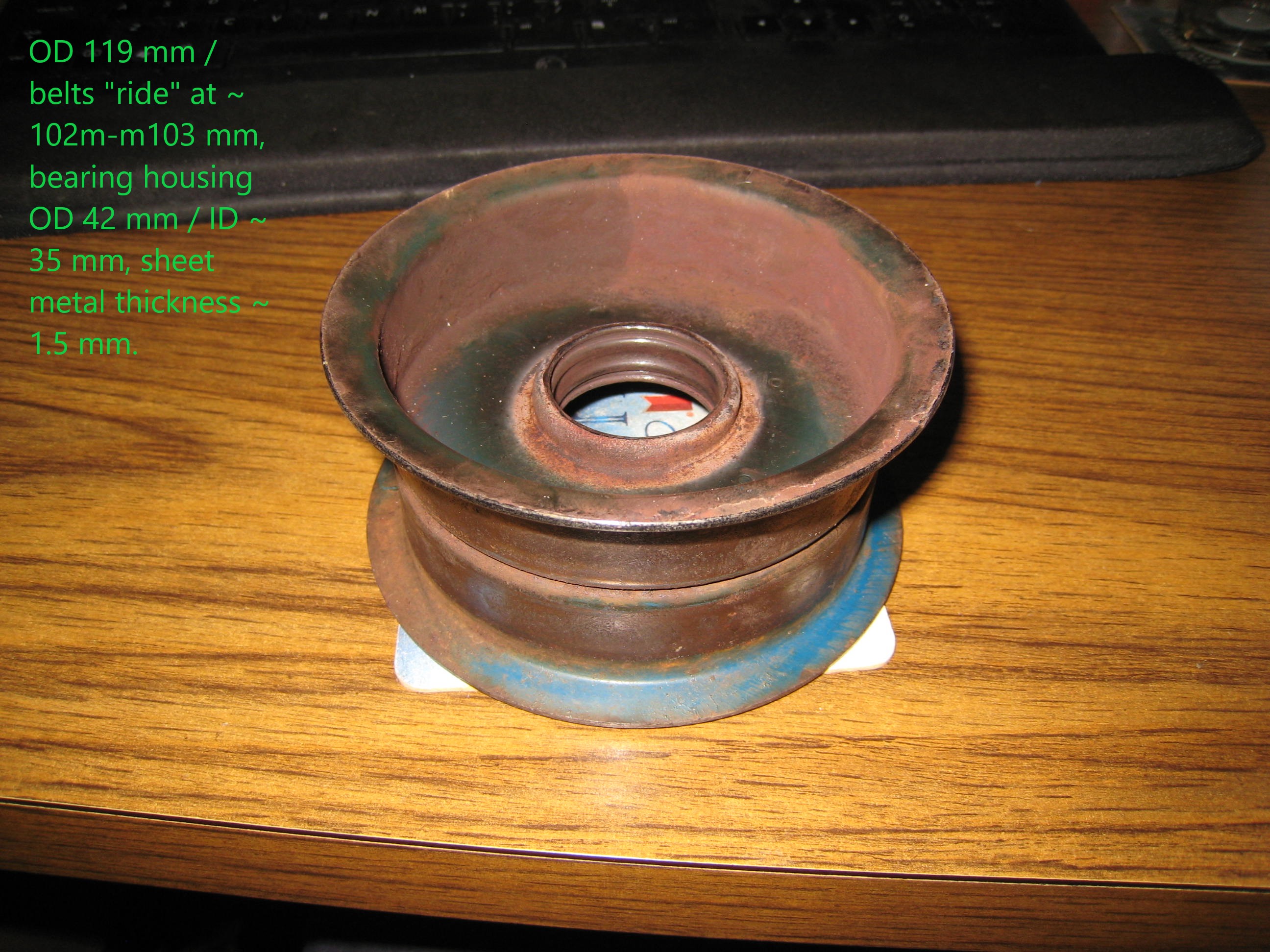

I am just in process of repairing idler pulley on my (new to me) Ford 917L and it is noticeable how the idler looks like it's pretty small diameter in the Caroni.
The 917L idler had failed due to worn out single row sealed ball bearing which was designed to be non-replaceable.
The OD in 917L idler is 4 1/4 inches which I thought was pretty small until I had a look at your photos!
Probably the smaller the diameter the more bending of the belt IE. more heat.
917L idler:
