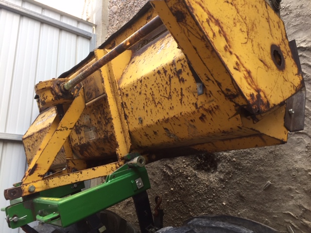

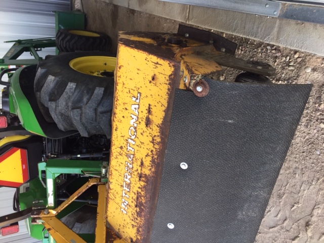

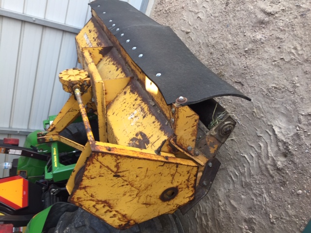

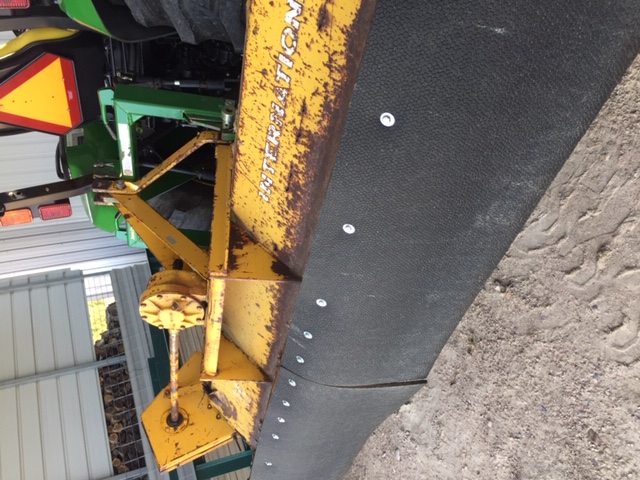

My dad bought this flail mower about 30 years ago at an auction. I think it came from the local college. We used it for 10 years or so, averaging only 20 hours a year. It sat for 20 years and I have started using again. About 40 hours a year
I changed the oil in the gear box, new belt, attached some home made skids... Its awesome I had forgotten how good this mower is!

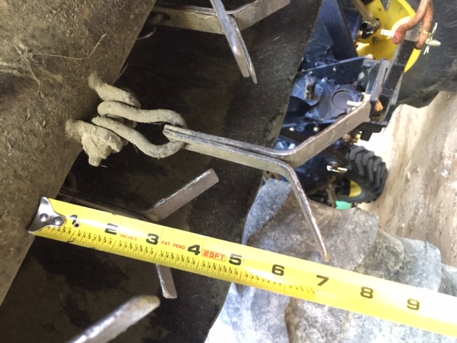

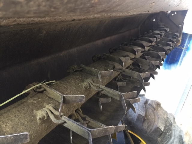

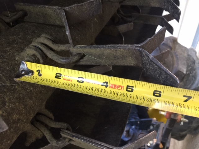

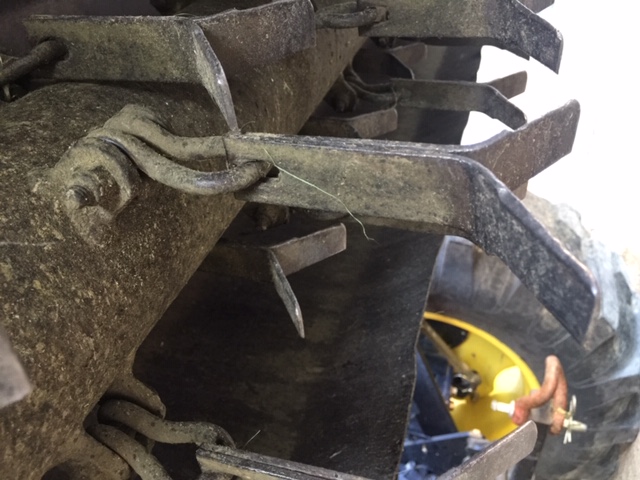

Its missing a couple of the rings that the blades hang from. As I look around I don't see any setups quite like mine. I have read enough on this thread to know there are some experts on here. I'm hoping someone can tell me more about my mower and where I can get matching blade setups. I cant find any model numbers and haven't seen anything online. Ill put some pictures and I can get more measurements based on feedback.
IMG_3062.JPGIMG_3061.JPGIMG_3060.JPGIMG_3059.JPGIMG_3058.JPGIMG_3057.JPGIMG_3056.JPGIMG_3055.JPGIMG_3053.JPGIMG_3065.JPG

What you have there is an International Harvester Company Flail Mower. The first thing I suggest that you do is contact the local CASEIH dealer and explain to them that you have an "IHC rough finish flail mower" with three rows of knife mounting stations and you need new knife hangers, nuts and bolts and spare side slicer knives for your beautiful flail mower.
Do not run the flail mower if there are any missing side slicer knife pairs as it will throw the Flail Mower Rotor out of balance and you could ruin the Flail Mower Rotor Bearings.
My friend you have a gem of a mower there. You need to set up bear traps,tiger pits, an electric fence and as a last resort chain the dog to it and back it into the shed and take the battery out of the mule.
If you were to buy a mower of that size today you would be looking at $4,000.00 used and almost $9,000.00 for a rough cut finish flail of that cutting width as a new unit for a rough finish cut on good turf and a rough cut brush mower would cost that much.
The finish cut flail mowers have 4 rows of mounting stations for the side slicer knife pairs.
It is good to see that the rubber discharge flap is still intact as it holds the grass clippings in place.
The great thing about finish flail mowers is you can go back over the clippings and recut them so there are no dead grass patches in the lawn.
IF the local CASEIH dealer cannot provide you with parts check with the flail master people in Tennessee as I believe they have that type of knife hanger in their catalog. If they do not have it the clean cutter folks may have them.

Noco: Before long everyone in this line of interest will tell you that http://flailmaster.com/wp-content/uploads/2019/04/Flailmaster_Catalog.pdf is THE source for parts regardless of brand. Esp if you cannot find any local source. I'd be very surprised if any IH/Case dealer still carries flail mowers of that brand -- unlikely they are still made. You MIGHT luck out and find a old dealer in business for decades who still has parts.
Good idea to find the model number and if possible & the serial number from your mower. Essentially every state and many counties use flails for roadside maintenance and there are lots of dealers even in small states that provide parts for the roadside people. It looks to me that your rubber protective flap in back is new (probably you put it on?)

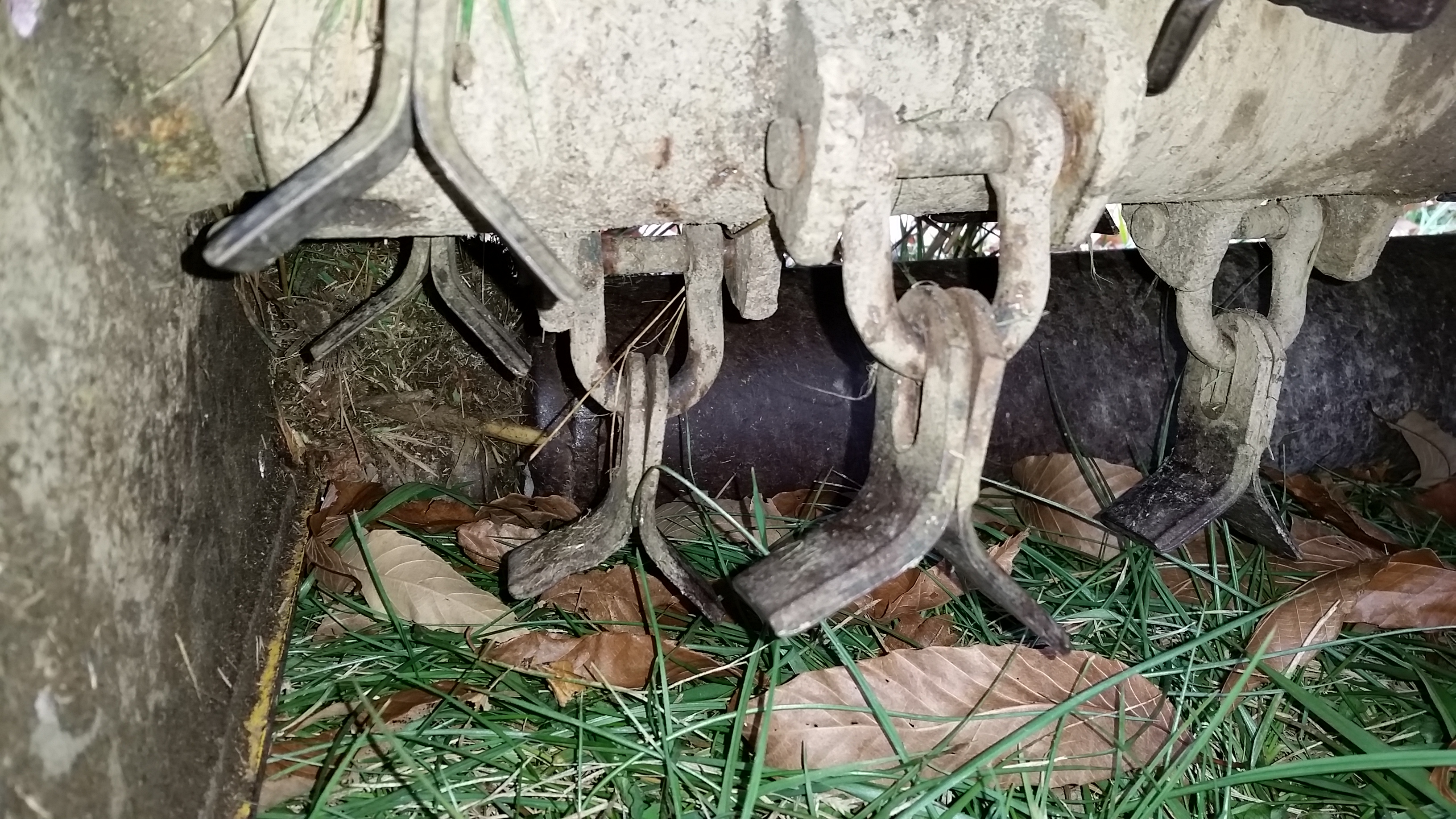

Here are pictures of the flails on my Alamo SHD88 mower. You can see that the idea is the same, but the way the clevises are attached differs from yours and they are (of course) not compatible. Your flails are lighter but much longer than mine too. I'm sure you know, and others have mentioned, that the flails must ALL be present and ALL be matched or you will get horrendous vibration and troubles.
Another immediate topic is bearings. Are you able to get grease gun flow into them ? Bearings for the roller at least (from my painful experience) are rather expensive being typically pressed into a housing and having to be bought with the housing. As with ANY piece of equipment a good dealer is worth his weight in gold and hopefully you find one both for parts and for sage advice.
How wide a cut is your mower and roughly what year?
Good luck.

Thanks for the info! Ill ramble on here and give you guys some more details.
I'm in Northern Colorado, weld county. We are still a pretty big ag area but its changing. Flail mowers aren稚 very well known around here. My 75 year old father-in-law has farmed all his life and wasn't familiar with them. He always used rotary mower (brush hog is what everyone calls a rotary around here) after he saw me use this last year he ordered a new 7.5 or 8 footer from John deer. I know they are expensive.
We had a big case IH dealership in town now its a kabota Ill try them.
I had looked at the flail master catalog and could not find mine. And looking around at pictures and various searches I haven't seen anything quite like mine, so I was hoping someone was familiar.
This thing looked old when we picked it up at auction 30 years ago. If I had to guess it was 30+ old when we got it. Making it over 60. I was still in high school lol. We put all new hangers and knives on that my dad got somewhere.

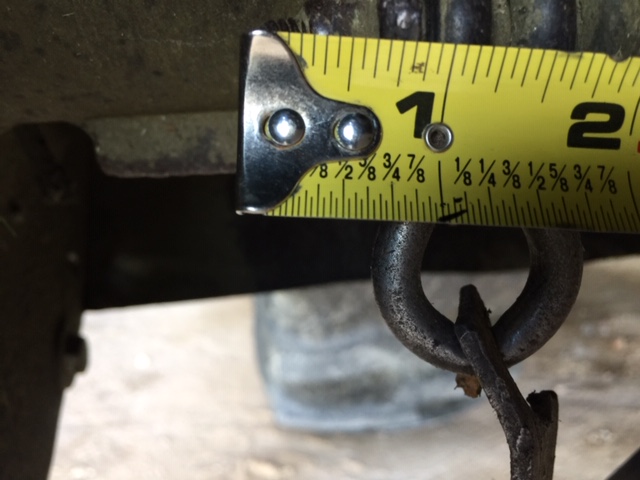

I have a few extra blades but no hangers. Im missing 2 hangers. Last fall I started looking around and couldn't find any so I fabricated a couple by heating and bending some 1/4 rod. One is still working and I lost one.
The inside of the tabs measure 7/8. OD is 1 3/8. I was thinking if I had to, I could change them all out but I cant find anything that would attach to that size tab (I don't know the terminology) either inside or outside.
I can get exact measurements but its about 8 foot wide with 7.5 cut.
I did put the back flap on. I used the thinner half inch thick stall mat. It does the job but I would prefer something lighter. This is hard to hold up when I look under. I have spent hours under it cutting out barb wire.
You don't have to tell me how sweet the flail mowers are. I love it. It mowers grass pasture almost as nice as lawn. It can hit rocks, concrete, prairie dog holes, thick weeds, sticks and about anything else with no worries. Although I hate to hit concrete and rocks.
