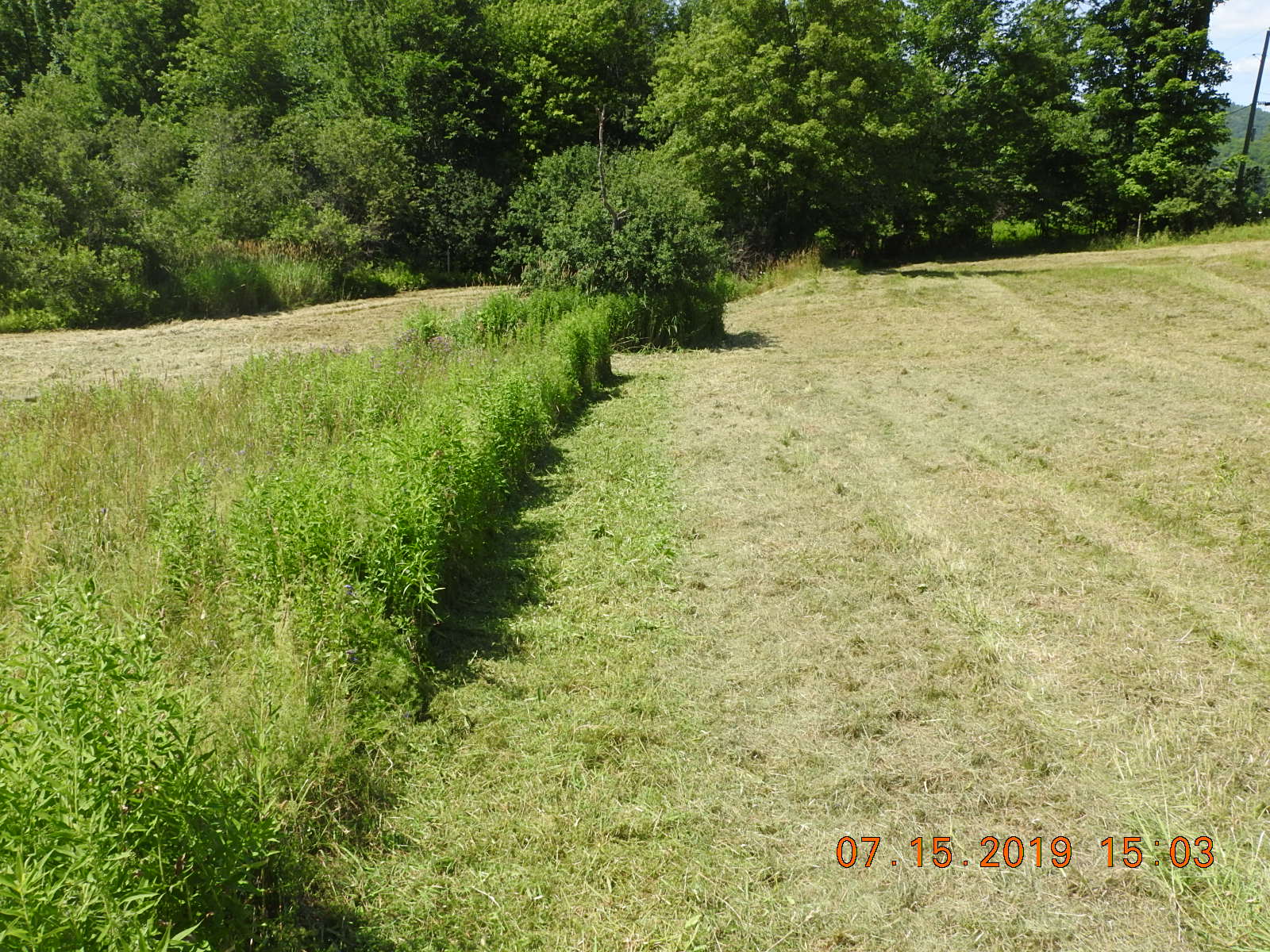

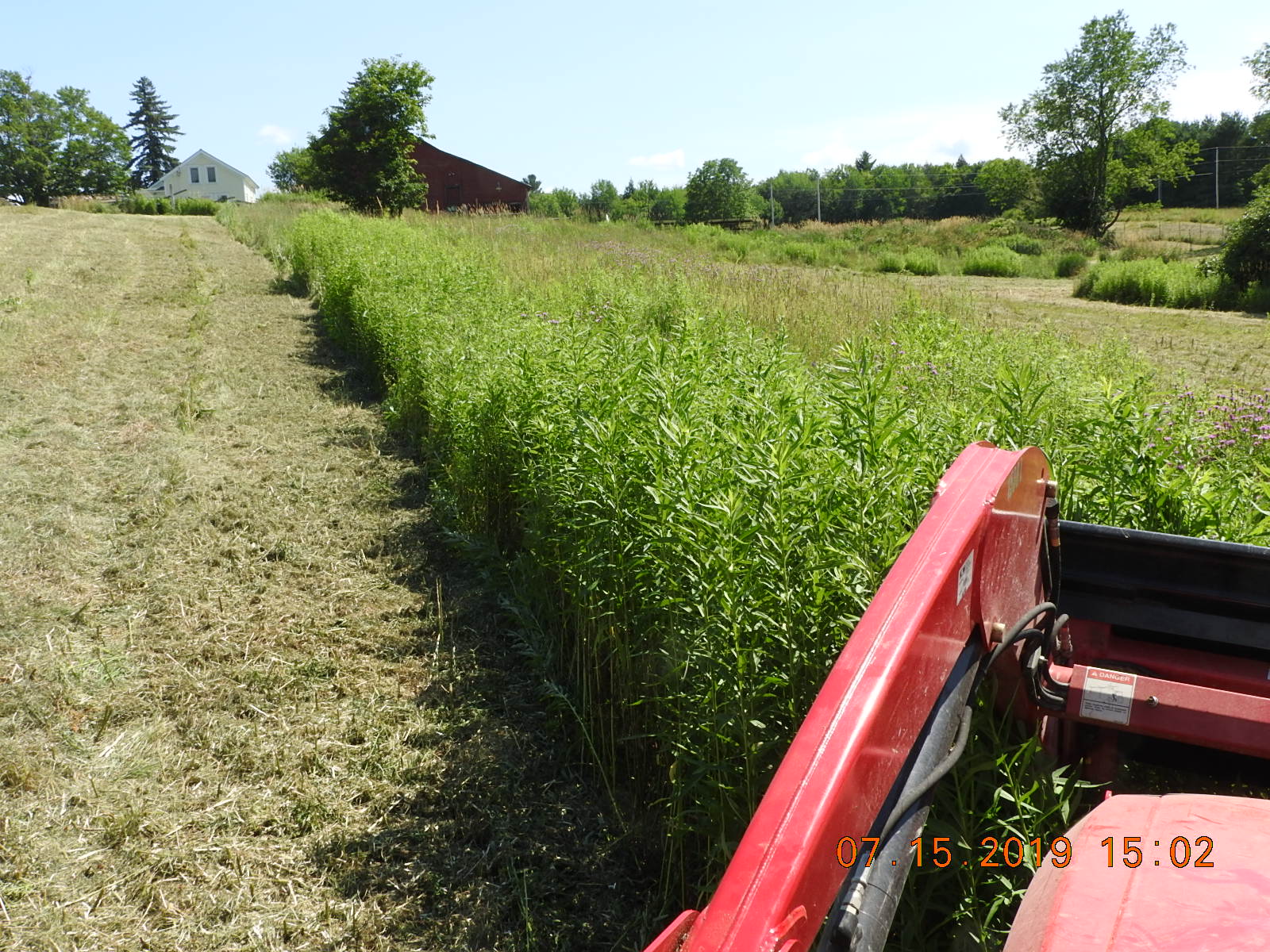

Pictures of what I mowed and what it looked like. I got the knives, not the hammers/duck foot.

   / Let's talk flail mowers #6,146
My tractor dealer had hoses made up so I could "borrow" the curl/dump function from the loader and got adapters for the flail's male thread end fittings plus the needed quick connectors. I connected all that and shifted the mower left, but one of the adapters leaked and I couldn't shift it back to the right. So I disconnected the hydraulics and mowed with the mower all the way left. I have finally gotten a replacement adapter at Advanced Auto (same store different guy, the guy the prior Saturday didn't have any. The guy last week said he probably didn't look in the Hydraulic section )
View attachment 614419 View attachment 614420
