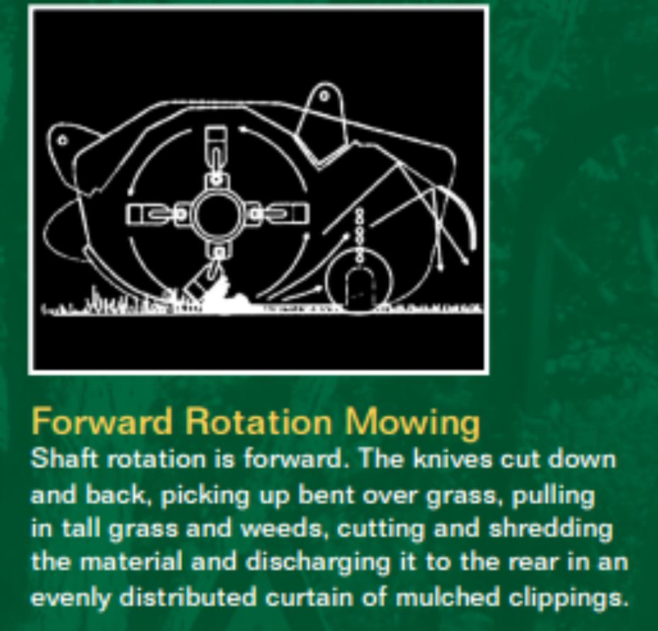

I was wondering if any of the flail experts can advise on the 5ft flails that came with my two cub lo boys 154. I read an interesting post online after I got two of the flails moving, greased, and essentially operational. The poster made reference to a certain flail only working on reverse rotation PTO machines like the Cub 154 and perhaps early Kubota's. He called the Mott Flail a CLB 60. Basically the point he was making is these flails will not work on my standard Ford tractor do to the PTO. I was about to adapt the PTO shaft this week to fit my Ford tractor. If anyone has experience in using Mott 5 ft flails that came with Cub lo boy 154 I would be interested in hearing your thoughts. I really want to use these flails in the spring but I'd rather not keep the 154 Cubs. Thanks in advance

Riddlewitz, it should be pretty easy for you to determine if your mower will work on your tractor. Simply turn the PTO shaft the same direction as you tractor will turn it and notice which direction the blades move. Look at the cutting edge of the blades and see if they are moving so they will cut the grass.

The cub flails 5ft do in fact mow in reverse. I'm curious how that will work? How the finish cut will look. Thanks for the help

This is what Alamo calls forward rotation, same direction as the tractor wheels:
