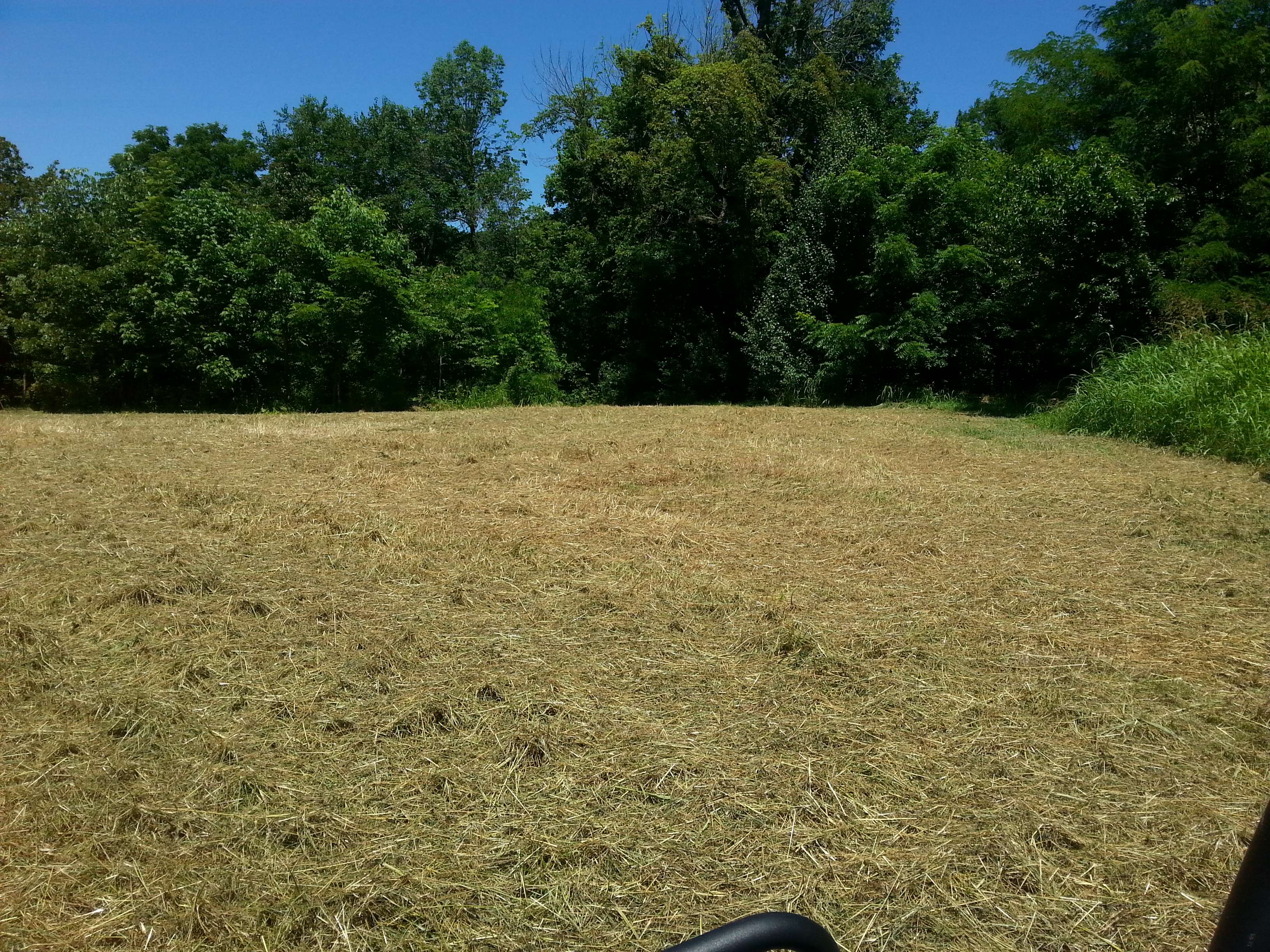

My 25A, as I've mentioned in the past- beat to snot, bent knives, twisted hood, knives are dull and old. To the right you can see what this field started as. I'd say that's a pretty good cut on tall field grass and light brush.

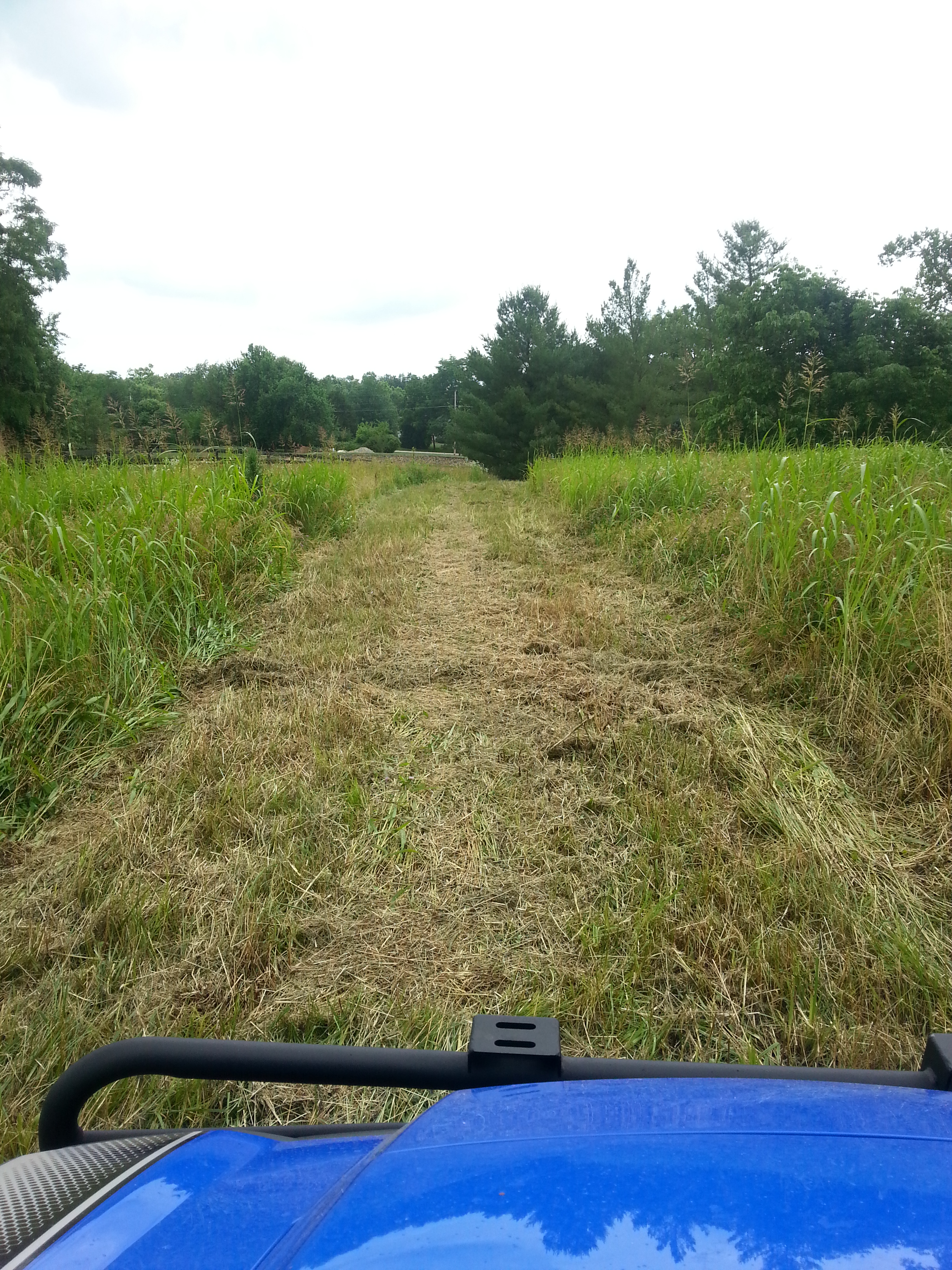

Before
After mowing with my JD 25A

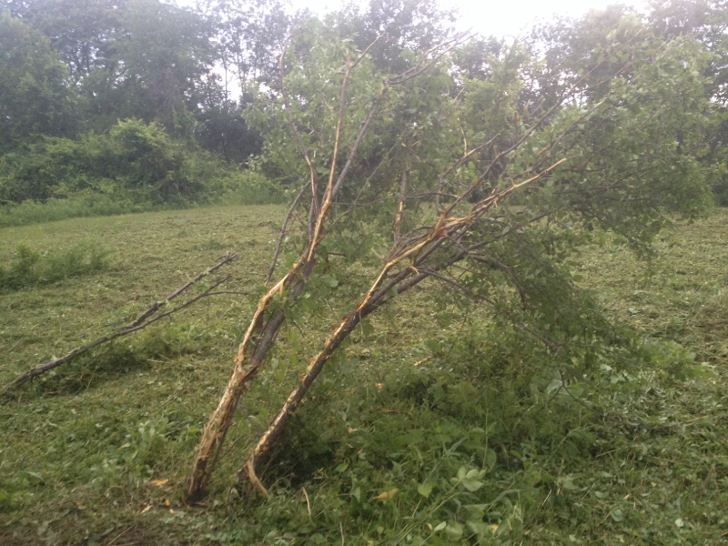

I've got scoop knives, so shredding the thick stuff takes some effort. Here's what it looks like when I hit a 2" sapling in 2nd gear low, PTO speed.
Mind you, my knives are pretty much shot, and I literally just ran it over once and kept going (actually to show Ribz what it'll do in one pass) Unusually it'll shred the branches off better. This sucker was quite springy.
If you look behind it to the left, you can see one I hit last year, probably 1.5". Shredded it bare, but left the main stalk.

I have the heavy forged duck foot knives on mine. The back it down then pull forward method would have turned it to mulch.
If your knives are shot then that's probably all you can expect.

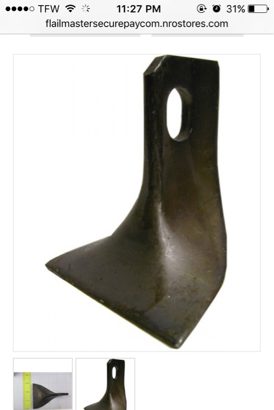

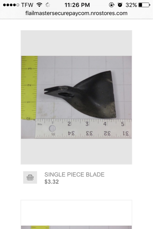

I don't expect much from them, but I'm waiting to replace all the knives so that I don't destroy the new ones on stones and the like. By end of this summer or next spring I'll replace them.
Here's the style knives that are on the 25A. I'd love some hammer knives:
