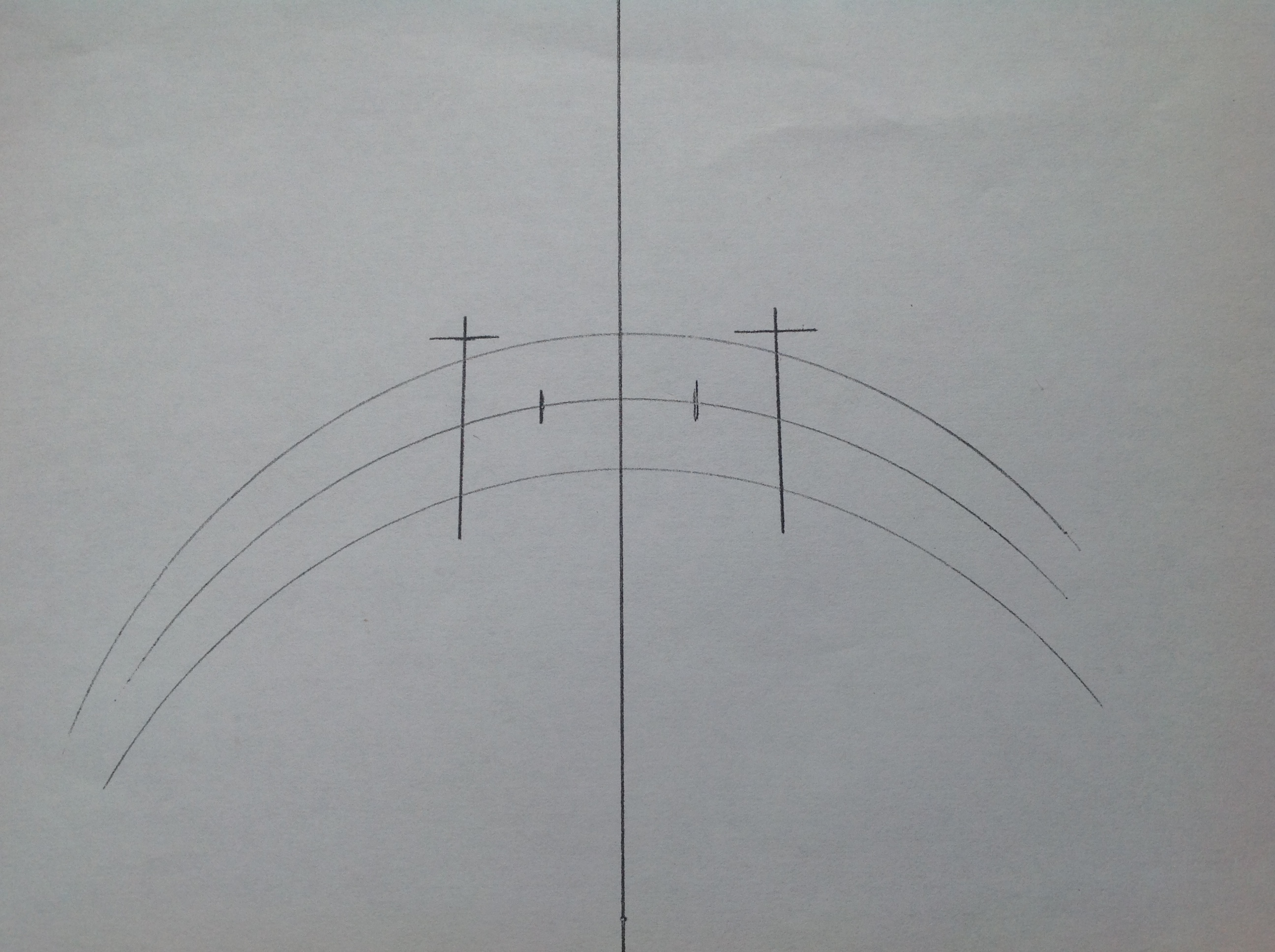

Update: Bush Hog FM188 or Ford 917 vibration problem, adjustable balance weights missing and no longer available for purchase.
I drew out the weights to scale and ordered a 1-1/2 x 1' piece of cold rolled.
I drilled two holes and used a 7" grinding wheel to make the radius, the weights needed to weight .88 pounds per the print, but they weighed less than that after drilling the holes and making the radius, so I did not bother machining the outside corners.
I gave it a spin using the old blades and she ran as smooth as can be, no vibration. I ordered all new hardware from Flail-master and tried out the two piece ruff cut blades for field mowing, they cut fine except for the very fine grass, it just laid it over. The manual said the standard cut blade would also create a suction and lift the grass and from what I experienced, that is true, if you really don't have thick brush I would stick with the paddle blades.
The original correct hardware was longer and extended past the side skids and I did not care for that because I feel the side skids will protect the blades from hitting the dirt, I could be wrong, but I made new skids anyway. As you can see the previous owner made new skids because most likely they were rusted out. Anyway all worked out ok and I now have a flail mower I can use.
