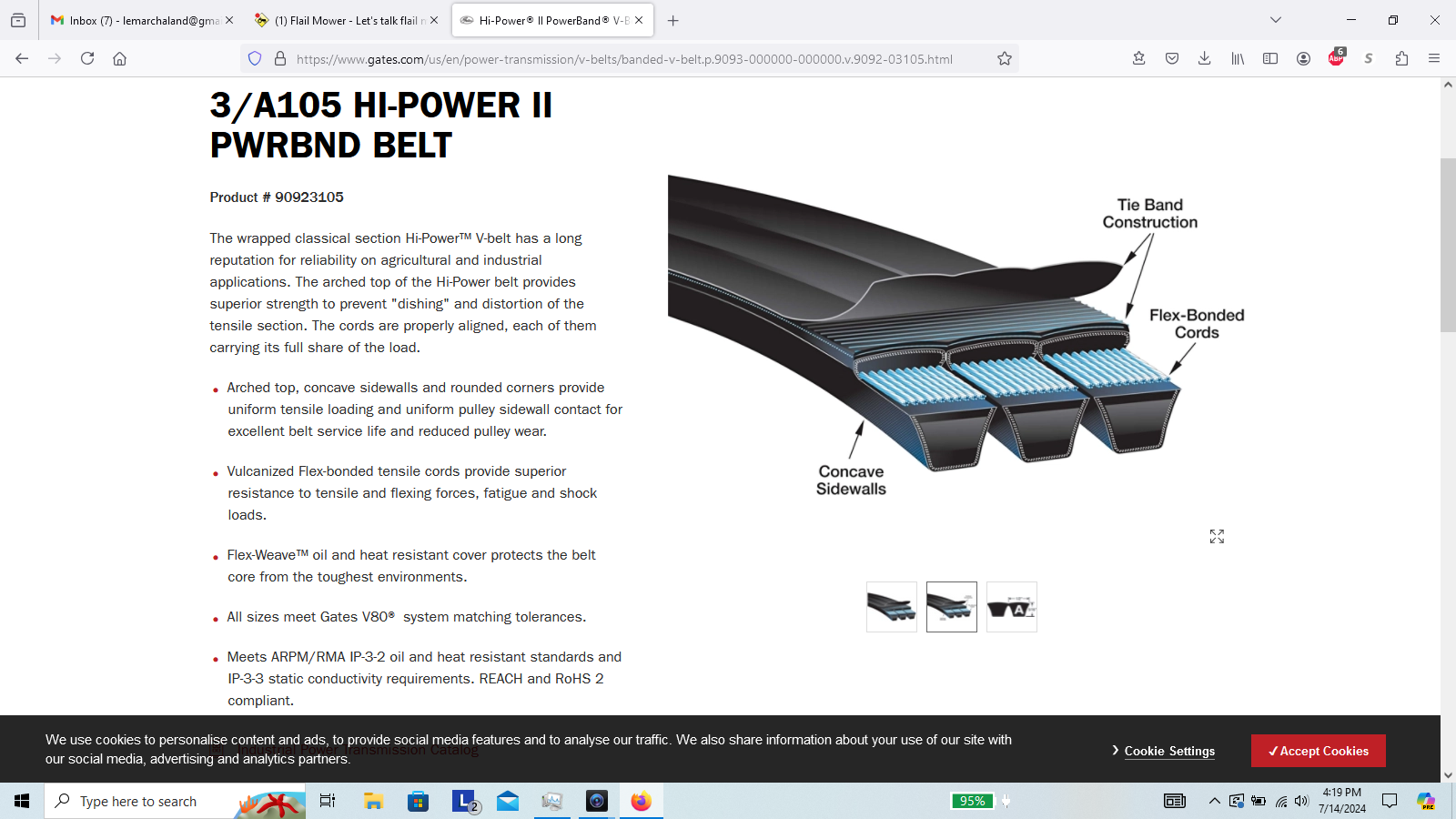

A V belt has gone bad if it smells burned and the V belt has a glazed look and or the V belt has cracks or the rubber crumbles off in your hands.
Over time you will have rubber dust inside the V belt guard so that is not a real concern but checking the V belts once a month for wear and tension is a good idea.
Buying V belts is a personal choice, whether you by them from Vrisimo or the local farm store-read below-
You need to make sure that you have two "B42" V belts with identical lot numbers with Kevlar webbing which is more resistant to shock loading. My own preference is for either Goodyear or Gates Rubber Company V belts.
You have no way of knowing who Tractor Supply, NAPA, Farm and Fleet or Menards buys thier V belts from or whether they know that V belt pulleys with 2 or more grooves MUST have V belts with the same lot numbers as a V belt with a different lot number will stretch more under load.
I went through this with NAPA trying to buy snowblower belts for my JD snow blower that was equipped with metric v belts and pulleys, I am glad that thing went to the scrapper.
I have a motorized Mathews Company lawn Genie Pick Up Mower for my use and my father had a 7 foot JD 25A finish mower for his 12 acres of pasture.
When I use my flail mower I grease it after I mow and in so doing I remove the V belt guard and check the V belt and grease the flail mower rotor roller bearing on that side more easily. I have a spring tensioned idler pulley on my flail mower.
YOU MUST buy V belts in pairs; The 2 V belts MUST have the same lot number which is the number that is melted in the rubber carcass. If you decide to have spare V belts on hand put them in a black garbage bag, seal it and place the bag away from sunlight.

A couple of questions about belts on my Caroni TM1900 72ā€ flail:
What should the belt tension be? I am looking at buying the Gates tension gauge but the Caroni’s manual doesn’t specify.
Where do you shop for same lot or ā€˜matched’ belts?
Thanks
