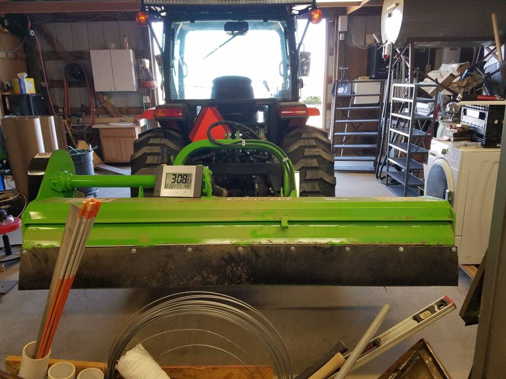

Mows fine like this, but picking it up shifted like this is sketchy. To much flex on the flail frame & 3pt for me to feel safe about things not breaking. With a 72" track the tractor itself is reasonably sable with things side shifted, but not great. Due to the 3pt flex I never really tested the actual stability for more than a few yards though.

That's shifted? Now I have to take a picture of mine. I was planning to take it out this morning anyway. Iirc, mine goes further right. It might just be perspective, though.
/ Let's talk flail mowers #7,996
I could go an inch or 2 more to the right. The cylinder runs out of stroke & the PTO shaft would hit the shift hose. A mark or 2 on the hose when I didny have the banjo fitting rotated fully away from the PTO. Fixed now, but I still try to leave it a few inches from testing that it hasnt rotated into a clearance issue again.

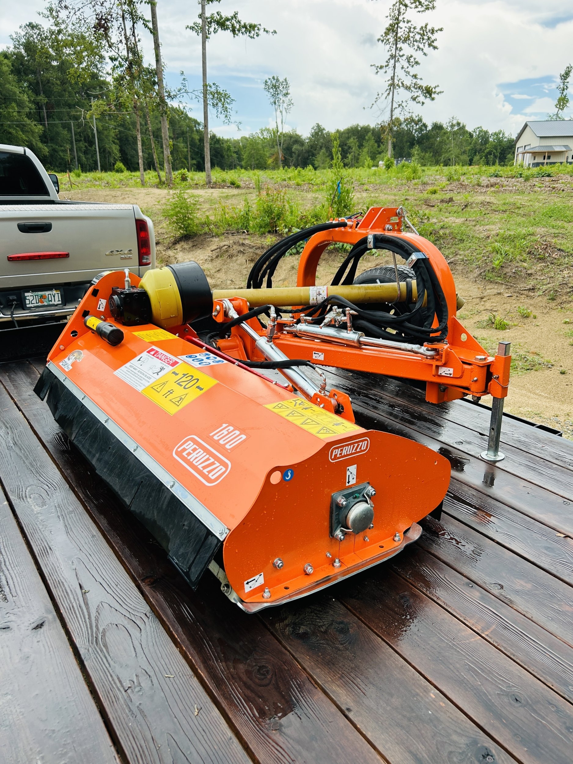

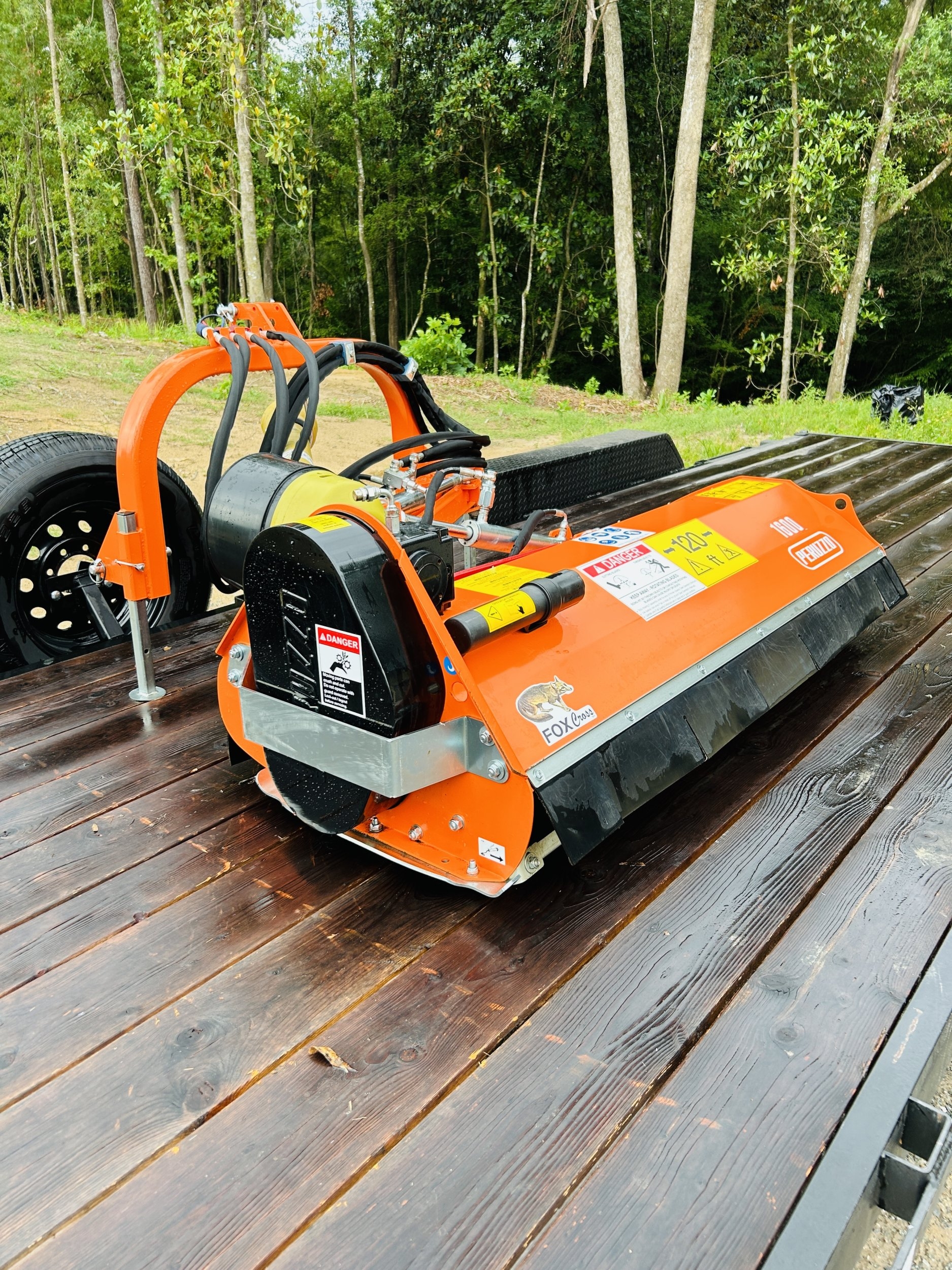

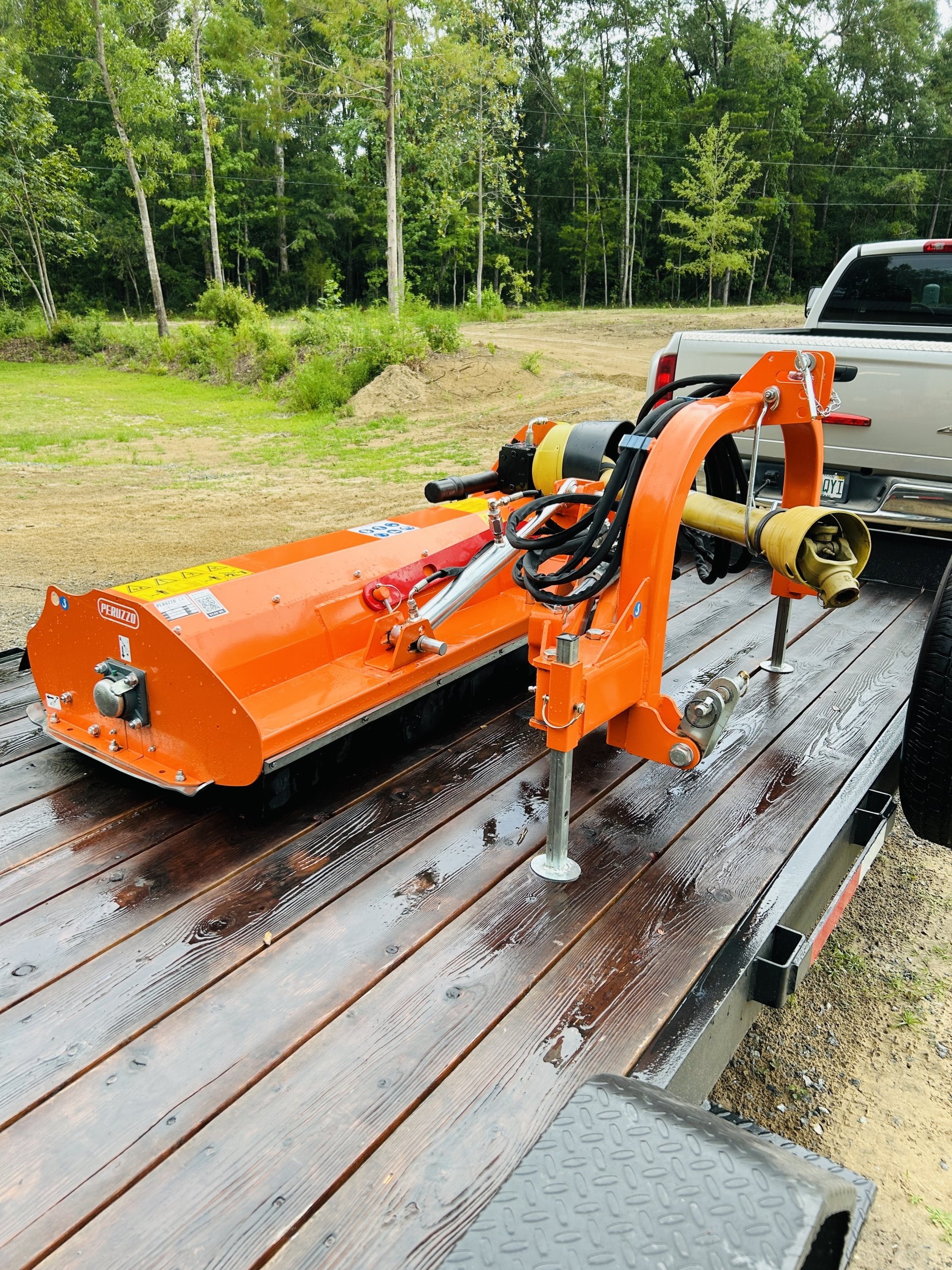

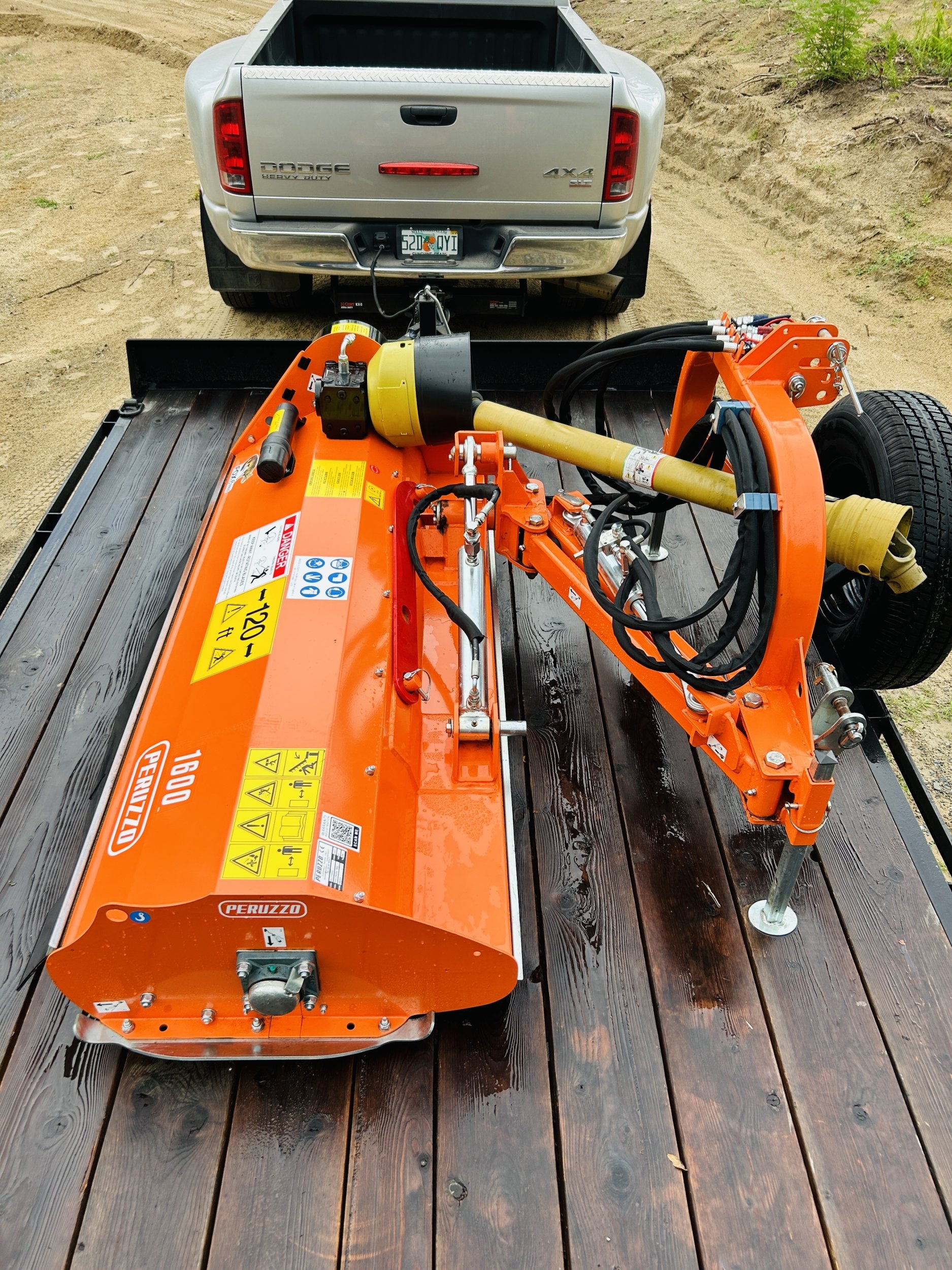

Found this 10 month old Peruzzo Fox Cross 1600 on marketplace a few days ago. Reached out to the seller to see what the story was. Apparently he ran it for two passes around his pond and decided he wasn’t comfortable being that close to the bank due to how steep it was. It’s been parked in the bushes ever since.
Drove an hour to take a look at it. As soon as I saw it I made him an offer and he accepted. Other than a couple of small paint scuffs it’s a brand new mower. Hammers look perfect.
I’ll have to wait a bit before I’ll be able to run it. I need to get the rear hydraulics on order from Yanmar and get them installed but I’m happy to have it nonetheless. Between this and the Land Pride FDR3690 then I just picked up I should be able to handle everything around this property.
