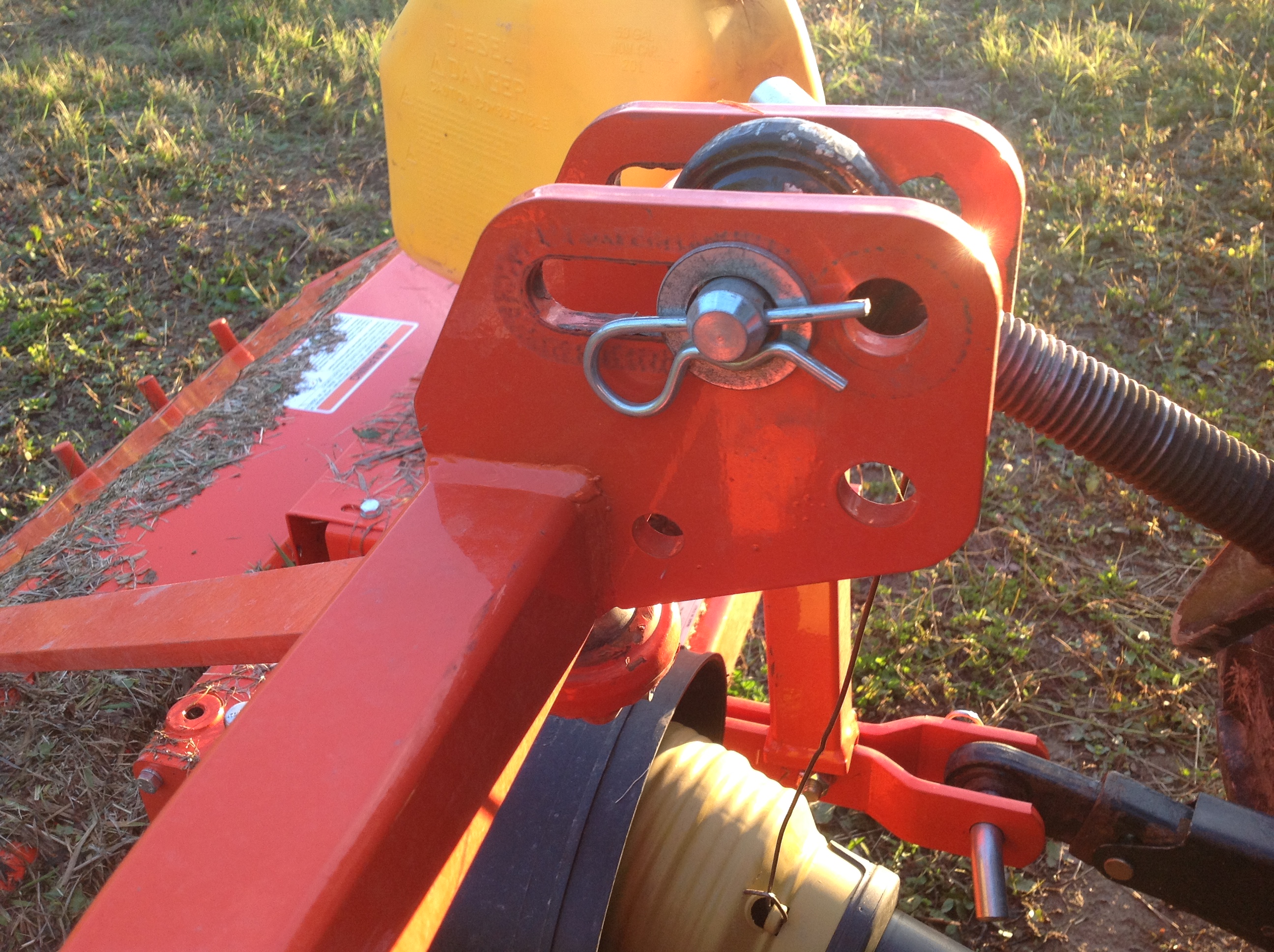

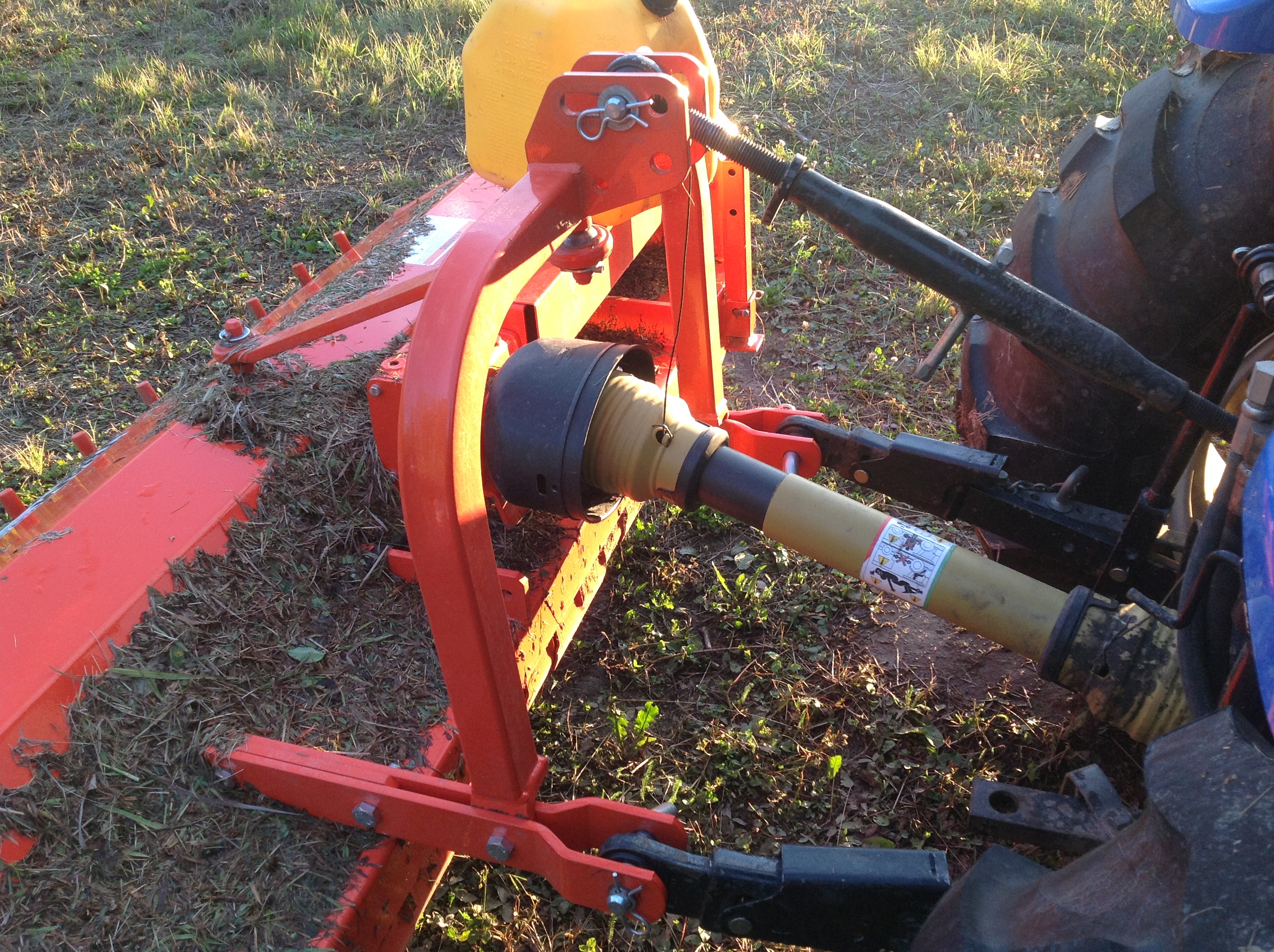

I'm curious about the proper 3 point hitch set up. As you can see in the photo there is a slot that I'm currently using and holes for I'm assuming if you want the mower to be more rigid. Anyone have some insight on this. The 40 acres I'm mowing is by no definition smooth. I'm thinking it was ploughed or disced maybe 20 or 30 years ago and then allowed to grow in. image.jpegimage.jpeg

Your setup is basically correct. Ideally the topping lift would be adjusted so on flat ground the pin was centered on the slot.
Also, you have the mower set with no offset which is fine for field mowing but it looks like the mower has fittings to allow offset to the right which is sometimes helpful to mow closer to obstructions.like trees.

I hope you found the shredder bars that decided to jump ship. If you want you can always use roll pins to lock them in place at thier current setting and they will not jump ship on you.
I am unsure how much a box of roll pins that size-1/8"? maybe would cost to buy but they would eliminate the loss of cotter pins and shredder bars from falling away while mowing.

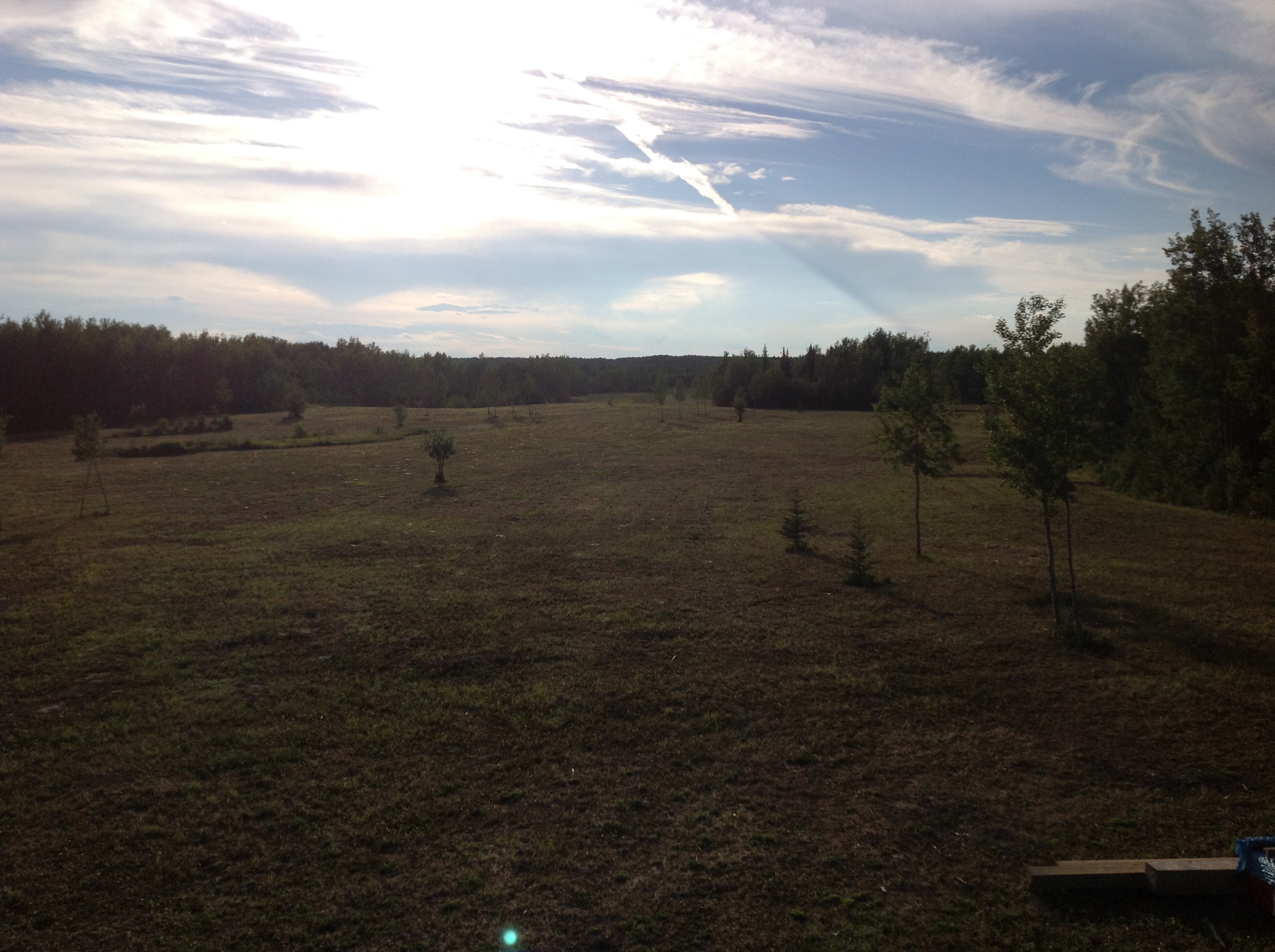

I still have one bar missing in action. I resorted to some bent nails over the cotter pins because I had nothing else with me this weekend. Here's a pic of the field I just finished. image.jpeg

MMM, MMMM, MMMM, I love it when a plan comes
together and you have a good flail mower to use
you can forget about having to deal with any invasive's
as long as you keep the sod that low.
Be sure to mow lower at the end of the season if you
want to broadcast grass seed.

What was your estimated time doing a field of that size?
The first time I used my flail mower I couldnt believe how relaxing it was. Nothing but me, a few birds flying around the tractor and 20 thousand bugs jumping on me from all the 4-5 foot tall grass I was mowing. Took me about 11 hours over the course of 3 days to finish 10ish acres. Now the next time I mow I should be able to cut that time in half i'm guessing since it wont be so tall.
