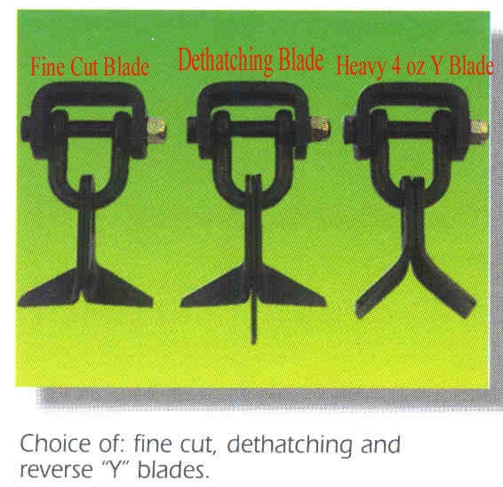

No, the flail mowers run in either counter clockwise rotation if they are front mounted
European models that can be changed by the end user or clockwise if they are rear mounted
and they have doing that for the last fifty years and the thirty plus years I have owned and
operated them.
If your flailmower ROTOR is rotating counterclockwise it is not mowing properly.
If so, somehow that flail mower was set up wrong with the wrong gearbox at
the factory where it was assembled OR the PTO stub on the tractor is
operating in the opposite direction.
Those are the only two available scenarios for this with the basic simple drive mechanisms
that these flail mowers have had for fifty plus years that does not seem possible.
Its either the tractor PTO or the gearbox is set up for reversing.
It would be different if the mowers grass inlet was taller and the side slicers
were more exposed to the brush and grass AS are front mounted flailmowers
that are operated by the connection to the crankshaft flywheel when using a
three point hitch mount for integral implements mounted in the front.
I only want to help you that is why I always, always, always help new owners of
flail mowers so they can have a forever mower and that is something I have always done here.
What type of gearbox does the flail mower have??
common right angle with a one to one ratio or the pancake type/flat with the spiral
bevel and bevel gear to shaft to the V belt pulley?

Many of us with many years of flail mower ownership and knowledge
regarding flail mowers their operation and knife type have tried to help you with this.
This specific flail mower rotors rotation being counterclockwise as you have stated
will affect the quality of cut with the one piece scoop blades which I have gone
into extensive detail on many occasions for owners of flail mowers with the scoop
one piece knives.
the scoop knives counterclockwise rotation has the cutting edge coming behind the material
the flail mower user wishes to cut down and the the material will flood the front of the flail
mowers shroud when the portion of it that is cut is carried over the flail mower rotor and
will not be recut.
scoop knives do not recut material they cut and carry it over the flail mower rotor and anything
left in its path is dimply carried over again and dropped on the ground.
If you visit the Hiniker home page and look at the flail shredders with the scoop knive option it explains it very well.
The number of times a plot or area is cut will also affect how the flail mower with the scoop
knive will cut the grass or brush and the quality of finish.
