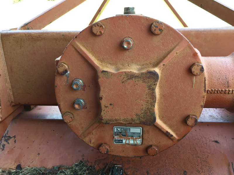

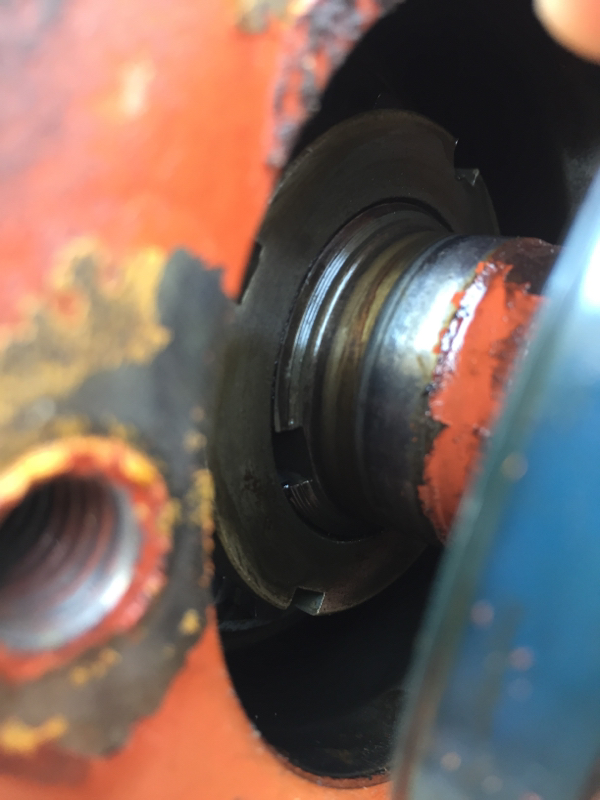

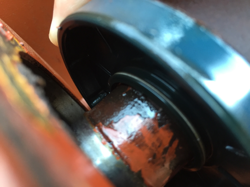

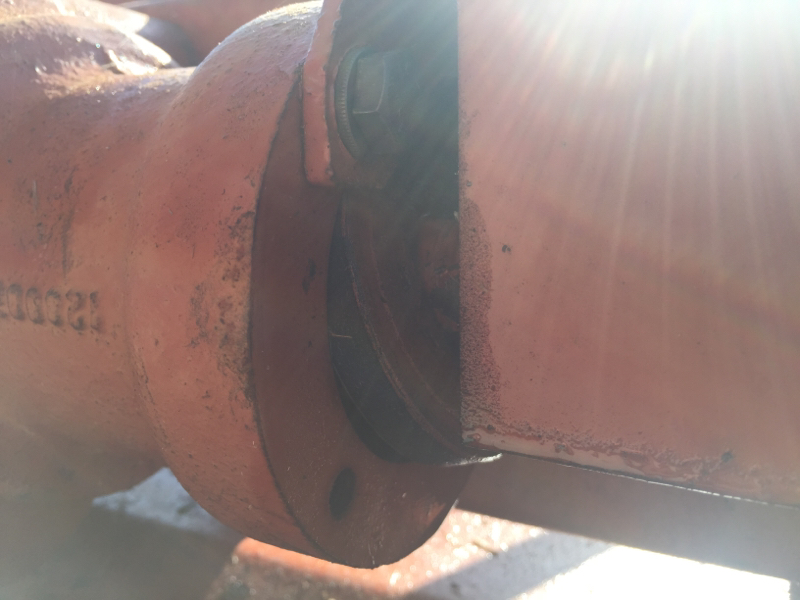

Ok, need some advice! I was flailing around yesterday and started smelling something funny so I stopped and walked around the tractor. All of my gear box oil was spewed out all over the top of the mower. The plastic/rubber ring seal has come off the side of the gear box where the output shaft goes to the pulleys and let all the oil out. I dont think it ran long enough to hurt anything because there was still oil coming out of it when I discovered the problem. Can I seat it back and fill it with the right oil and go on flailing around? Or should I be worried about it more than that? The shaft the goes from the gear box to the pulleys does not vibrate so Im not sure why the seal worked its way out? Ill try to upload a pic of it. image-3249218741.jpg image-1279353071.jpg
/ Let's talk flail mowers #2,303
Ok, need some advice! I was flailing around yesterday and started smelling something funny so I stopped and walked around the tractor. All of my gear box oil was spewed out all over the top of the mower. The metal ring seal has come off the side of the gear box where the output shaft goes to the pulleys and let all the oil out. I dont think it ran long enough to hurt anything because there was still oil coming out of it when I discovered the problem. Can I seat it back and fill it with the right oil and go on flailing around? Or should I be worried about it more than that? The shaft the goes from the gear box to the pulleys does not vibrate so Im not sure why the seal worked its way out? Ill try to upload a pic of it.
UGGGGGGGGGGGGGGGGGGGHHHHHHHHHHHHHHHHHHHHHHHHHH!!!!!!!!!!!!!!!!!!!!!!!!!!!!!!!!!!!!!!!!!!!!!!!!!!!!!!!!!!!!!!!!!!
Sadly you are now the victim of sealus roundus escapus drainus oilus gearboxus;
from which there is no quick and dead repair fix
NOW I will assume you did not overfill the gearbox if it is not vented from what I remember of your flail mower.
My dear friend you have work to do to repair this flail mower
You have one bad seal, plan on replacing them both in order to maintain sanity.
I will add more via editing as soon as I post this.
OK before I change into surgical scrubs, sterilize my hands and upper arms with soapy water and bleach and put on two pairs of disposable gloves there are issues that should be looked at.
1. your having fun and seat time with your mule and your mounted implement
2. buying a replacement gearbox will get you back to mowing much sooner than buying replacement parts for the gearbox-to explain further; when you lose a seal like this it can turn butts ugly and you could be a victim of a cascade failure like the NY power grid did due to a limb clipping a high voltage line in 1994-5.
3. when you lose seal retainer its a good indication of either a bearing failing allowing the yokes orbit to increase and place pressure on the seal and then the retainer and vibration simply took its toll and the seal retainer just fell out with the seal-not likely unless the bearings have ground up and are no longer useable.
Or the gearbox was overfull an either way you need to remove the guards and replace both the seal an the seal retainer and hope for the best.
the only way to tell if the bearings are good is to pull up on the shaft and alos try to move it sideways and see how much play there is if any.
When you have a seal and the seal retainer pop out the worst outcome can be expected or has occured.
I would see how much a new gearbox costs from flailmaster and others and then check the various JD parts supply houses on the internet for their prices before you proceed as spare parts are not very cost effective when rebuilding some gearboxes especially small ones like these as they normally o no have stacked roller bearings to support the input and output shafts.

Short answer. Drive the seal back in, refill gearbox, flail away. Watching and checking periodically of course. I've had a couple seals do that on gearboxes. Both times I reused the seal and in fact, am still using them years later.
If by chance the seal doesn't fit the hole tight enough to stay you might have to adjust the seal outer edge slightly with pliers for tighter fit.

Where is the flange that holds the seal in place?
This gearbox does not appear to have a separate
seal retainer flange inside the bore of the gearbox..
Seal retainers containing the seal are typically pushed into
place with seal drivers or screwed into place with seal retainer wrenches
which are also used on hydraulic cylinder packing glandsthat are adjustable
to take up wear on the stuffing box packing material.
A seal driver can be made from a piece of PVC pipe sized to the outer diameter of the seal assembly.

Thanks for the input. Ugh. Dont want to replace the whole gear box. Im thinking there was too much oil in there and after heating up it had no where to expand. My fault for not checking it at the proper level after buying it from the last guy. Should there be a vent plug on the top? There was only a bracket holding the very top of the seal in, hence why in the first pic the bottom was pushed out. I think ill first try to put it back in and see what happens. There is no play in the shaft up or down or side to side so hopefully its ok. Which plug should i check the oil level to and how much approx should it hold? And 80w-90 should be the right oil right? image-1021177049.jpg image-2877024508.jpg

Thanks for the input. Ugh. Dont want to replace the whole gear box. Im thinking there was too much oil in there and after heating up it had no where to expand. My fault for not checking it at the proper level after buying it from the last guy. Should there be a vent plug on the top? There was only a bracket holding the very top of the seal in, hence why in the first pic the bottom was pushed out. I think ill first try to put it back in and see what happens. There is no play in the shaft up or down or side to side so hopefully its ok. Which plug should i check the oil level to and how much approx should it hold? And 80w-90 should be the right oil right? View attachment 437939 View attachment 437940
splash lubrication gearbox:
no vent needed as long as it is not overfilled(oil barely dripping out of the level hole.
The oil level plug is the pipe plug that is directly at the twelve oclock position when looking at the rear of the gearbox and it is in line with the filler plug and just below the bolts holding the rear access plate at the ten oclock and two oclock position.
as far as oil goes, try to buy a quart squirt bottle of 90 weight with the tapered spout.
Kendal oil is one brand that did have them or still does in that small a package bottle

Yep - drive the seal back in and refill as Ovrszd says and just keep an eye on it. No need to panic at this point. I would guess it was overfilled a bit and the heat of running it caused it to push out. Not really unusual or anything to worry about.

Yep - drive the seal back in and refill as Ovrszd says and just keep an eye on it. No need to panic at this point. I would guess it was overfilled a bit and the heat of running it caused it to push out. Not really unusual or anything to worry about. Good luck
thanks! Im going to give it a whirl!
