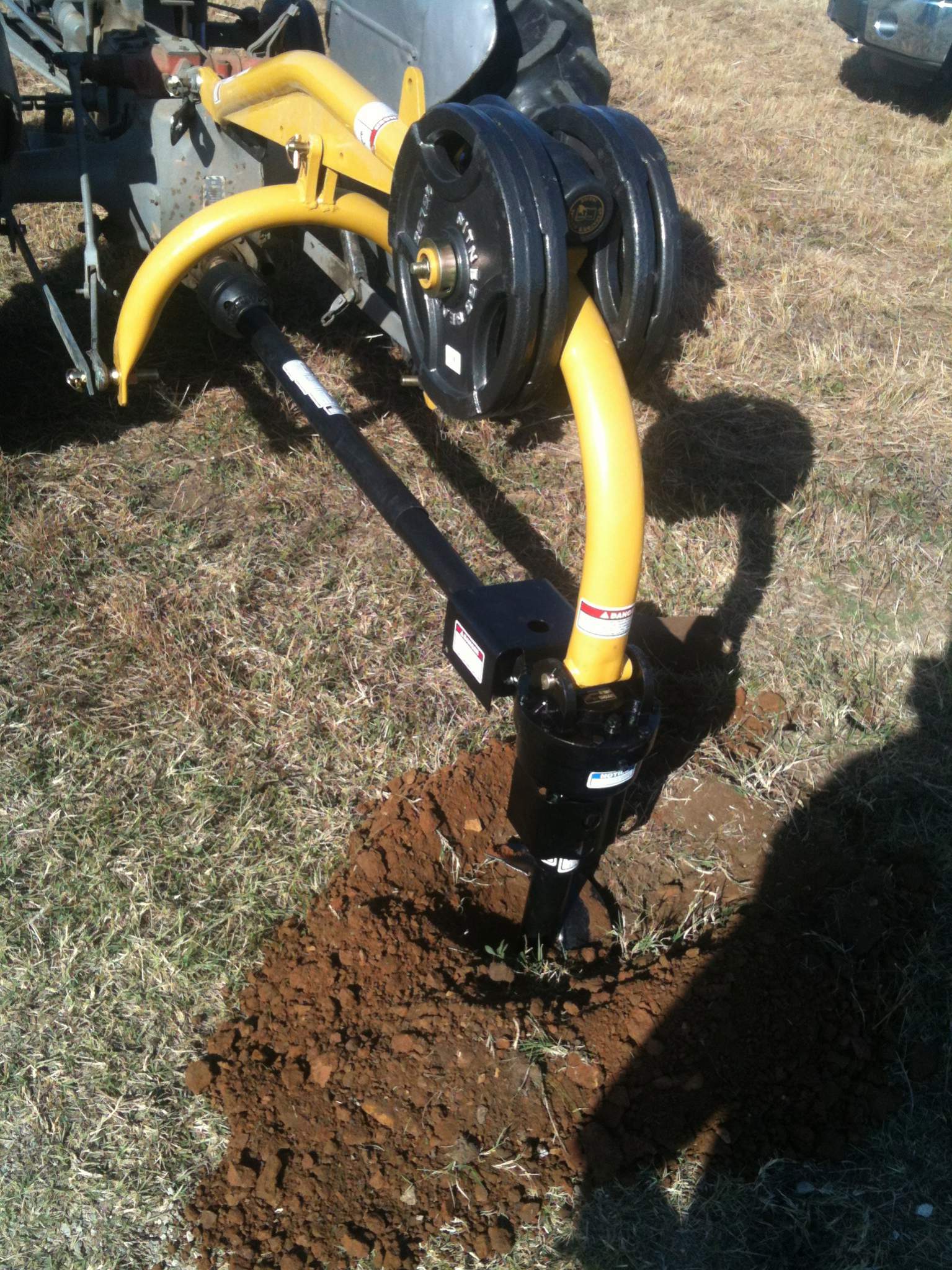

I forgot all about this thread.
I did end up finding a box blade, but I've been awful slow at getting it modified.
Then I had a moment of inspiration and hit craigslist for some used weight sets.
$80 later, and I have ~240 lbs added to my box blade. The difference in counter weight is huge!
The weights don't move around at all, and I can fairly easily get them rolled in and out of there by myself if need be.
Now I just need to bolt on some angle-iron and a trailer receiver so I can pull a trailer around, too.
/ Let's see your modified box blades! #47

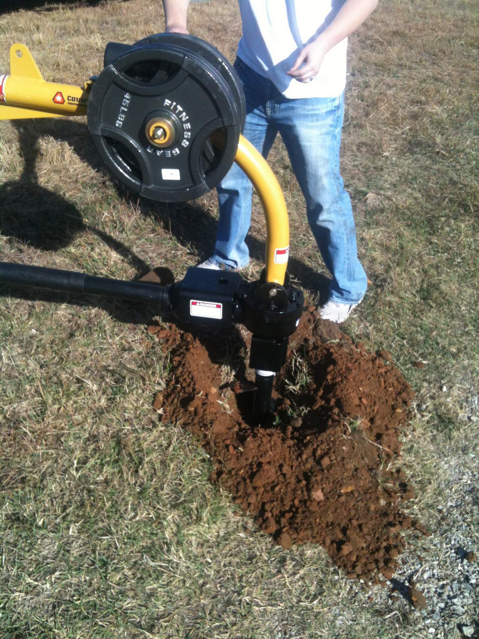

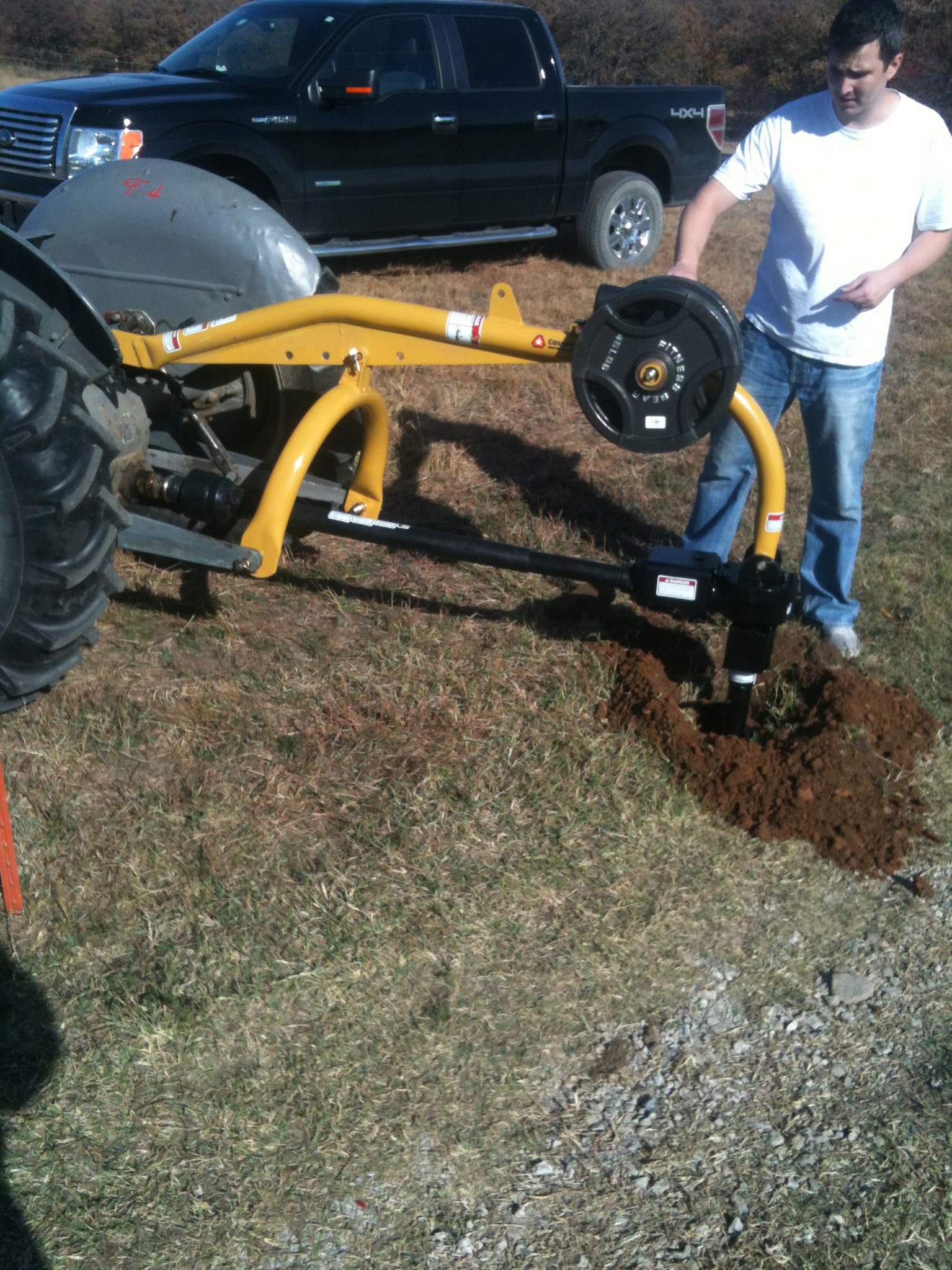

Deezler, Those weights may also come in handy with your post hole digger. Our soil is rocky and in the summer when it is very hard and dry I use 180-lbs of weights and it really helps the auger get a bite and dig.

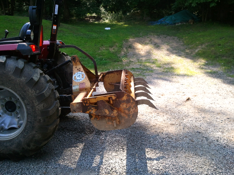

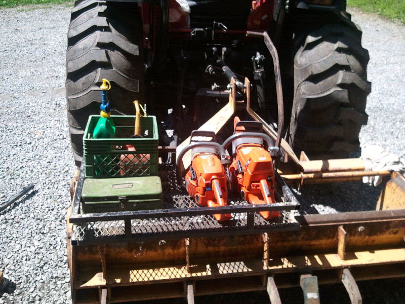

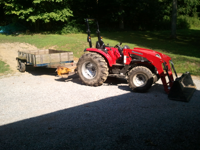

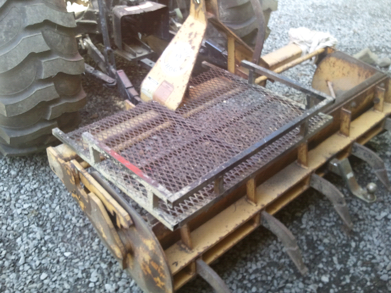

Heres mine. Added about five hundred pounds. Works much better now!
