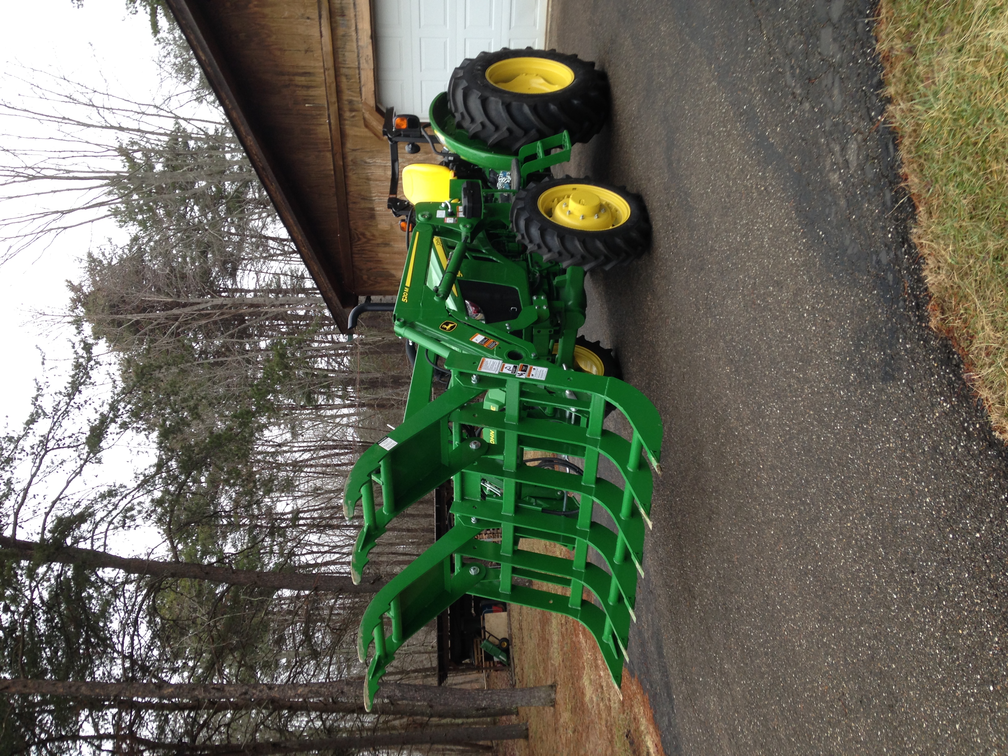

John Deere 5065, with the grapple on, and the ballast block, the back still can get a little light if lifting a full load in the grapple. The grapple it痴 self is just under 1000 lbs.2BFC7CAC-BF7C-4565-A181-83E52389F5E2.jpeg

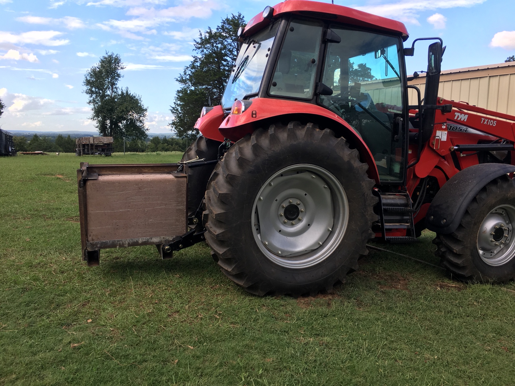

Here ya go. 1600+ pounds
Hi Lynn
Very neat.
Would you mind sharing the dimensions of the block? Also, the distance of the lower holes from ground level and the perpendicular distance between the upper and lower holes.
Thanks
Ken

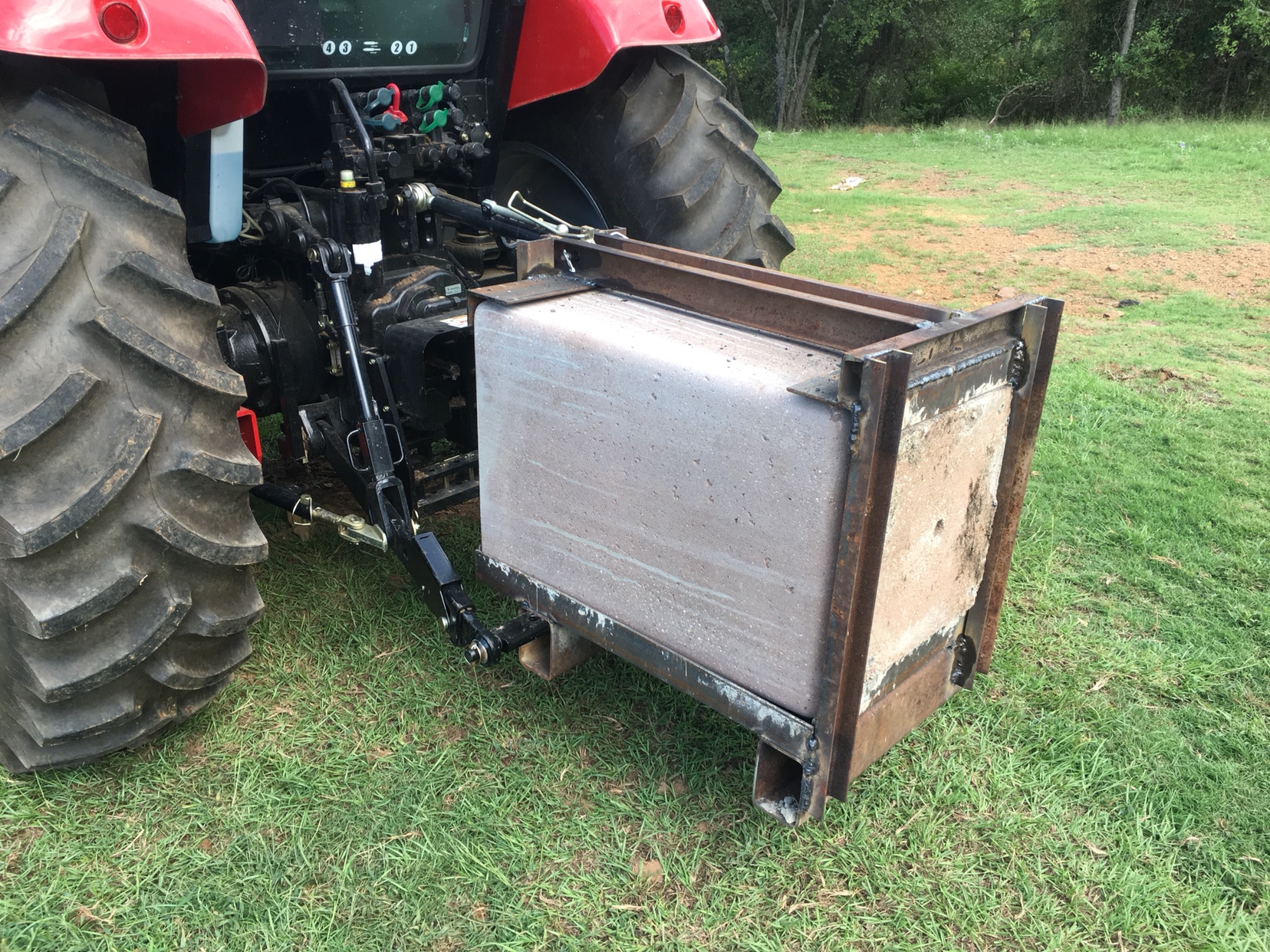

Thanks Ken,
It's a total of 10 cubic feet. 24" square X 30" tall. The distance from lower links to upper link is 24".
Here's what it looks like inside. I did add a couple pieces of rebar not shown.
Thanks, Lynn
Seeing the inside is valuable info.
How far from the bottom (ground level) are the lower link holes?
Cheers
Ken
   / Let's see some homemade 3 point ballast! #28
Without measuring I think about 5-6". I made it so the lower links could be all the way down and leave the bottom of the ballast box 3-4" off the ground. Making a very low center of gravity. Works great on level ground, not so much on anything else, but then I just raise the 3 point a little.
When I take it off the tractor I have to put it on 6" pieces of wood because the lower link connections are so low. (on purpose)
