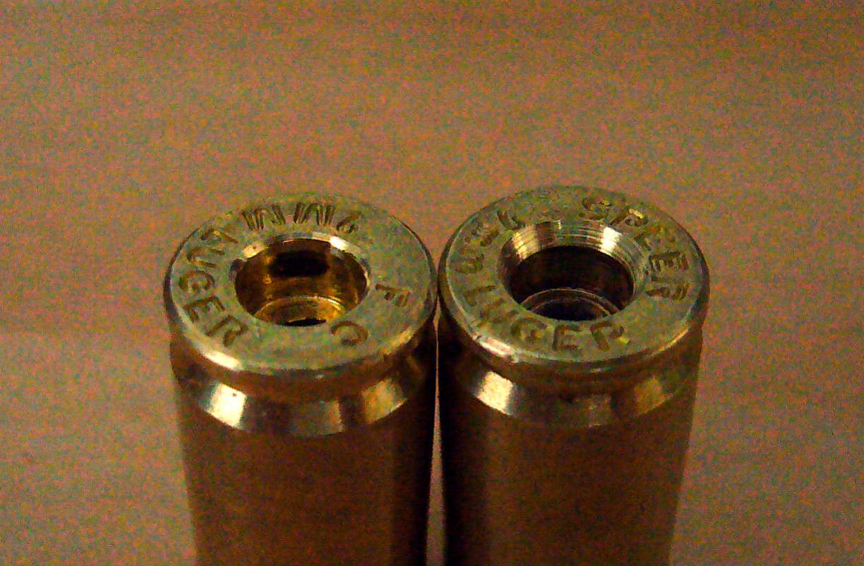

The cutters both seem to be doing the right thing for mil crimps, but IMO one a bit much and one barely enough. For many, 'loose pockets' are grounds for immediate discard of a case. (In ARs losing one into the action is a bear.)
I wouldn't expect cases trimmed with the Lyman tool shown to hold primers to my stds for other than bolt guns. (.. would set that one aside for now) I've seen/felt/measured seating pressure avg ~1/2 the norm in once-fired 5.56s with such a deep chamfer and prefer swaging vs reaming much for that reason. YMMV btw: overly deep pockets/seating can cause light primer strikes, a whole 'nother issue.
Have yet to see a pocket swaging tool I didn't like, whether bench-mount or press model. Sometimes a sharp edge stands out a bit after swaging, but it's easily cleaned up with the gentlest bump from any chamfering tool just as a neck would be.
only thing i can think of is lyman changed their tool.
the lyman primer pocket reamer i have uses an inverted square shoulder and does not leave a v-cut profile like either of the pictures.
the pic on the left i'd use.. the on eon the right looks like someone took a countersink bit to. I see lots of reloaders do that. too cheap to buy a 5$ proper crimp reamer that bottoms, and instead buy a screw head countersing with a wide taper and 'hit the crimp' with it. that's really what that right pic looks like.
can someone post a pic of what lyman is NOW selling as their crimp remover? evidentally they have changed the tool sinc i picked up mine.
   / Lets Reload some Ammo! #63
It does bottom but removes quite a bit of brass even from non-crimped brass. Not the best picture but you can see the difference. The one on the left was trimmed with the RCBS Military Crimp Remover and the one on the right was with the Lyman tool. Neither were crimped brass. Maybe it is just me but it seems the less brass removed the better.
wow.. no way my luman tool would or could do that. can you post a pic of your tool? i'm betting / guessing that lyman has changed the cut profile of the tool since i bought mine.
   / Lets Reload some Ammo! #64
Yeah, I would not be satisfied with the one on the right either.. seems the shank is a bit too short and allows it to go to far.
yep.. that looks way wrong... i'd like to see a pic of the tool that made that. I can run my cases onthe crimp remover and hold there till my hand is tired and once bottomed.. there is no more cutting.
either the shank is short.. or the primer pocket is too deep.. or it's a combo tool with a pp true end mill on it and was cutting deeper intothe pocket.. or they have added a wide angle taper cutting edge to ther new tools.
i would not run the one on the right either.

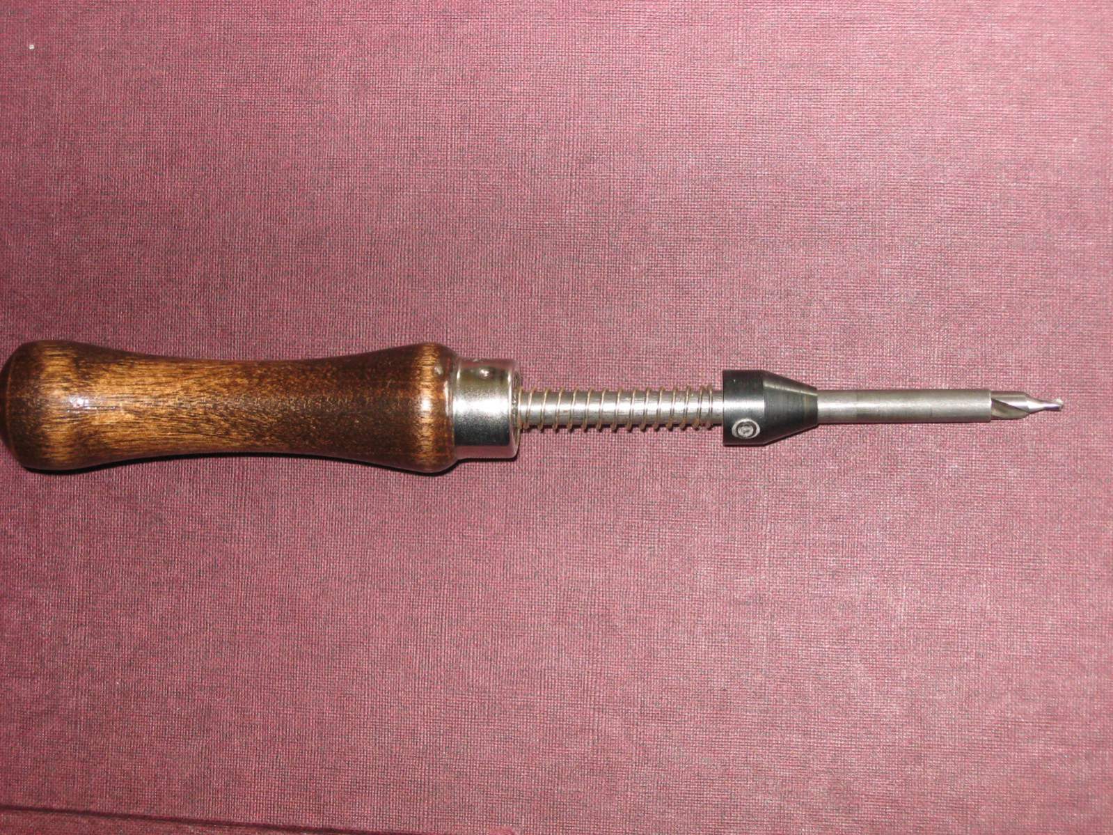

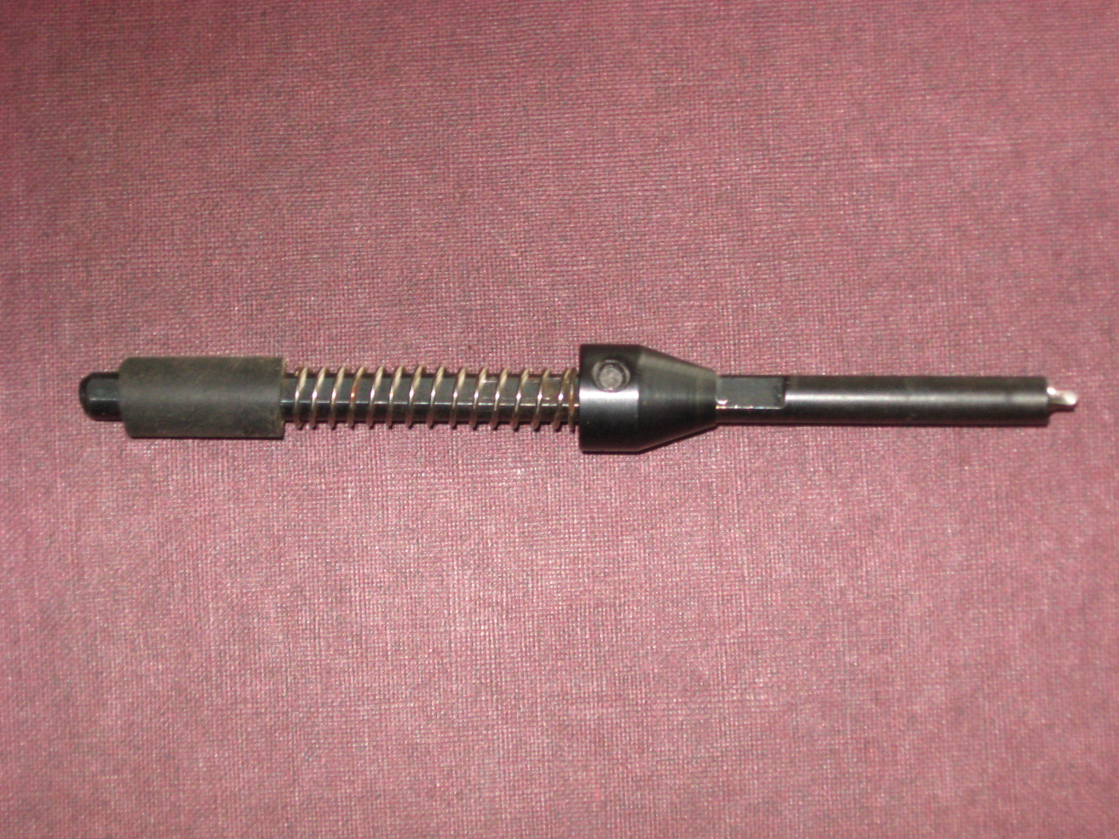

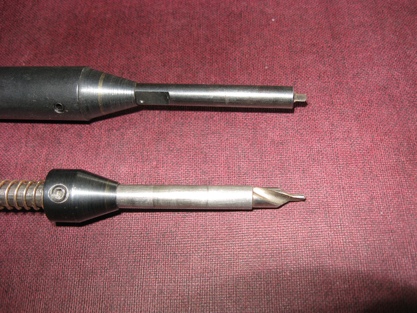

Want to be sure we distinguish between a mil crimp remover and a pocket uniformer. Different purposes and different 'cutting' profiles.
Not to go OT, but this reminds me of flash-hole deburring tools. My Lyman required careful setting of the guide or just the right feel to not cut too deep. Possum Hollow's version has a collar to limit depth/chamfer. I combined pieces from the two and came up with this: (right)
The PH cutter's collar limits depth of cut, the spring centers and allows for different pre-trim length or caliber. (still adjustable tho') 'Handle' is pc of rubber hose and provides enuf leverage for a 'finger-touch' cleanup. I usually inspect f-h's as I debur ... 'er just to get my $$ worth from the Hawkeye. ;)
View attachment 350584View attachment 350585View attachment 350586
