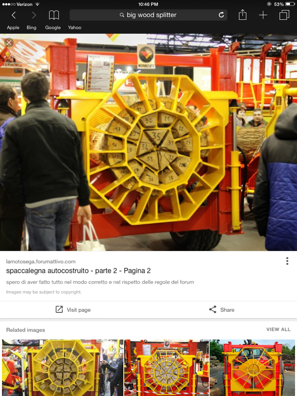

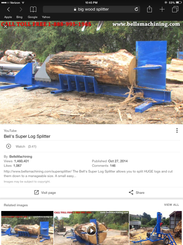

I'd build the wedge like this image-1861611346.jpg Instead of like this image-3695239865.jpg IMO it's far more useful to make a big pile of finished wood in a hurry than to make a big pile of more manageable chunks that requires a second splitter to handle. I also think cycle time is being over hyped. Even at half your specified pump GPM you'd have a slow cycle time, but are doing WAY more splitting per stroke than a regular splitter. This is like comparing a 48" mower at 15 mph or a 20' batwing mower at 3mph to cut a 100 acre field.

I'd build the wedge like this View attachment 505545 Instead of like this View attachment 505546 IMO it's far more useful to make a big pile of finished wood in a hurry than to make a big pile of more manageable chunks that requires a second splitter to handle. I also think cycle time is being over hyped. Even at half your specified pump GPM you'd have a slow cycle time, but are doing WAY more splitting per stroke than a regular splitter. This is like comparing a 48" mower at 15 mph or a 20' batwing mower at 3mph to cut a 100 acre field.
Yea I like the first wedge design, but have it so it can be add on and taken off so the spliter can be used like the second picture if that's possible, maybe just have to settle for a re-cut and running the split pieces threw another spliter.
For me with a 22 ton spliter, those big logs would a lot of, too much work at 16-18" long. If I was buying firewood to cut up and those pre-split pieces at 8' long were cheaper than tree length, I'd try em, might even dry quicker that way, but to me I'm thinking tree length will be easier to work with than splintery pre-split wood.
