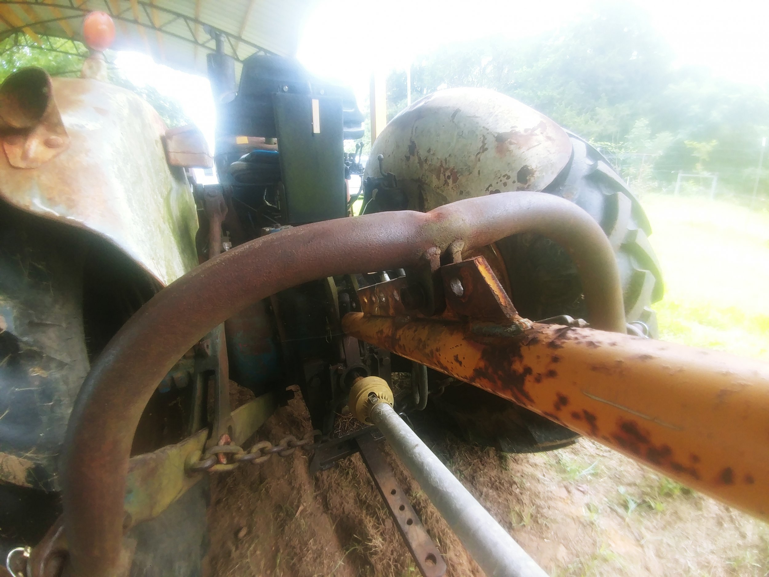

I need a bridge or hoop for my Leinbach auger, purchased in mid 90's. This part connects to the lift arms and mounted to the boom. Everything Attachments does not have one. Used will be okay.
Suggestions greatly appreciated.
This is going to sound strange but here goes.
Purchase a quick hitch Cat 1 Quick Hitch-3-Point Quick Hitch | Agri Supply and weld 2 pieces of angle iron below where the top link would attach. Ignore the quick hitch parts or remove them if they do not work for you.
Check to see if the quick hitch will give you the reach that you need. Check around for cheaper quick hitches as I just used the first picture I found.
