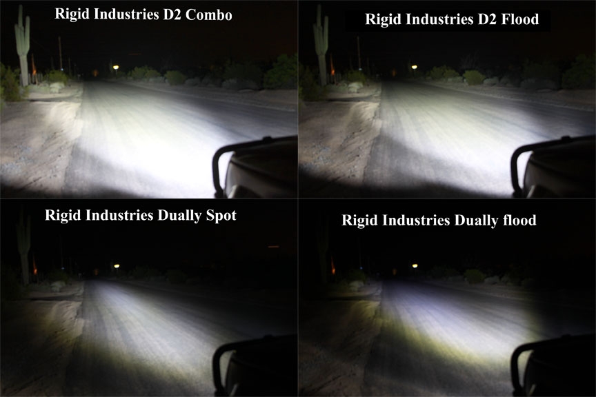

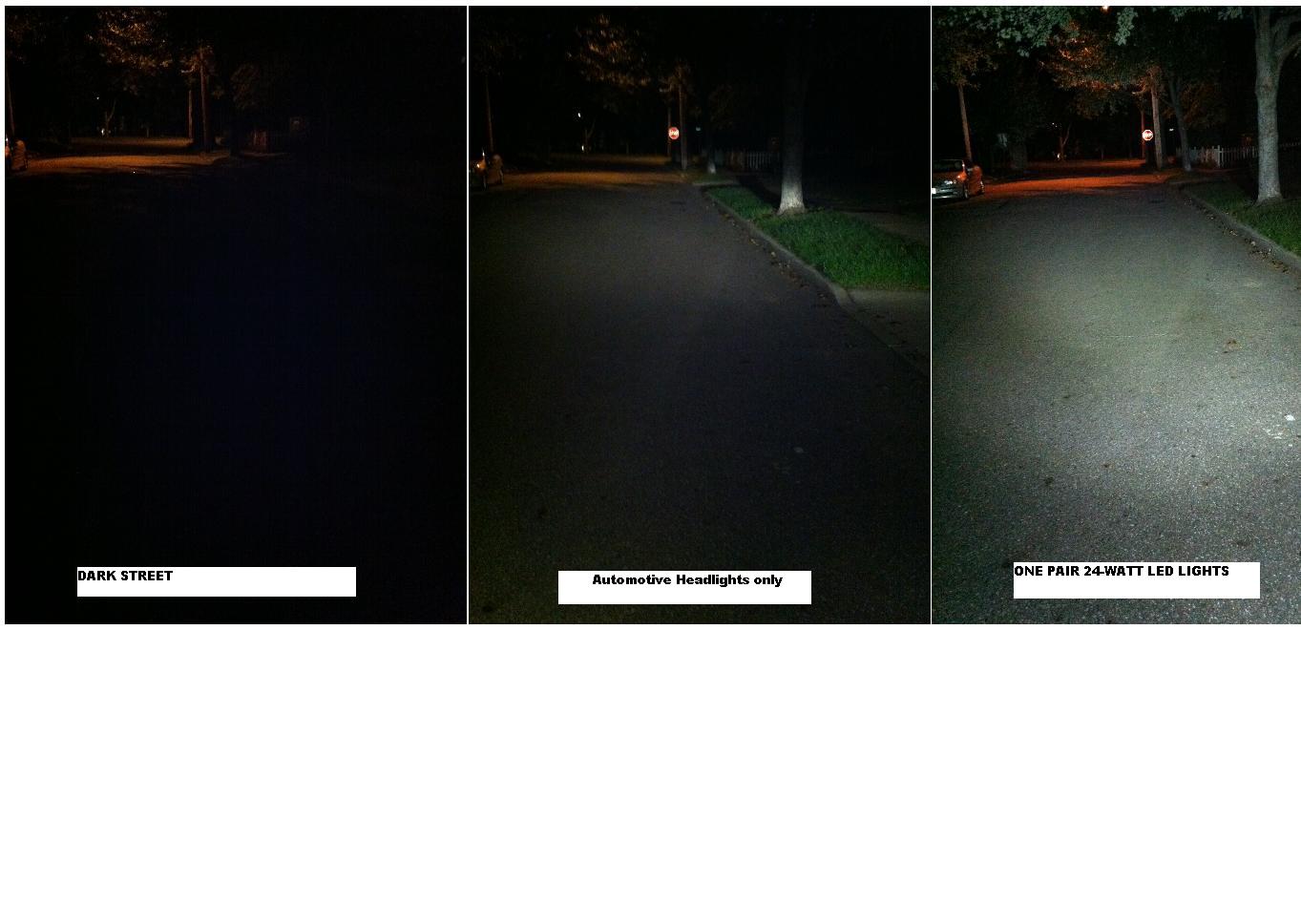

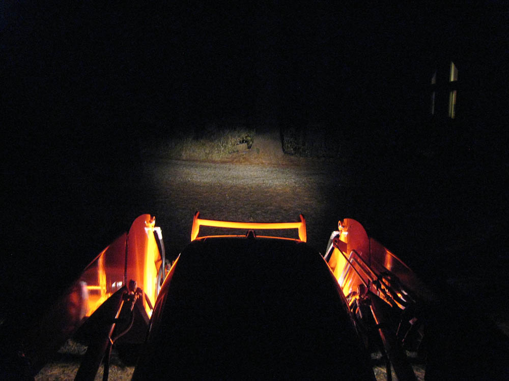

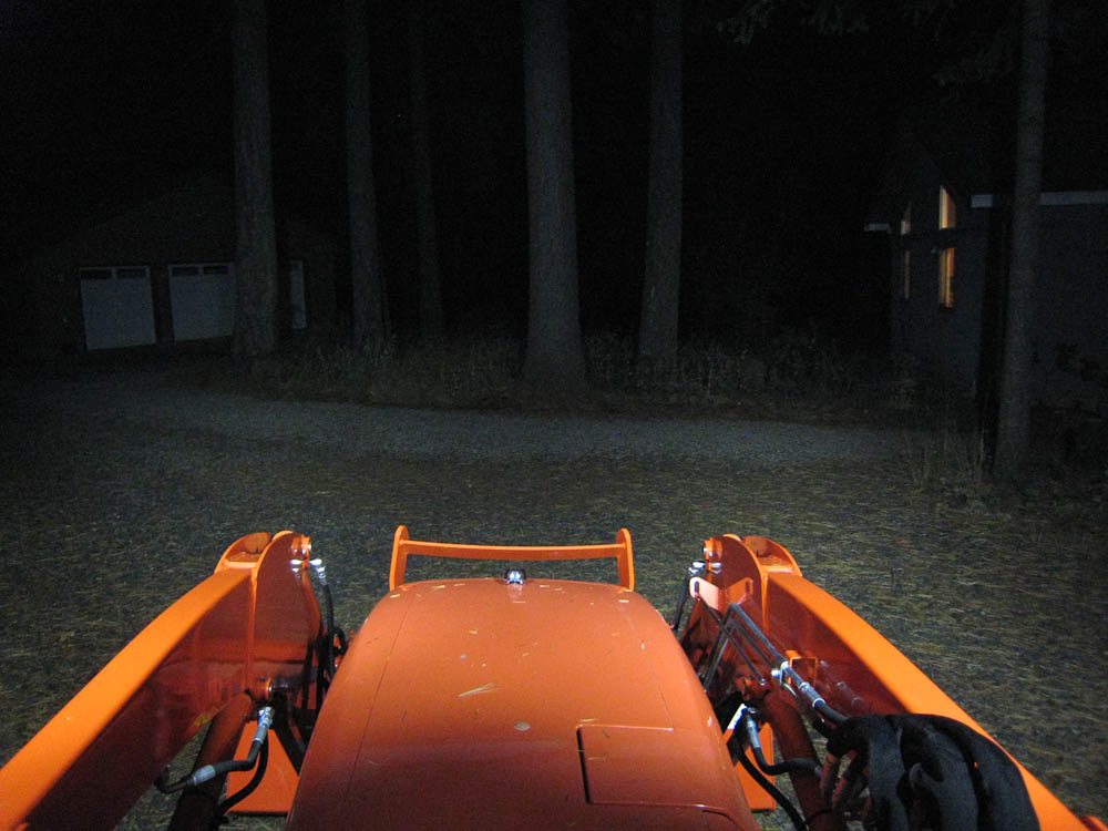

Yes. We are working on videos right now. I will attach a couple pictures that I have. I did the first photo on my street with my 2000 dodge truck and one pair of our 24-watt LED flood/work lights. In the other picture you will see the Rigid D2 Duallys that I sell and in the last 2 pictures are from a forum on TBN that a guy posted of his Kubota (hope he doesn't mind me putting his pics up). The Kubota pics are with his original halogens and one pair of My 18 Watt LED lights.

ok..thanks. Also, make the video with the lights at the same levels. Pictures comparing lights caught behind a loader compared to lights on the top of a canopy arnt a fair comparison.
Id like to see one or two lights side by side for comparison. ie: heres one halogen on teh canopy. heres one LED on the same canopy. that kind of thing.

Hmmm ... I saw those Kubota before-&-after pics before, but it just dawned on me: In the 2nd pic that seems to show more light, you actually lose the lighting on the tree & vegetation that is lit up further away in the first pic. Meaning, the "after" seems to be a much wider, fuller light result but not out nearly as far. I assume the OEM headlights were turned off in the 2nd pic? If so, maybe a 3rd pic is needed to show the light with both the OEM headlights and the aftermarket lights at the same time:
I also am not sure if the original tractors lights are 50 watt halogens? i know my 50 watt halogens on the cab extend ALOT of light out a long ways. On my Kioti the tractors actual headlights are only 35 watt. the cab lights are 50 watts each.
I wouldnt mind adding a set of halogen diffuse lights to the mix to add to the night lighting, but i need to see the real difference in light output.
