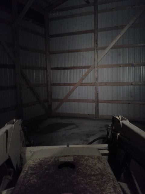

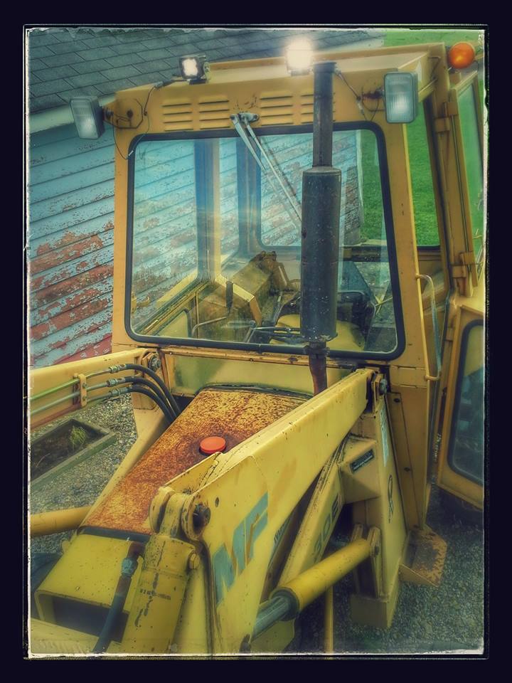

I've had Rigid Industries LED's on my MF 30E for about a year and a half now... I will never go back to the Halogen lights I had before (although you can see i still have them installed).
I left them on because they weren't hurting anything staying there, and I wanted to leave it to show guys the difference between the lights (although the mounting locations are slightly off, they are close.
Here's the difference between my halogens and the Rigid Dually Floods (The LEDs weren't aimed at this point because I was too anxious to see the difference, but you get the point)
