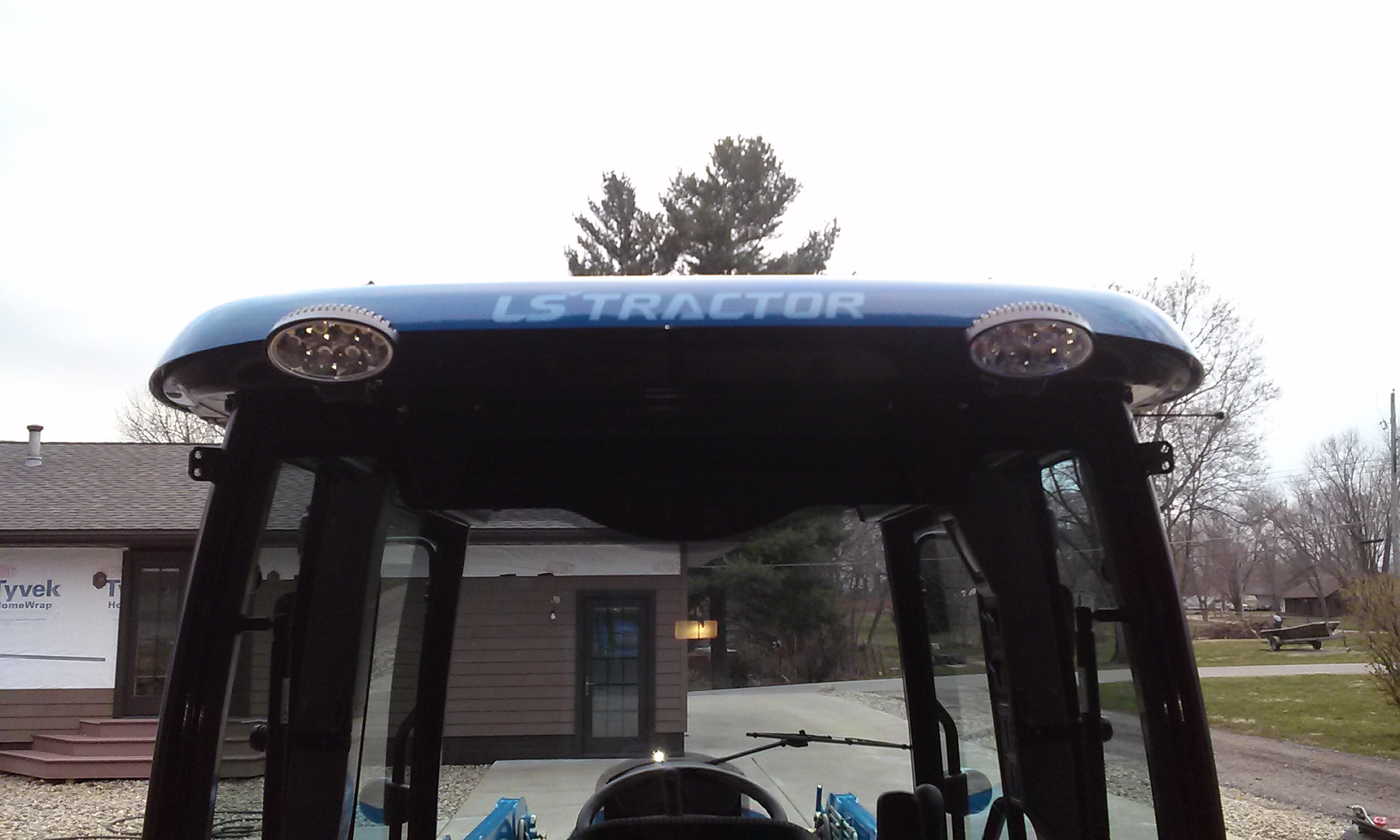

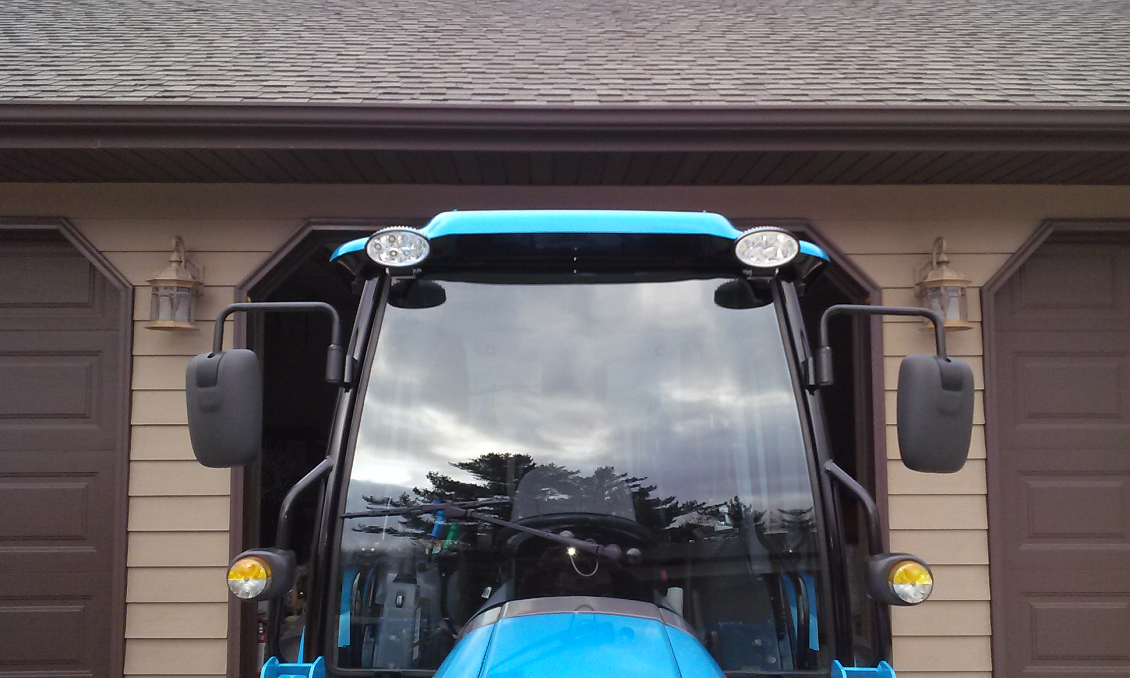

I installed 4 new LED work lights. What a huge difference. I stayed with the oval design to look like factory. They are 1350 lumens each. I got them from Surplus Center for around $225 for all 4 shipped. The brand is Buyers which makes some very nice products.

Looks good, I like that.
/ LED work lights #7
Looks good! I love my LED light bar but I do think your install looks cleaner.
/ LED work lights
Well, I don't know. Yours looks pretty good. I don't have a welder yet so I didn't want to get into fabricating a bracket. I've got to get me a welder. Yours probably puts out more lumens. 2 of mine combined are 2700. They are nice lights for the money. Aluminum housing with SS bracket. Came with 3/8" SS bolts but I went down to 5/16" SS so I didn't have to drill out the hole in the factory bracket. Thought that may create a rust spot by compromising the paint. I did repaint the front brackets a while back.

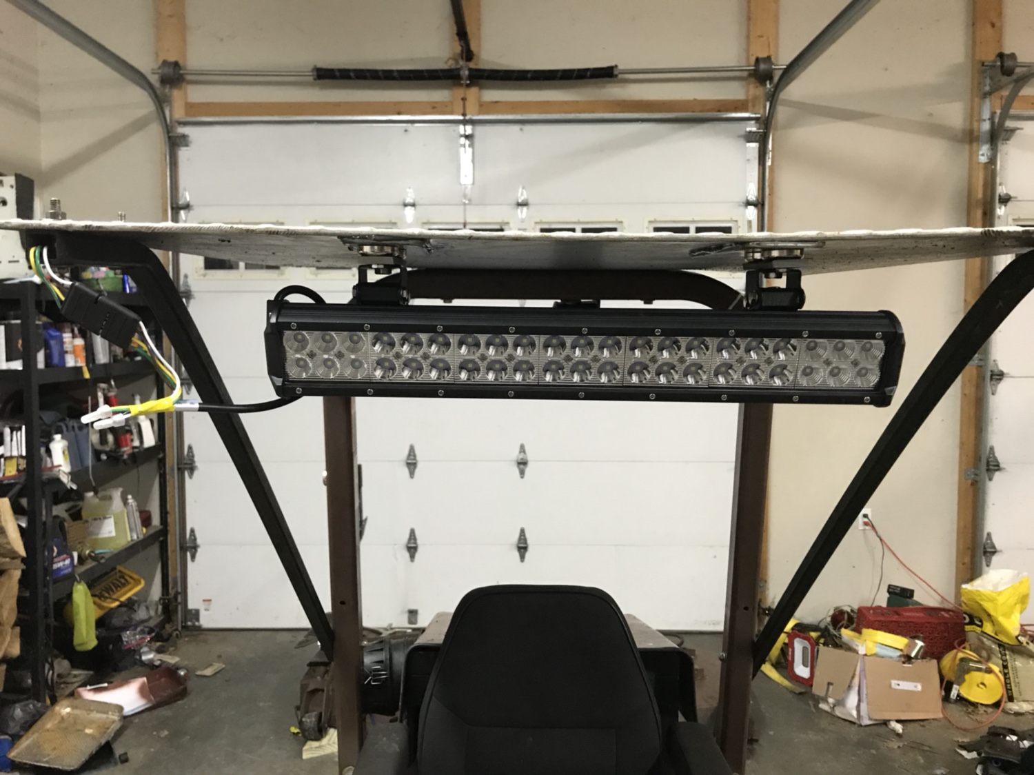

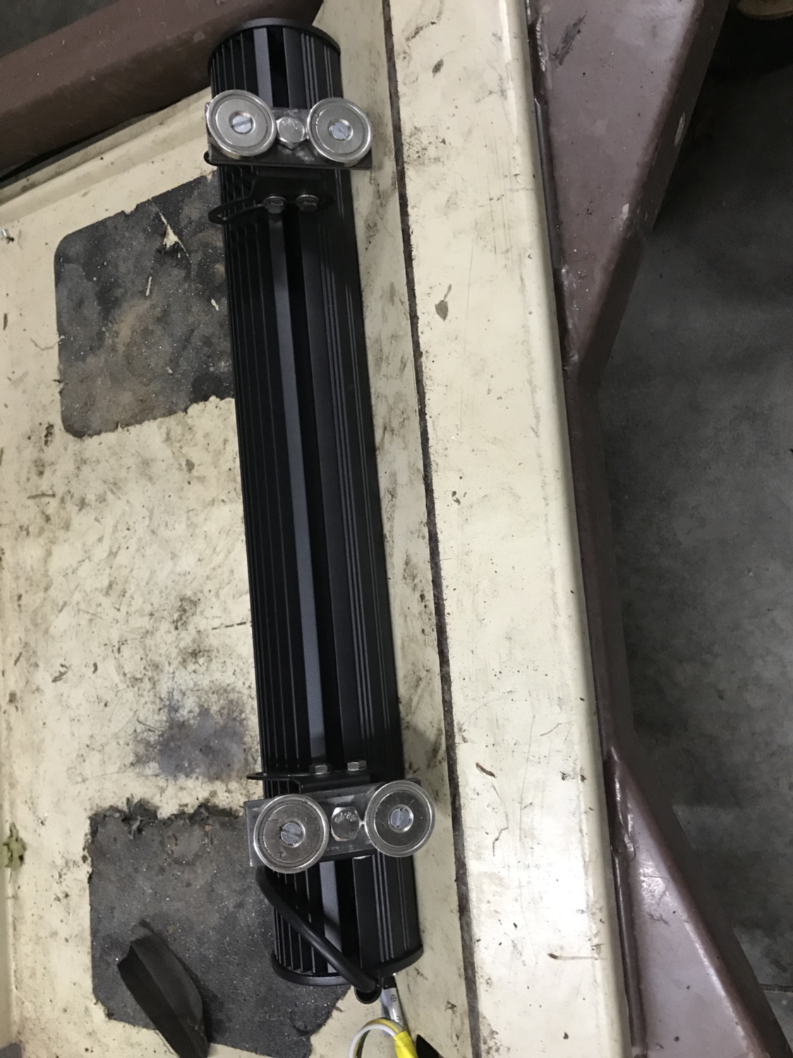

I mounted a led bar with 4 90 pound rated magnets. I haven’t had a need to use them yet but I don’t think strength will be an issue. I paid about $10 for a 6 pack. The main reason I used magnets is the light bar in the lawnmower is in my way getting on and off the mower and I wanted to be able to remove it. I mounted some pods in the back of my truck with zip ties. They have been hit twice and broke the zip ties without damaging my lights. IMG_1645.JPG
