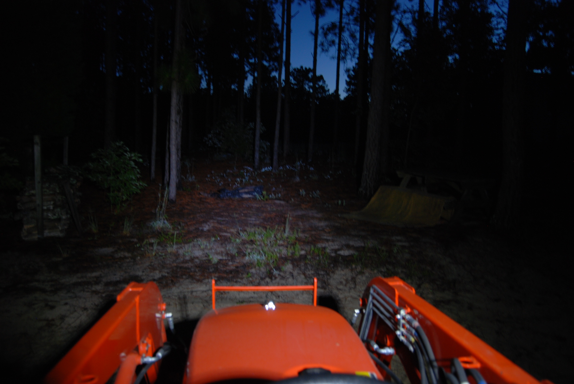

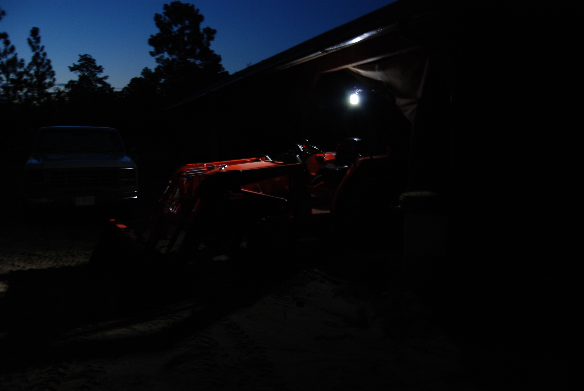

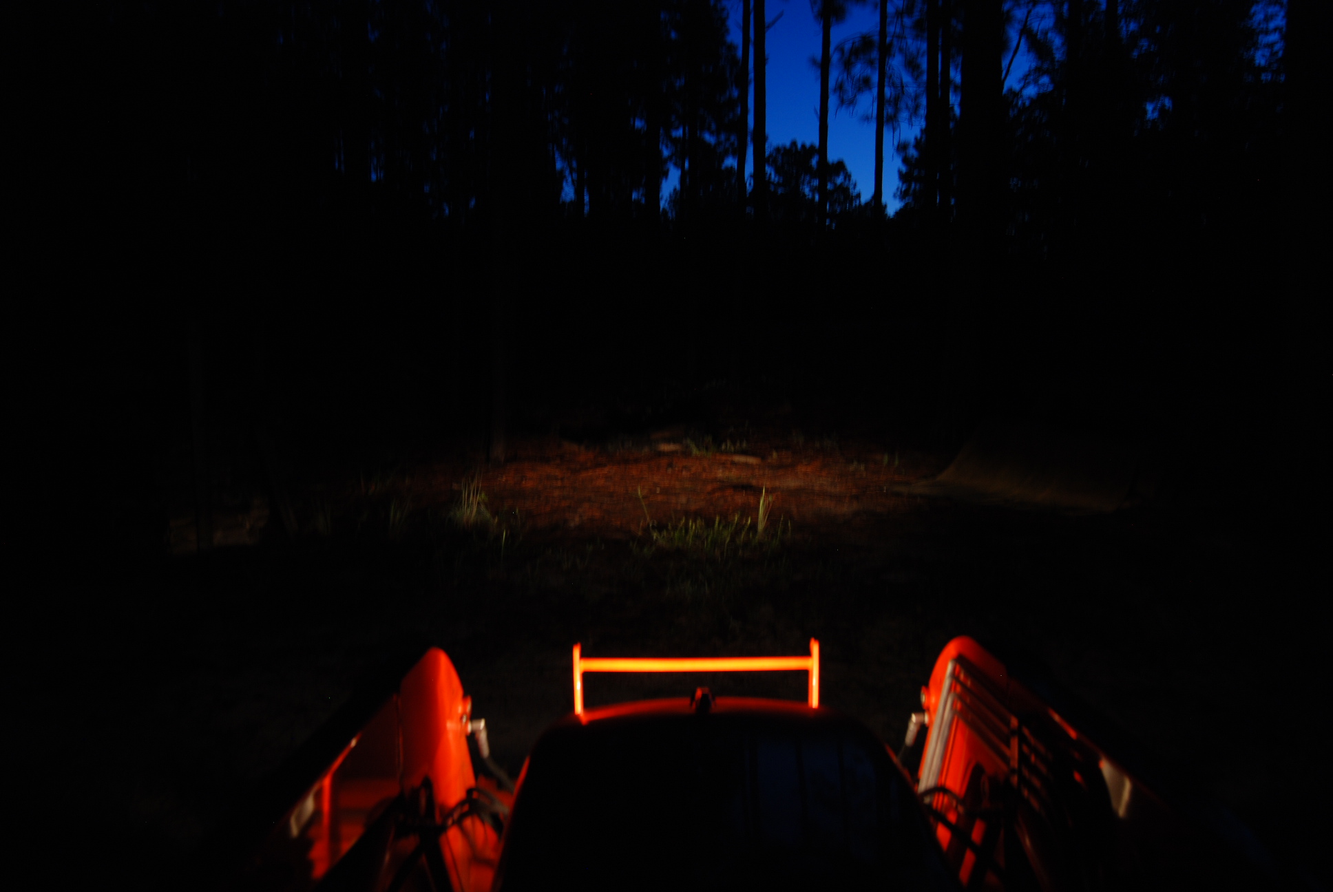

Installed 1 24W Flood. Pictures just before daylight.
Attempt to load pics. No flash.
2 with new light only, 2 with headlight only.
All the light is from the tractor, 2.5 sec exposure, the light seen in horizon was providing no light on the ground.
