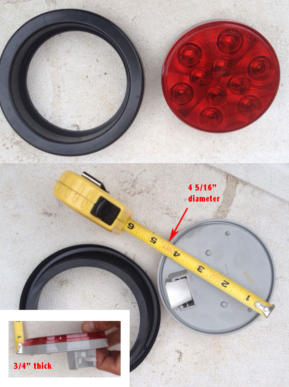

Yeah I thought of that corrosion too, but you can install the bulb covered with grease and it should be OK. However, 100% sealed seems better. LED 1157s work pretty well in my opinion. But I have some broken light housings and want to replace all. I like LED trailer lights because they take so little power to operate, and they are bright. Thus even if your trailer plug is corroded the lights are still bright.
I am hoping that HF have figured out (by now) how to build a LED circuitboard that will withstand vehicle vibration.
Everything seems to be 4 5/16" in diameter.
Thus I need to fit it inside the "box".
Newbury I have the same situation, looking for an inexpensive light that fits in the box. I plan to use Harbor freight "insert" lights and discard the black ring, and just silicone the light housing directly to the steel light bracket, then cover the box with a protective screen.
4" Submersible LED Stop/Turn Trailer Tail Light
Heres some pics and dimensions of the lights I bought at Harbor Freight. These same lights are all over the web for about the same price ($15 each). 4 5/16" is the actual (accurate) diameter of the light housing.
