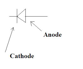

( to the original poster... as the LED is a diode.. yes.. polarity is important. i believe you will find that in a negative ground environment, that you will need to place the cathode of the LED towards the alternator, thus making the anode towards the switched power.. The cathode is demarked by a line perpendicular to the wire on the diagram, and the anode is an arrow shape pointing to the line.. ----|<------- kinda like that.. )
Actually.. her's a better diagram of a plain diode.. led will have a circle and an arrow pointing out.. or just an arrow pointing out, in addation to the diode pictoral.
