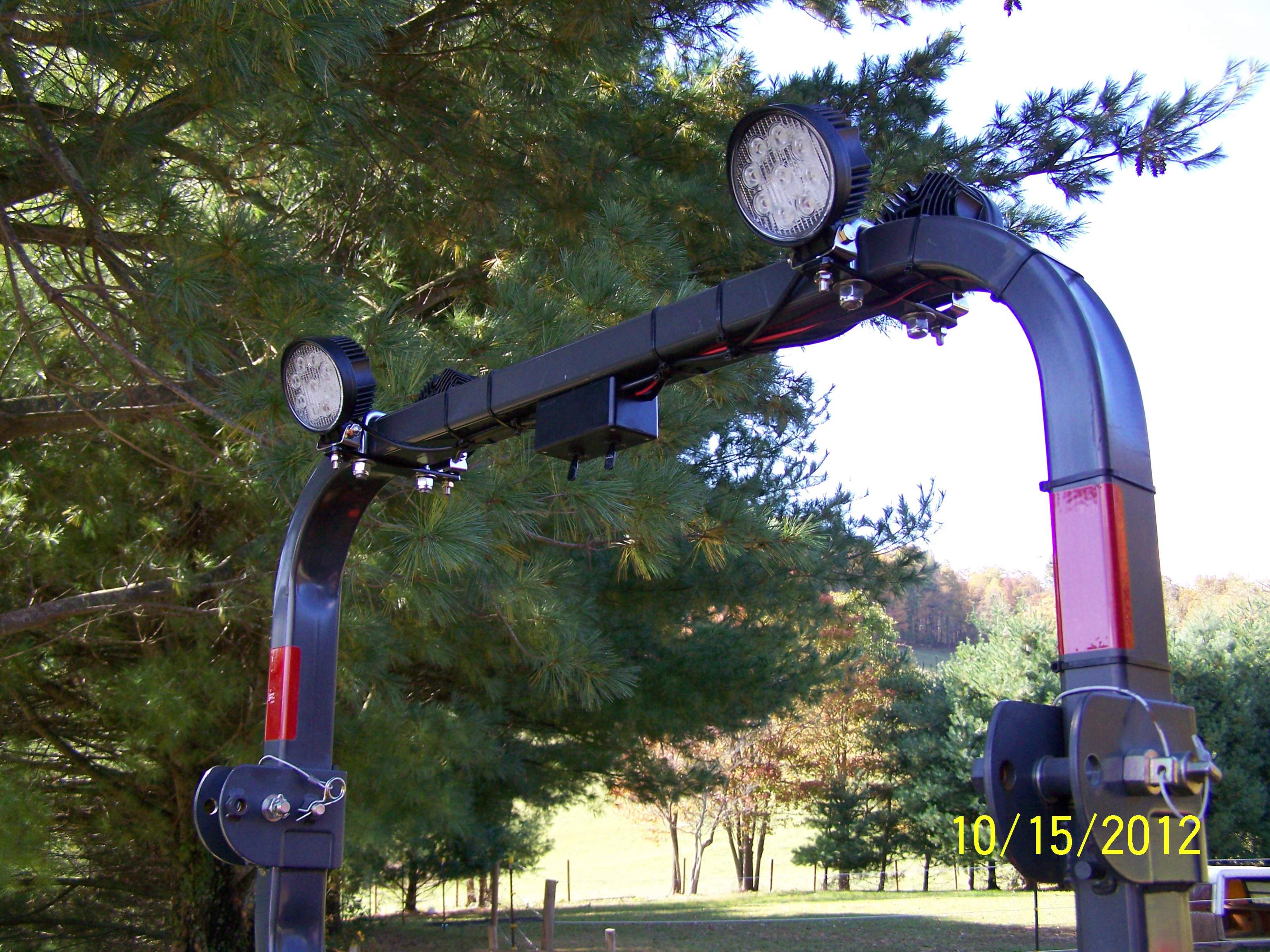

tractor stuff 003.jpgtractor stuff 002.jpgHere is my nothing fancy installation. Two 27 watt LED floods looking forward and two toward the rear. All are fed from the 10 amp work light circuit.

How do they work at night?
   / led lights tying into factory lights? Kubota L4330 #15
They seem to give plenty of light. They are floods, so I don't think they have the reach of regular headlamps, but should do well for snow removal ect. I had used regular driving lights on my last tractor, by disconnecting the headlights and tapping into that circuit. It worked well, but required more time and effort than using the work light feed. I don't do much night work, and the LEDs made for a easy hookup. Total cost was about $140 w/ brackets and wiring.

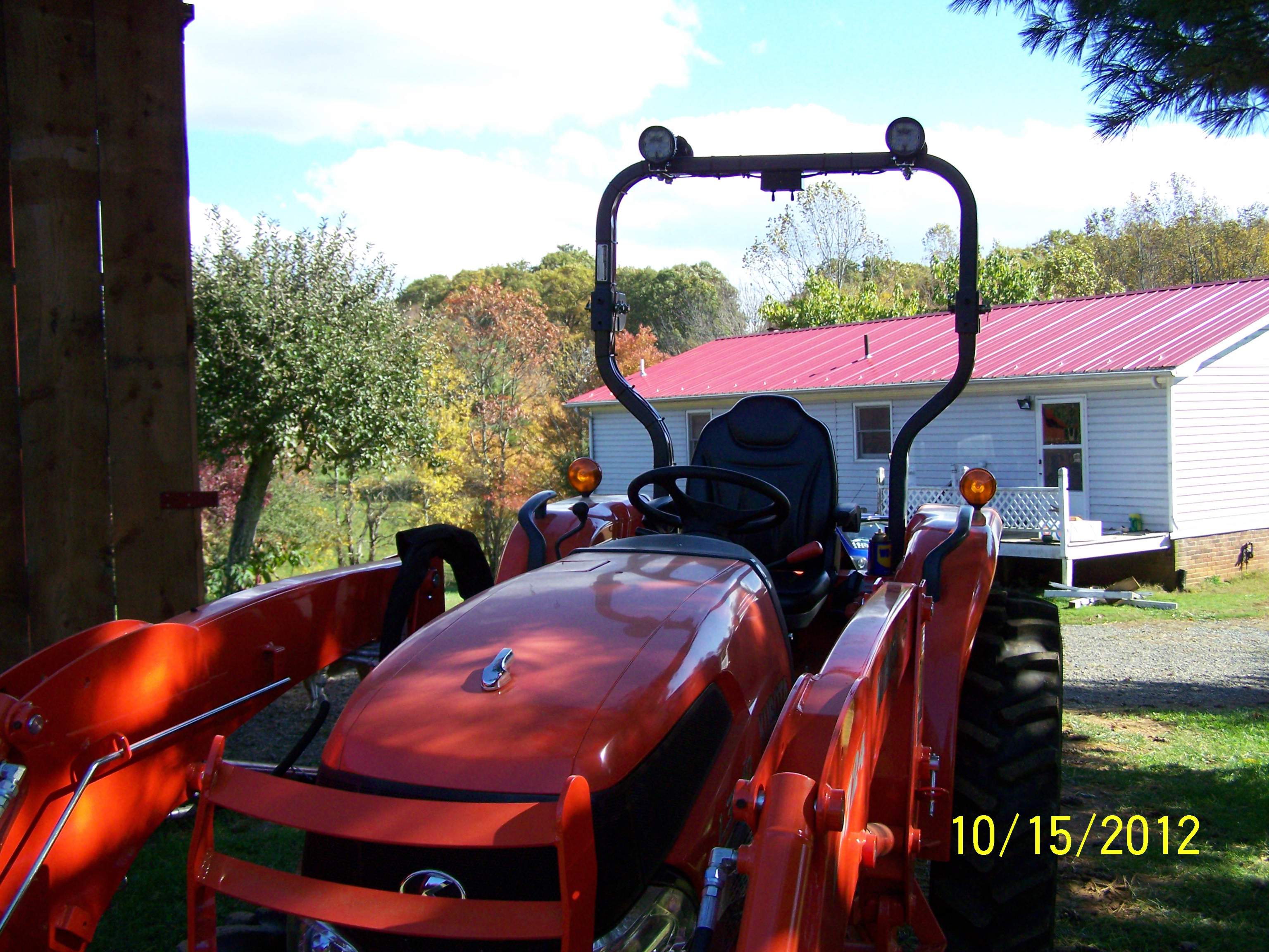

I bought 2 12v Par-36 55 watts ATV/Truck/RV Utility Rubber Work Lamps (around 15$ each) and installed it on brackets inside the ROPS so it's not in the way when going in the woods. I connected it with the connectors that are located under the seat. I already had the Kubota 35 watts worklignt installed and connected at the same place. Since all 3 cables goes to the sams fuse that is 10 amps, I changed it for a 15 amps (35 watts + 55 watts + 55 watts = 145 watts / 12 volts = 12 amps). A 10 amps fuse is too tight for those 3 lights at the time but, since it only draw 12 amps when they are all on , it won't damage the wires. I have to admit that I never try letting them on for a very long period of time (hours). Hope it will help you.

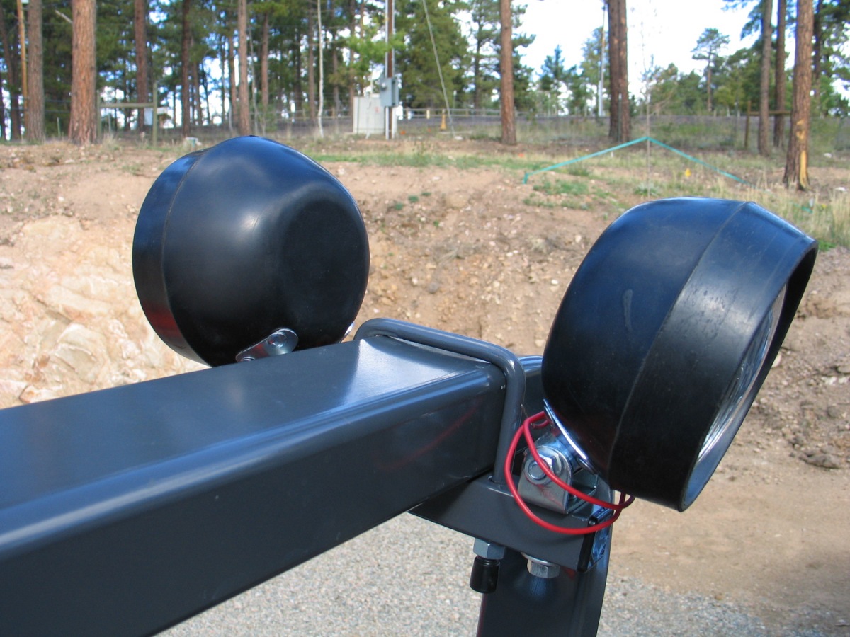

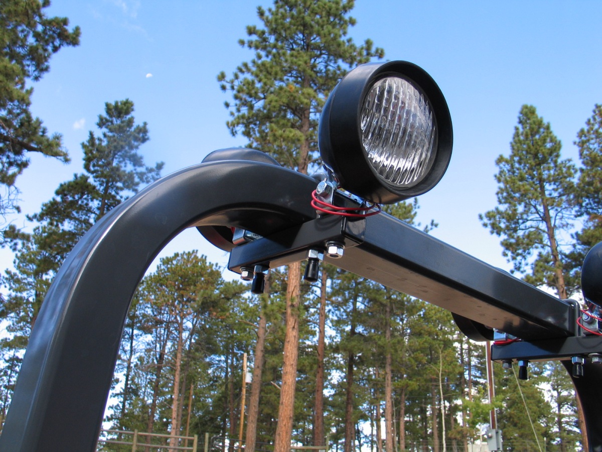

Funny all the LED posts now. Back in the old days of 2008 when I did my ROPS work lights, LEDs were way more expensive, and there weren't anywhere near the number of options that are available now. Because I used Halogens, my factory rear work light wire still sits unused.
I wired in 2 relays off the battery (one for each pair of front & rear lights), then installed Kubota L39 worklight dash switches to make it look factory installed. If I were to ever want to add LEDs to that setup, there's enough power to run about 20,000 lumens worth of LEDs up on the ROPS. :laughing:
   / led lights tying into factory lights? Kubota L4330 #20
Can you put up a picture of inside ROPS lights - I want to do the same but I am really not sure about the brackets? Did you make them or buy them?
Take a look at my light mount photo, in my earlier post. Just flip the light over and they will be inside the ROPS.
