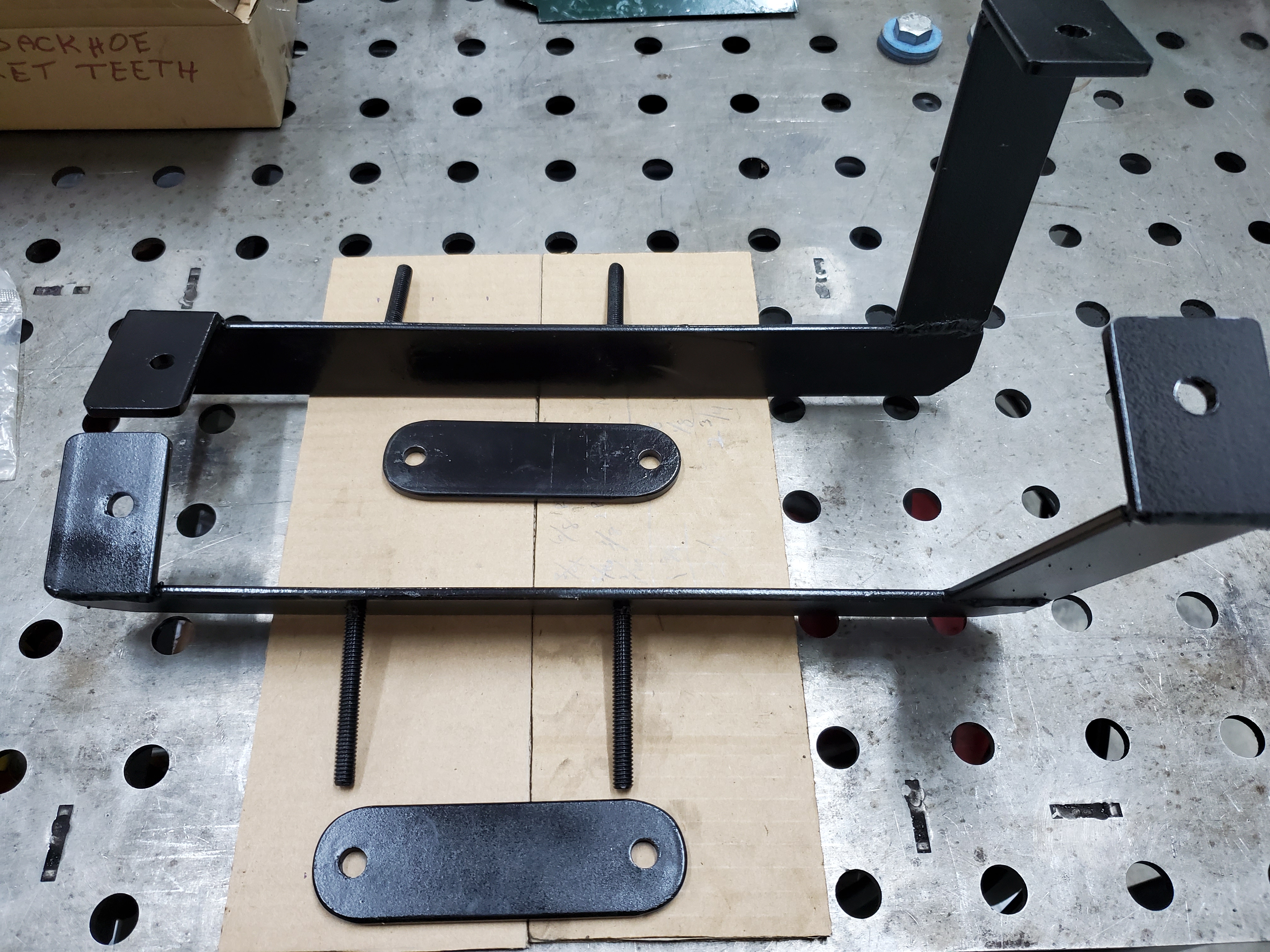

I made some simple brackets that clamp onto the ROPS. I made the spacing equal front and rear in case I later decided I needed a light bar in front as well.
The lights and harness all are Traveller from TSC when the lights were on sale.

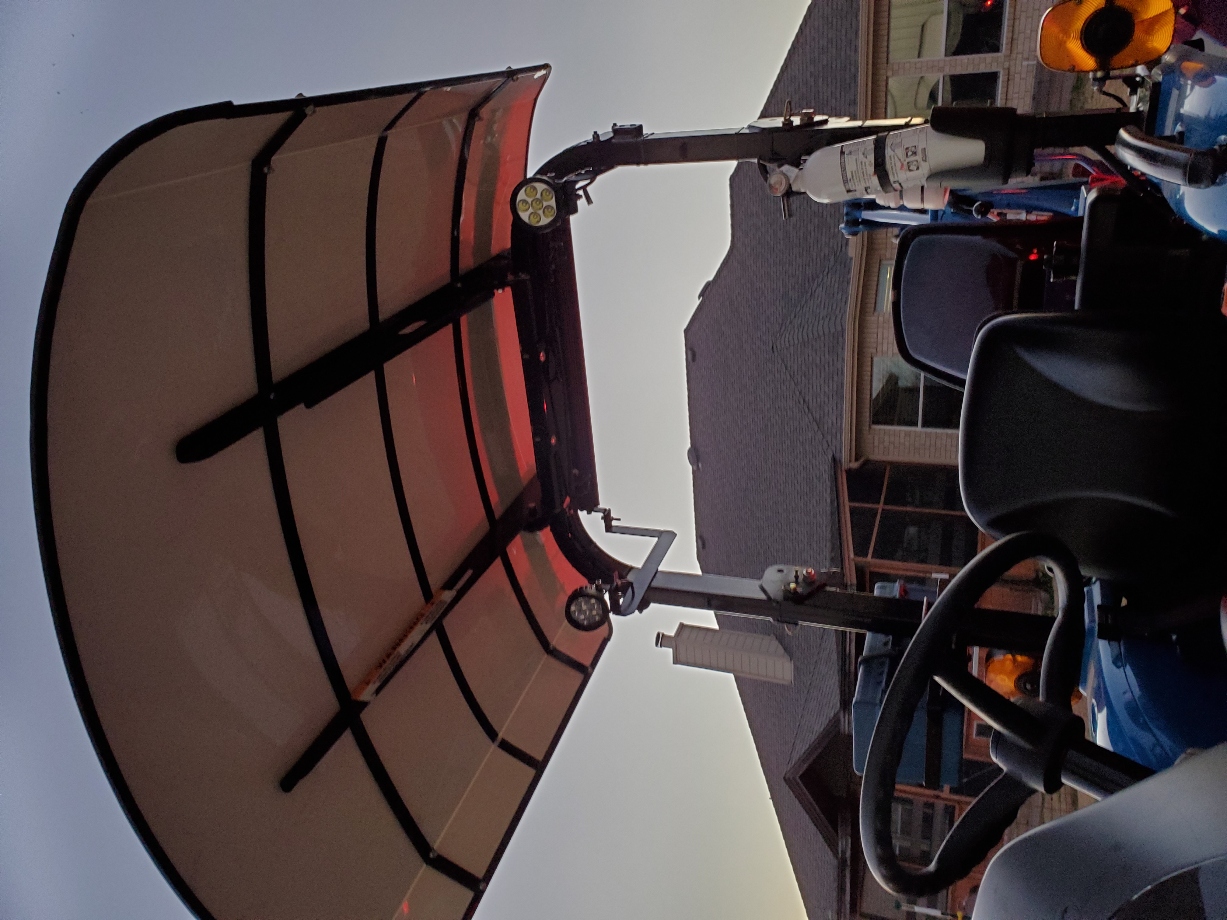

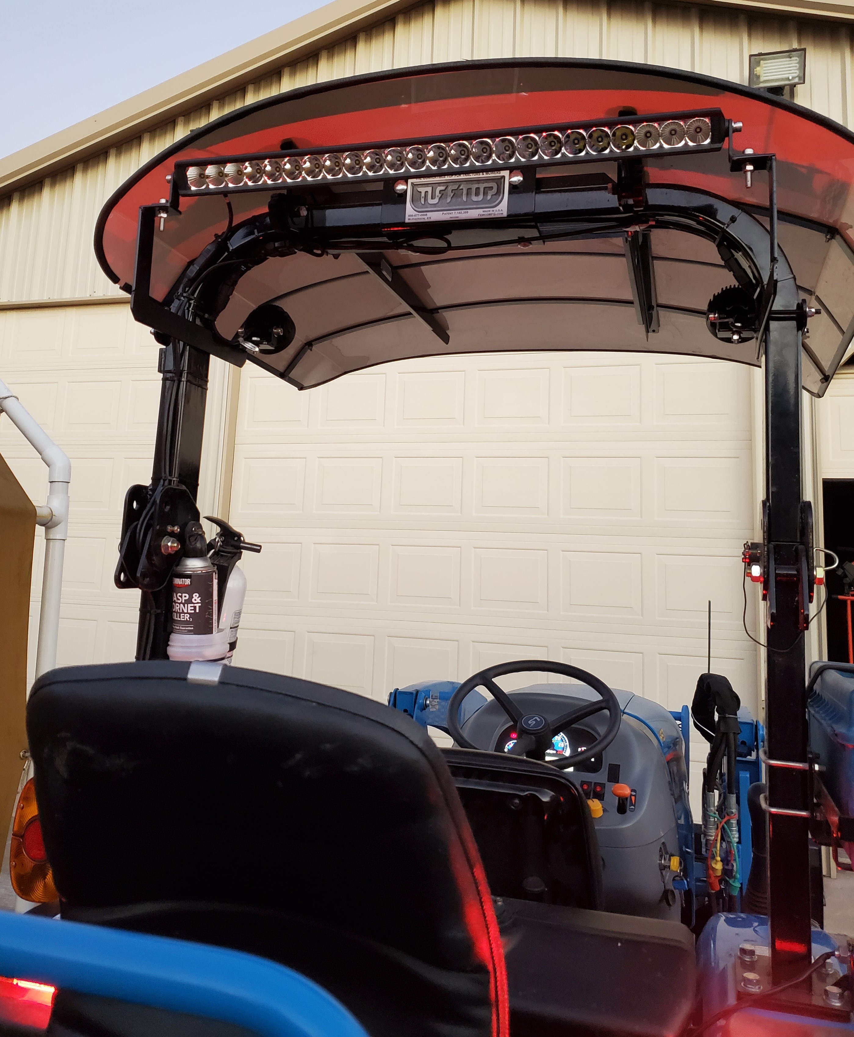

If you do them, do them inside like TnAndy shows. I've even moved the red/amber lights inside the ROPS on 3 tractors now after bashing one light on the 1st tractor.
