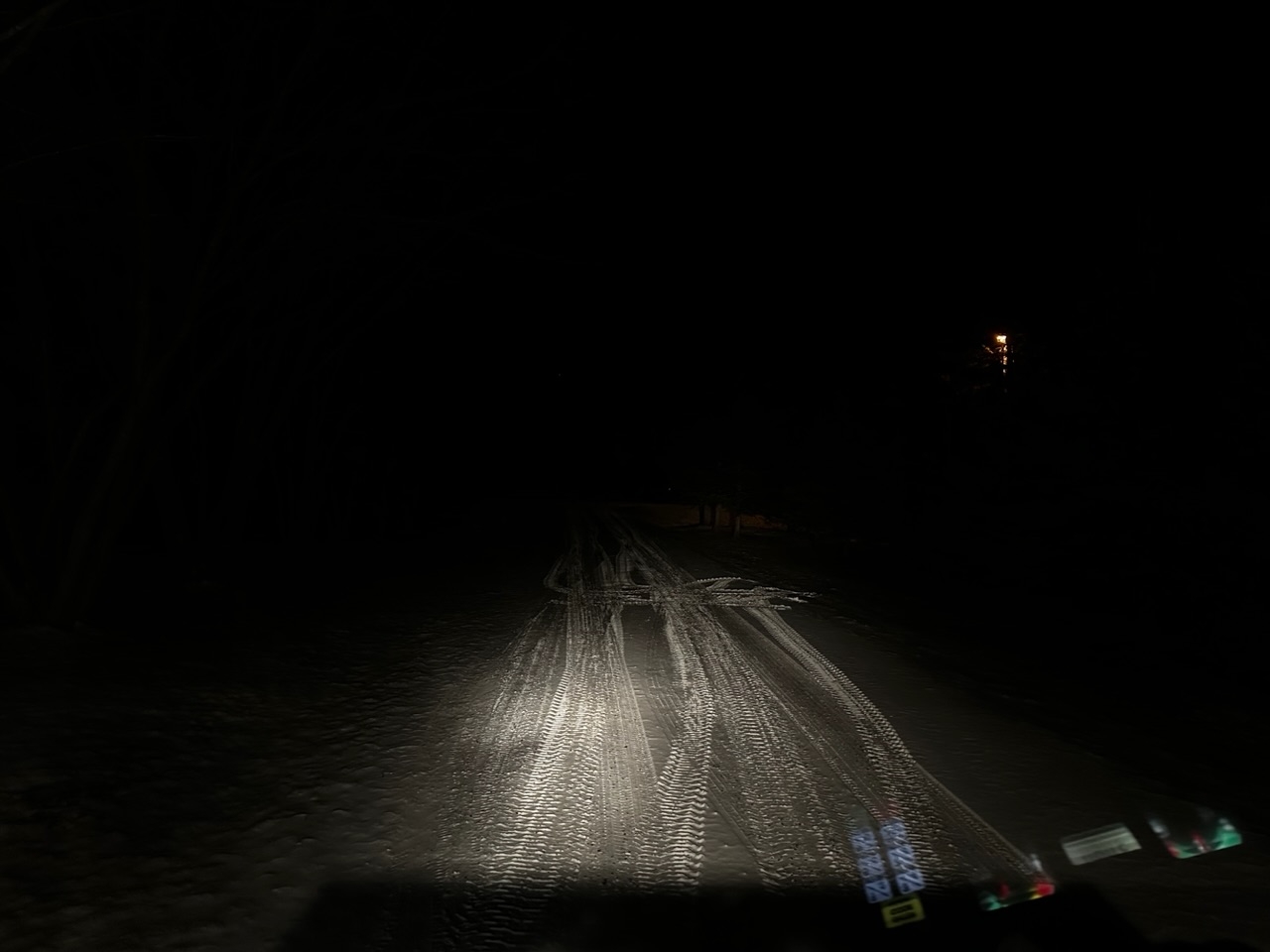

Hey Guys -
Decided to make use of this no snow time to finally go ahead with upgrading to some of the lights to LED kits. I had some burnt bulbs and a damaged housing already and found some pretty good Black Friday deals down at Princess Auto.
I ended up going with a light bar across the front and 2 flood lights rotated outwards to help with the spread:
I managed to use the original hangers with a bit of tinkering to help keep everything away from the windshield. Using use the supplied light bar mounts resulted in the wipers colliding with the light bar:
In the rear I went with 2 large flood lights and they were pretty similar in size. Managed to fit those into the original mounts as well:
For the connections, I decided to remove the connectors and go with marine grade splices. I thought about going with removable connections - but decided to go as water tight as possible instead:
The results are even better than I had hoped. I’m out in the country and had often wished for better lighting. Safe to say I wish I had done this years ago.
Front Before:
Front After:
Rear Before:
Rear After:
I love the brighter whiter light - definitely recommend the upgrade!
Looks like there is finally some snow in the forecast, looking forward to trying out the new setup properly soon.
If anyone is interested - I’m happy to share any details on the lights or answer any questions I can.
Hope Santa was good to everyone!

Looks good and nice light coverage. One of the first things I did when I got my TC was change the front bulbs to LED. Does make a dramatic difference with the right bulb and color temperature.
When experimenting with LED lights years ago for my Holder, for snowblowing at night I found color temperatures above 5500k had too much of a blue tint for me and true color definition of objects was not as accurate. Sounds picky but I prefer to see things as accurately as possible when blowing at night because I spend so much time at it.
Liam, I know photos aren't always accurate but I really like the light color and throw of the rear ones you installed. Who makes those and where did you get them. I was blowing last night and was reminded I really need to do something with those rear lights.
FWIW, I found 885 connectors online and put those on the new LED light harness of two lights I had tried on the front. That way I retain the stock connectors, the lights are easily replaced and the 885 plugs are a waterproof connector.
