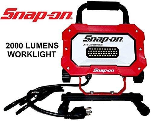

I've bought a couple of the Snap-On LED work lights at Costco. They're rated at 2,000 lumens and consume 25W. Cost was about $30 each but they might have been on sale at the time.
One light I leave sitting on my blasting cabinet, the other I hang inside the truck hood or tractor roll bar for working outside at night. I'd think with 6-8 of them you could light up your ice rink at night and cost you maybe $1 per week to run.
