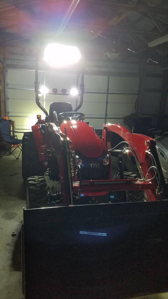

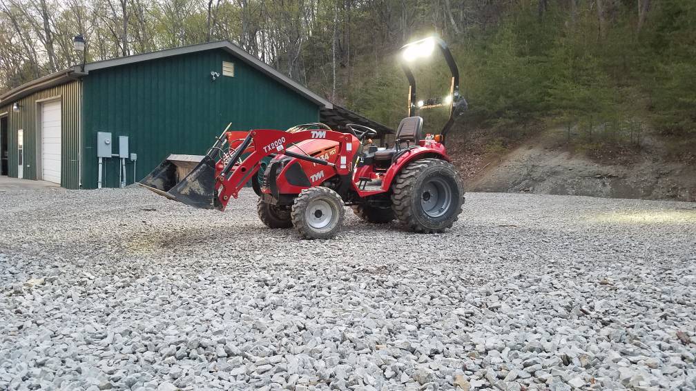

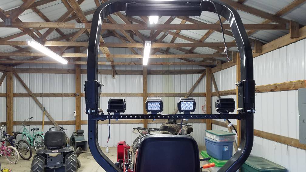

Hello all. I'm new to tractorin' ....1st thing I noticed is that I didn't have enough light with my bucket in the way.
Total cost was under $100.

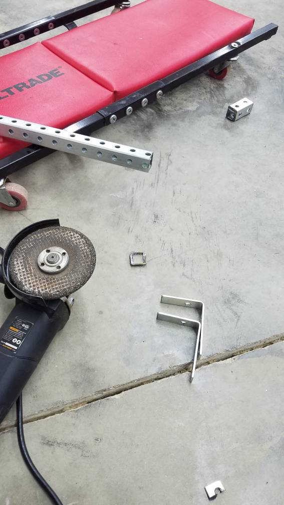

I was bad and tapped the ROPS for the light bar.
The pods I mounted to a piece of metal I had lying around, 3/4 inch square tube. L brackets then bolt to the ROPS fold down eyelets.

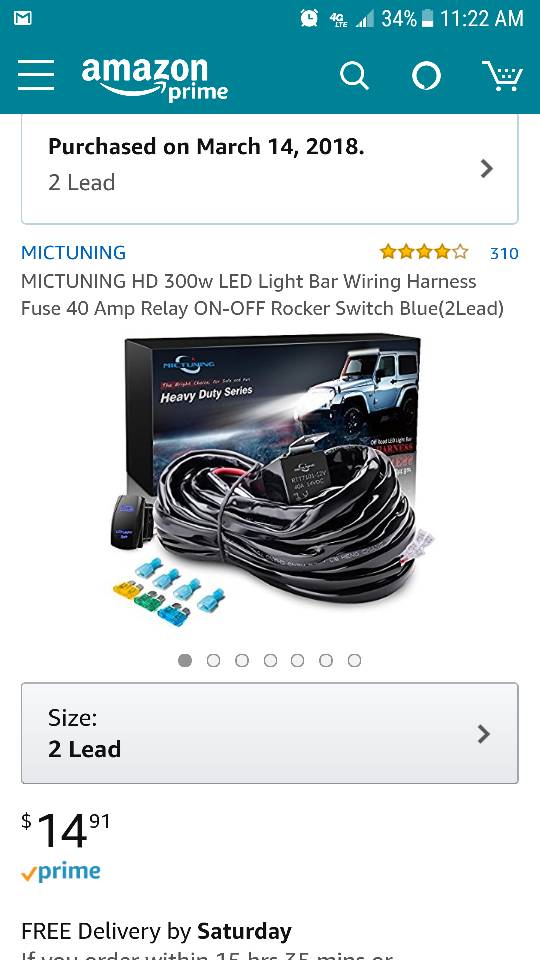

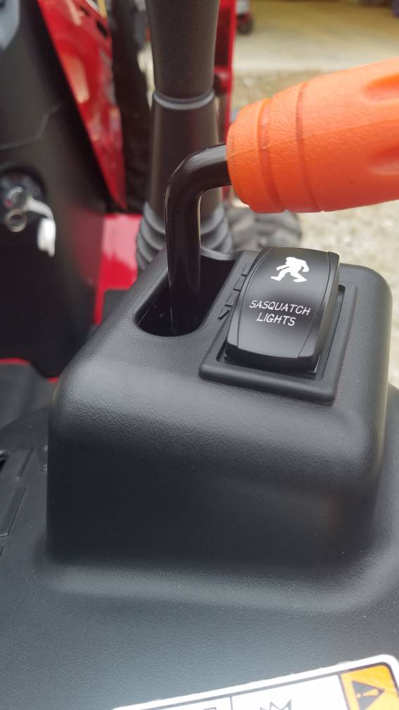

Wired in series the lights go to a fused relay I mounted directly by the existing headlight relay. (I changed the headlights to LEDs too). The relay is powered by my sasquatch switch which allows current from the battery to the lights. I found a positive wire that turns on when the tractor is started by the existing rear lights. That wire powers my squatch switch.

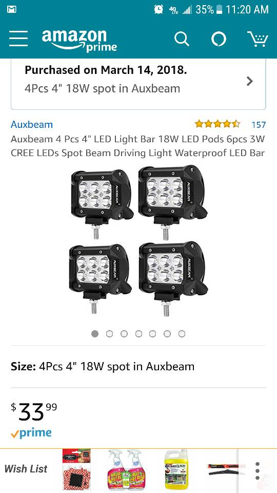

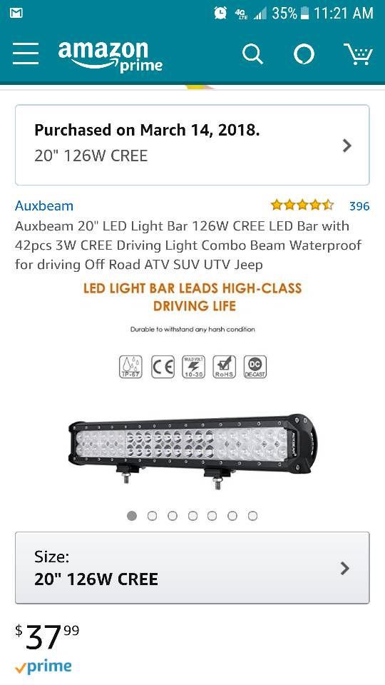

I used a Nilight switch and relay/harness off Amazon. The Auxbeam light bar and pods are also off Amazon. Originally I wanted 3 separate switches....but I had nowhere to cleanly mount them.

Sorry. It was Mictuning harness....Nilight squatch switch.Screenshot_20180531-112203.jpegScreenshot_20180531-112104.jpegScreenshot_20180531-112011.jpeg

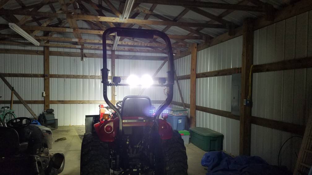

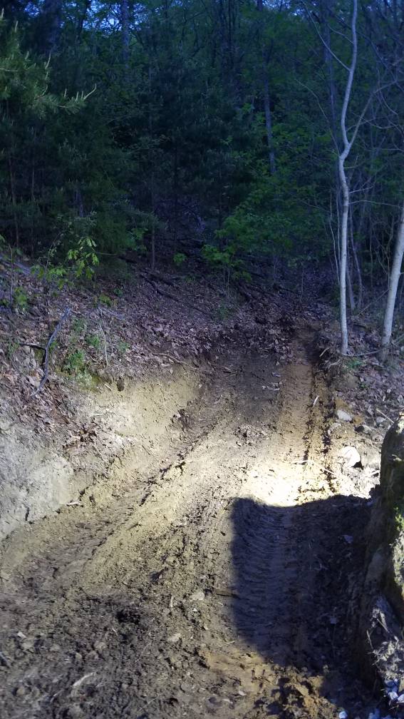

So the rear-facing are spot vs flood lights? Still light up a large area or is it more like two separate "hotspots" of bright light?
/ LED Light bar and pod light install
They flood pretty good....better than most backup lights on today's automobiles. I have the 'hotspots' on both sides of my 5.5ft box blade and it give me all I need to do work and make adjustments to my box. ( I don't have a tilt cylinder for my end link yet, so I'm doing many adjustments)
In the pics you can see hot spots on door and by rock ....but plenty of flooded light to see around... hope I answered your question!20180331_171401.jpeg20180502_204346.jpeg20180331_171429.jpeg
