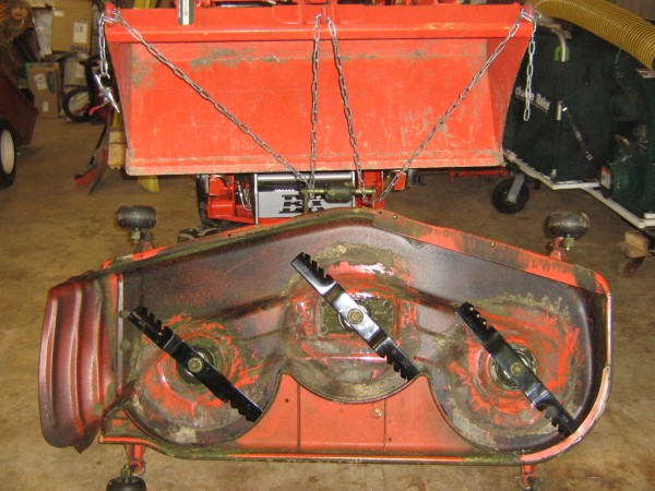

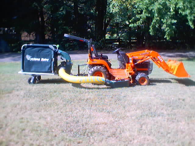

I use two methods to attack the abundant leaves around my abode w/my BX23.
When the leaves aren't too thick I use my gatorblade equipped BX23 to chop 'em up into lawn food. Starting from the outside and working in, I side discharge into the next row I cut which mulches 'em up more. By the time I get to the last row theres not much left for the final cut.
Since I do keep a compost pile cook'n, when the leaves get too thick I pick up the shredded debris w/a tow behind Cyclone Rake. It'll pickup just about everything I run over which is in turn fed to the compost pile.
Since I went to the gatorblades this past summer I have used the CR only about half as much as I had the season before and could probably do without it but it's needed to keep the compost pile fed.

I also have a Cyclone Rake,only way to go.I saw a post on another board today that they are almost a month behind on orders.Good piece of equiment.
Where did you get your gator blades?I have a B7610 with a 60" mower,they would be a good investment to go with the C.R.

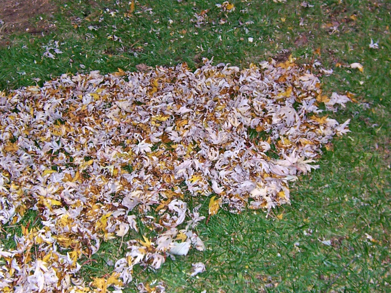

I use the Kubota 3 bag grass catcher on my B7610 with a 54" mower. It works graet. Attached is a photo showing a spot I didn't get to next to a spot I went over once, so you can see the effectiveness of the catcher. I'm mowing and collecting on about 1 1/2 acres with lots of trees. I'm collecting about 12 cu. yards of leaves.

tony3542, I got the gatorblades from a local Kubota dealer. They are made by Oregon. And yes they work very well with the CR. The blades chop everything up into smaller pieces and they gace better lift than the std blades.
The set I got are made for a Kubota ZTR w/a 60" MMM which has an 1 1/4" center hole while the BX 60" MMM has a 7/8" hole. It just so happens that a Cat1 to Cat2 adapter has the same inside/outside dimensions so when cut down it makes a perfect spacer to adapt the blades. The cut & performance is definitely worth the change to them.
I don't know if the B series 60" MMM uses the same size spindles as the BX or ZTR but it would be worth checking into.
In the link NY Yankeesfan posts a link to a site where he got a good price on the blades
