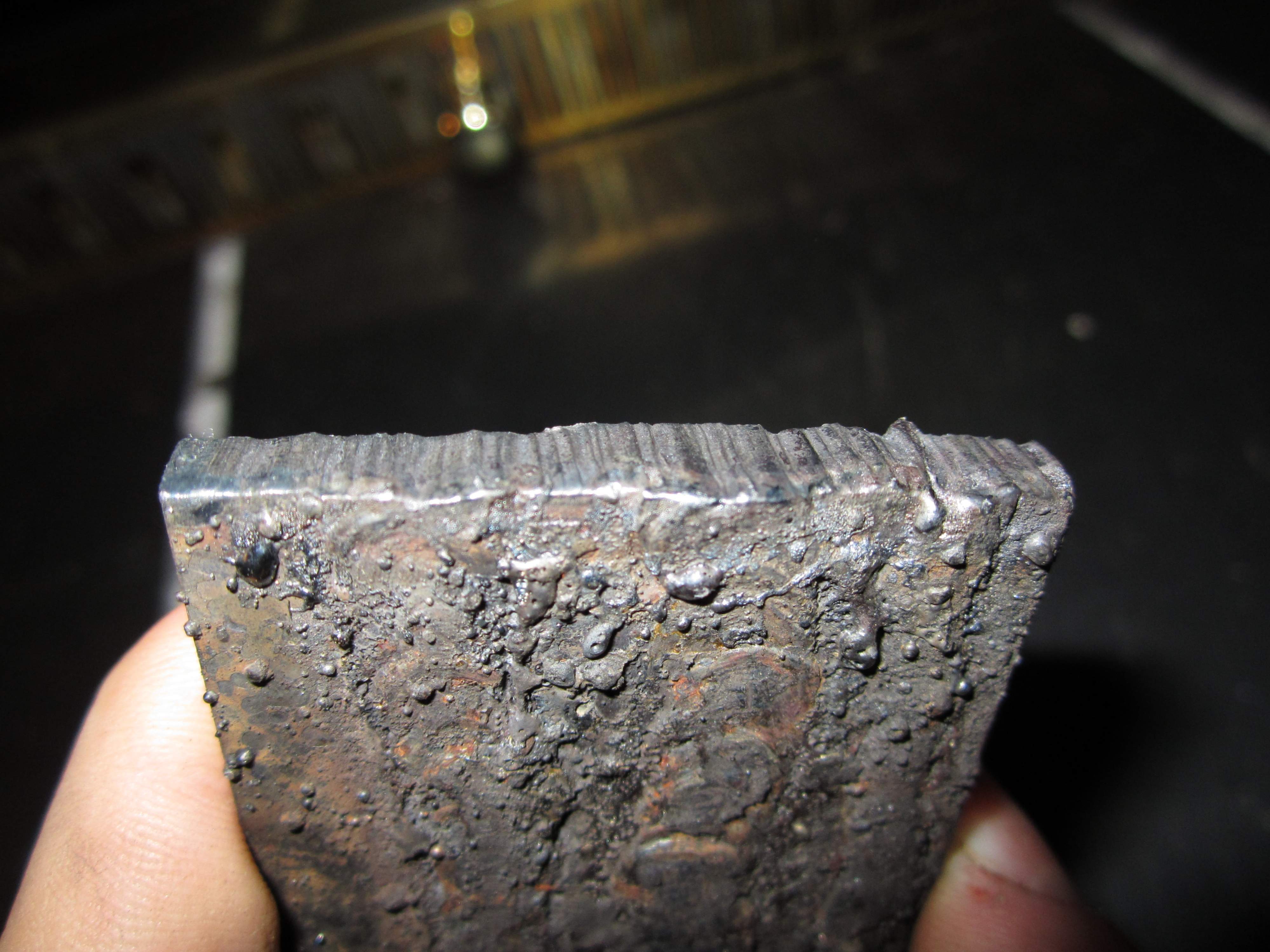

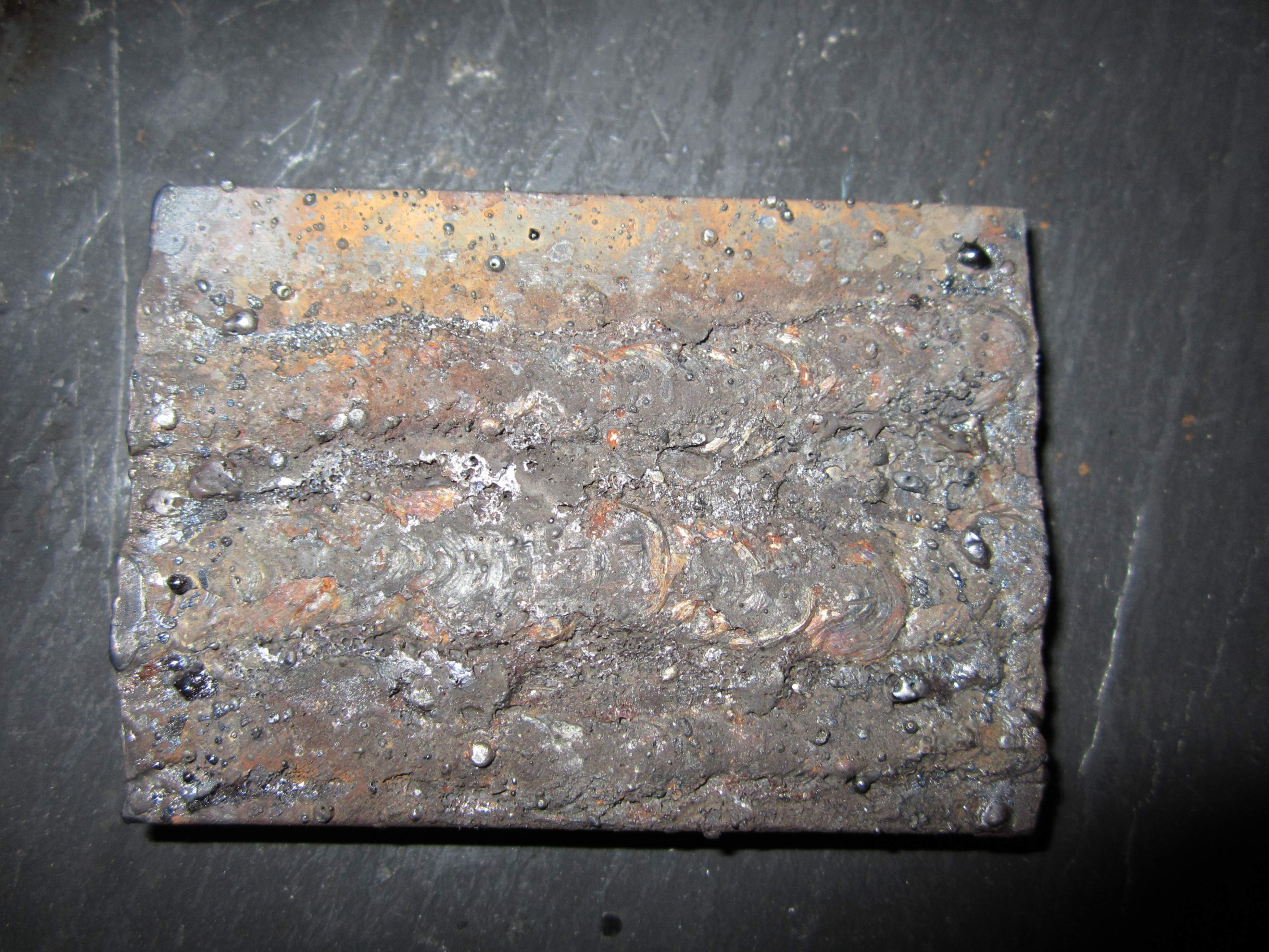

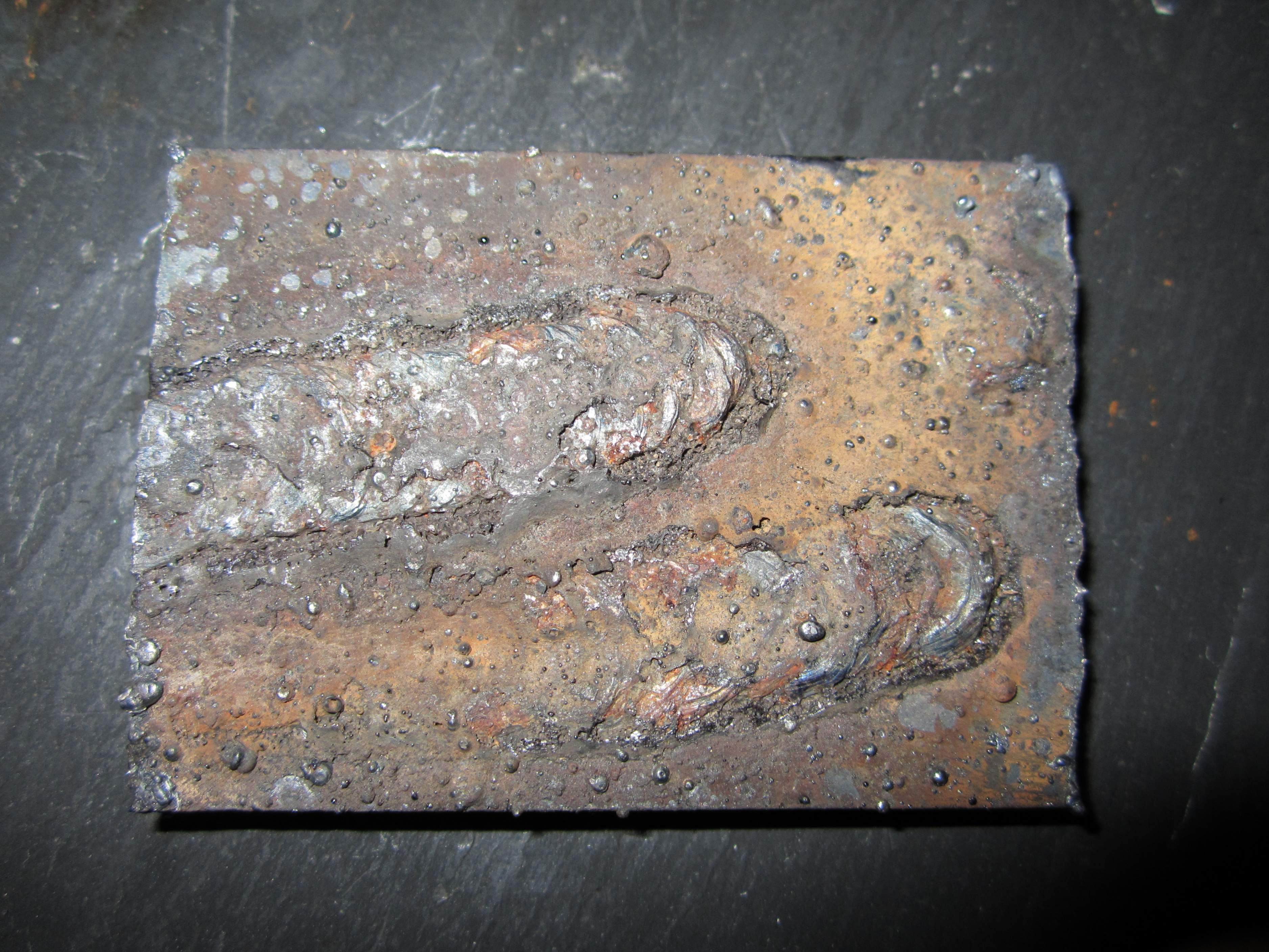

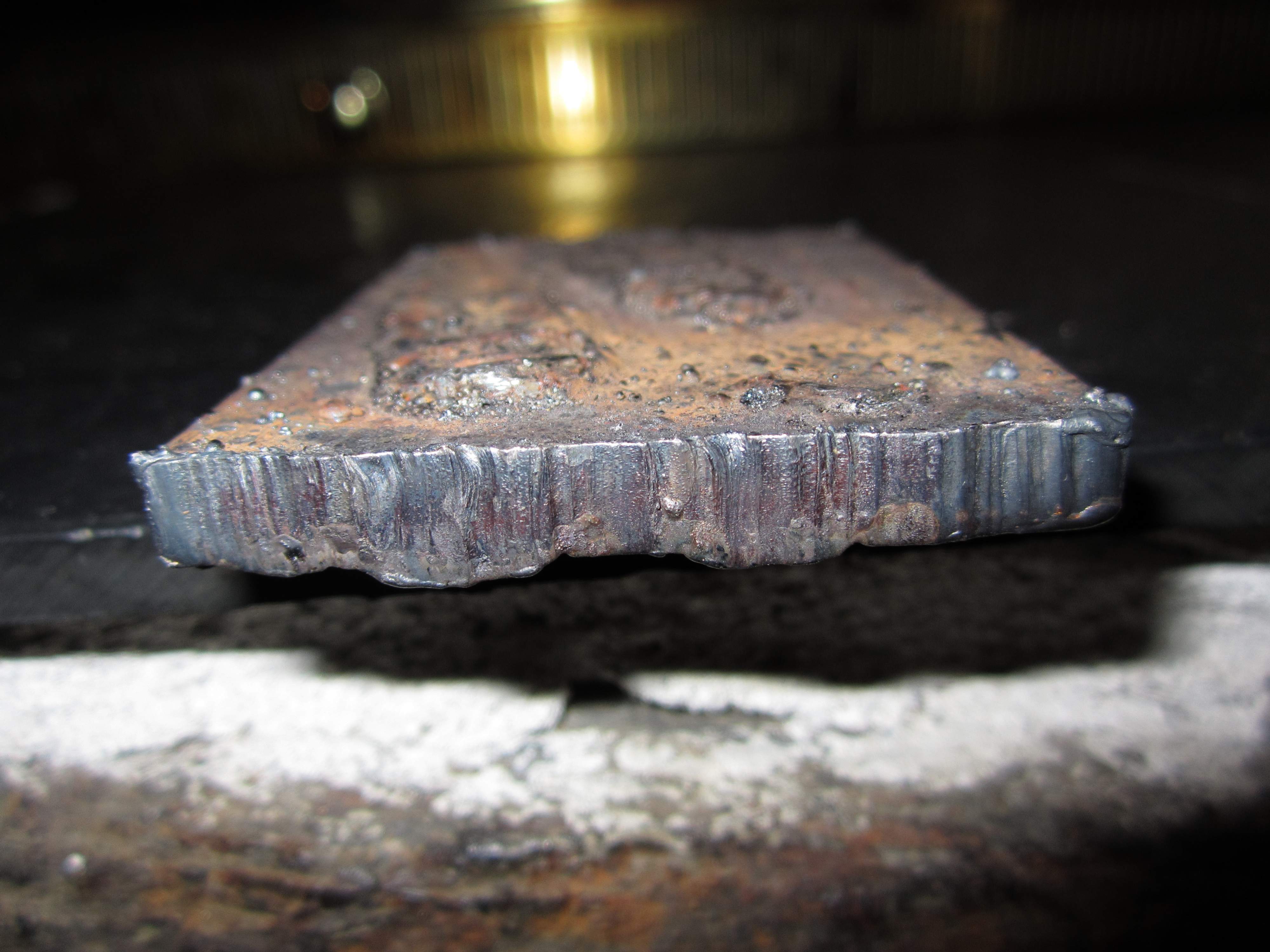

Well today I was doing some torch cutting for the first time in probably 2 years. All the torch cutting I had done then was melting my way through some rusty re-bar. I have been watching a few videos on it, and looked up the settings online. Well here it is. I was using 5 psi acet, and 25 psi oxy with an airco 00 tip. 1/4 inch plate covered in rust, spatter, and 6011 slag.
Here is some pictures of the top and bottom of the plate.
Here are some of the cut.
NOTE: no cleaning was done to the piece before or after the cut. The pictures are of two differnt cuts on the same piece.
So what do you think? Any tips? I wont be able to do any more cutting for a few weeks, since I am out of oxygen, and I wont be able to get to air liquide for a while. When I get more oxygen, I will be able to try any tips.

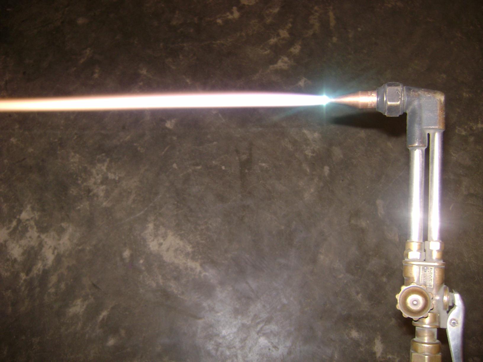

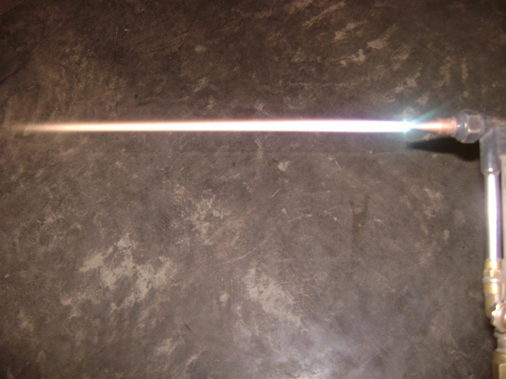

I think one of the biggest mistakes people make with a torch is pushing the lever all the way down. There is a sweet spot with a torch, sometimes it is only an 1/8 th of an inch down on the lever. What you want is the cutting cone to reach out as far as possible from the tip, and have a turbo sound to it.

I did watch all of irishfixits videos, and they helped my a lot. Also, the pictures I posted dont really show the cuts very well. They are A LOT smoother then the pictures make them look, and there is no slag under the cut. I did make a few better cuts, but this is just the one I grabbed. Some of the cuts looked almost plasma clean. I think they are pretty good for my first attempt.
Thanks, thats a good tip. I will try that next time I can cut. Also, what kind of torch do you use?
Also make sure you lead (point ahead) your flame into the cut
A lot of people will have their torch head at 90 degrees to the piece when in fact 60-75 degree angle works much better

When I was cutting, my biggest problem was moving too slow. The metal would flow back together behind the torch.
Once I speeded up a bit, the cuts were cleaner.

I found I had to move really fast to get a good clean cut. Hey my first time cuts with a torch were a lot better then a lot of plasma cuts I see at school. No dross at all. I have to say after seeing how good my beginner cuts were, I dont even want a plasma. On the bottom of those cuts it looks like there is a lot of slag hanging off, there isnt. That is a weld bead on the bottom of the piece. My dad said my first cuts were better then he has ever made. That was nice to hear.
