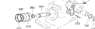

IMHO hyd pump is not causing 3 pt hitch to settle but either faulty 3 pt rockshaft piston seal &/or relief valve are at fault or possibly faulty control valve. 3 pt lowering/raising on it's own has in the past been referred to as "hiccuping". The 3 pt rockshaft piston seals in photo appear to be reasonably easy to replace so that's where I'd recommend to start.

Thank you very much for your suggestion, Jim. I'm not sure what you are referring to as the rockshaft piston seals. Would you mind referencing the part(s) by number from your diagram?
I also believe I found that same page in my parts manual, in case that helps.

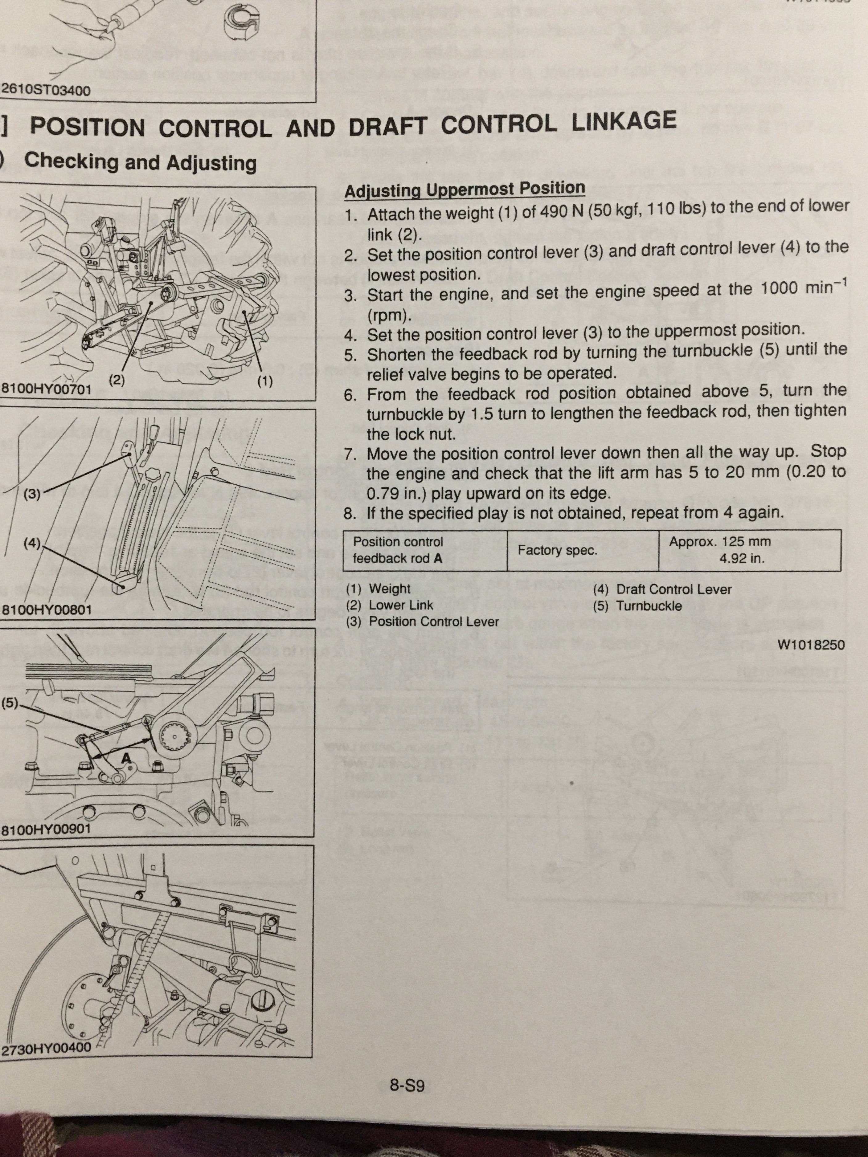

I have bigger M's but there is a linkage rod between the upper 3 point mount and the and the valving that has to be set properly or the implement will jump up and down. My WSM (as well as my owners manual) explains how to set it.

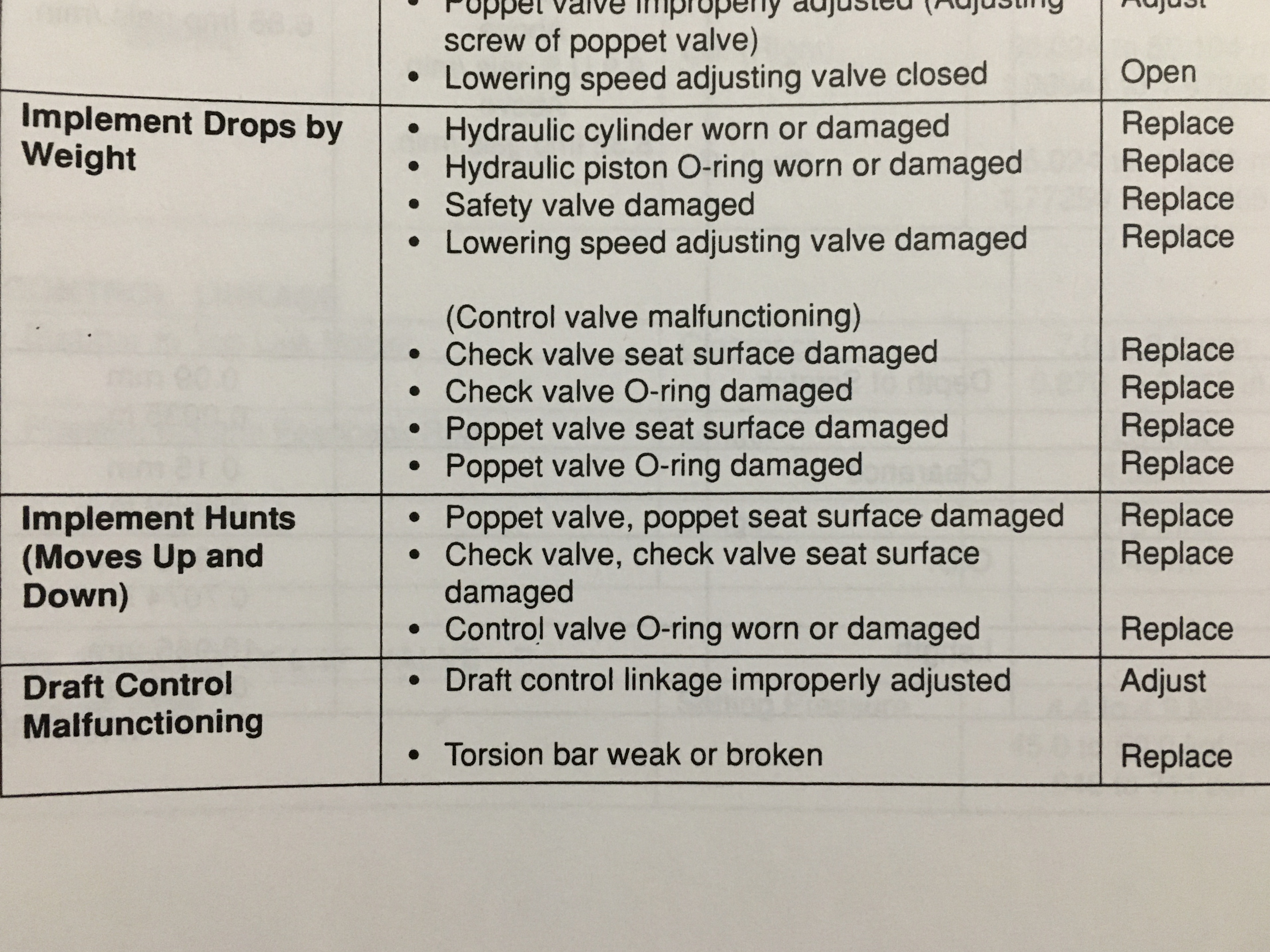

Just to clarify, are we talking about the same sort of jumping up and down? In my case, it slowly sinks down, and then quickly pops back up to the correct height. Each complete cycle takes about one second. I'm not trying to use the implement when this happens. The tractor is just carrying it. It kind of looks to me like the 3PH is leaking down, like it does when the engine is shut off, but the hydraulic pump keeps correcting the height.
My owner's manual doesn't say anything about this linkage. I do have the following section in the WSM:
The following section under troubleshooting seems relevant:
I was rather overwhelmed by the list of possibilities.
