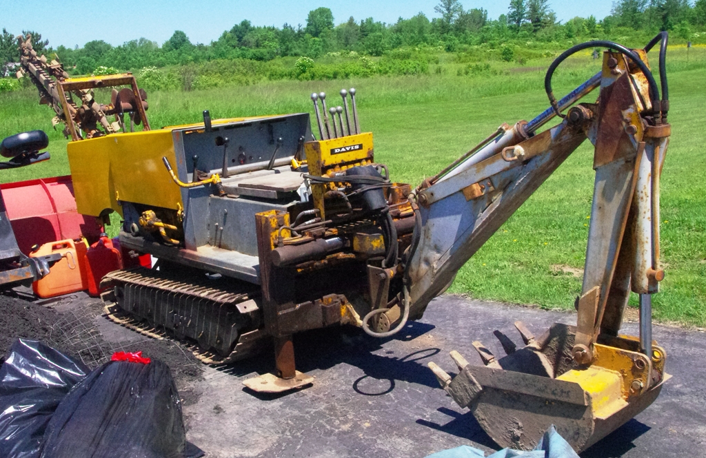

I got a reply back from knighthawk: "this pump was made for the OEM only"
No parts idea from them.
The engine is a Wisconsin THD, 18HP 3600 rpm.
The pump is direct drive off the engine.
I think my trencher is a TF500, Task Force 500 from Davis/Case.
I saw some posting for a TF300, which indicated "pump should be about 19 GPM @ 1800 PSI "
TF300 is similar, but I believe maybe a bit smaller..
I'll have to poke around some more.
I guess my plan will be to line up a "just in case replacement", and see about seal.
This also has a davis d100a backhoe attached to it ..
Its quite a versatile machine..
So I'd like to get it up to speed, so to speak.. :)'
