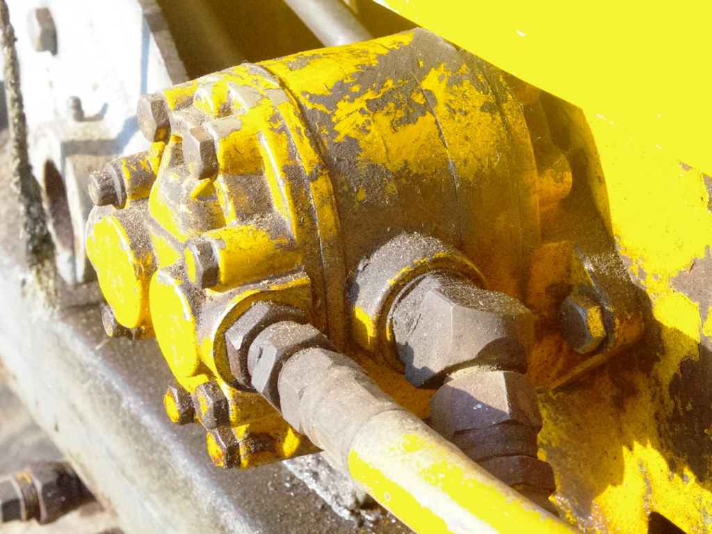

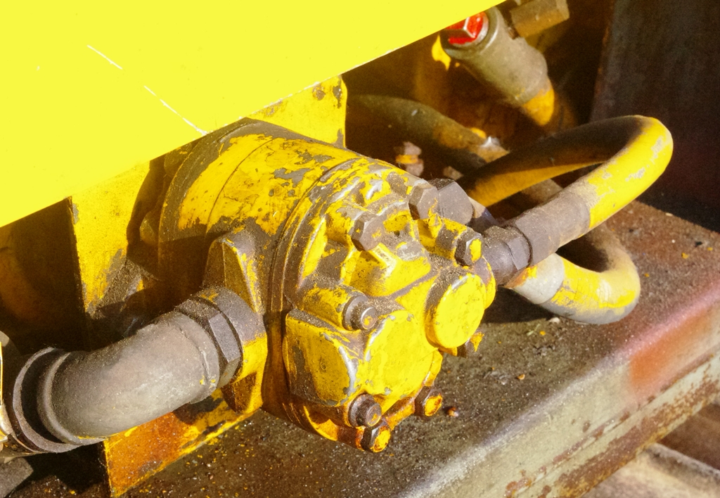

I have a leaky hydraulic pump on my old 1964 Davis trencher.
Looks like the front seal might be the problem.
Not sure of the pump mfg or model.
It develops pressure, isnt noisy.. just leaks..
Is the front seal replaceable (by me)..?
I have limited hydraulic experience.
I have rebulit engines, seals on gear boxes, etc.
Any idea on pump mfg?
Suggestions on place to get rebuild kit?

Looks like an old Cessna (Eaton) with a priority flow rear cover (the model code should be stamped on the mounting flange)
Seal is replaceable, you'll need to pull it apart to check out the wear plates on the inside, shaft and housing for wear

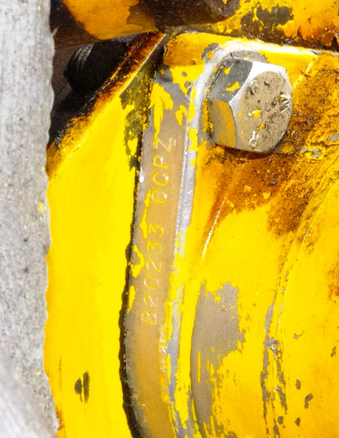

I removed some paint on flange and found the following part numbers: "B20233 0cpZ" & "4 52 rs"
I can't find any references to these numbers.. Any clues?
Dan

I believe those are Cessna / Eaton numbers. Eaton purchased Cessna years ago and this product could be considered obsolete. Like wdchyd said. Yes you can typically replace the shaft seal. Concern would be why is it leaking? Just wore out from age, shaft damaged, excessive wear on gear wear plates allowing excessive leakage which over pressurizes the seal, etc..
