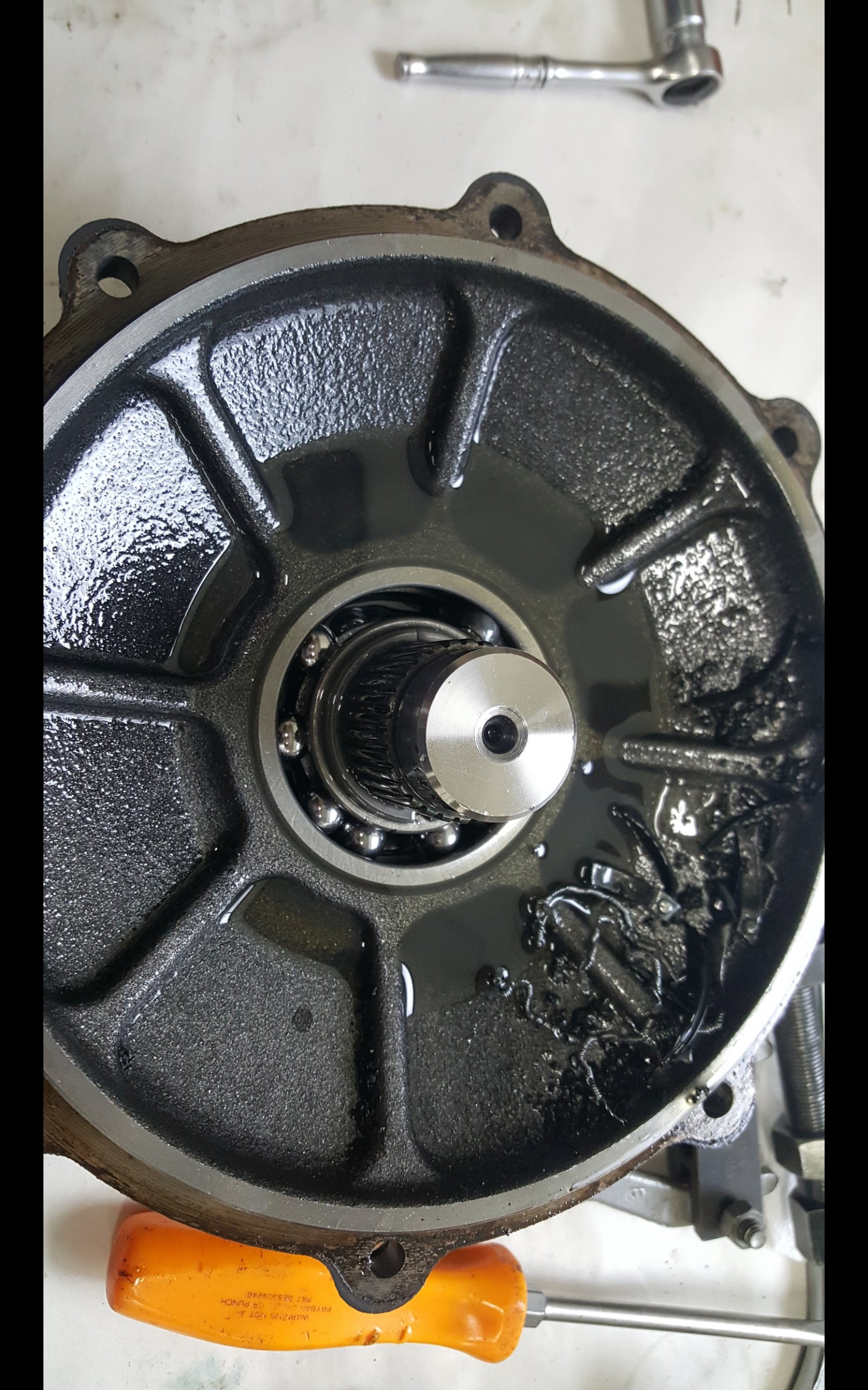

Right front on my Yanmar at around 1800hrs. I do a lot of FEL loader works at well, moving logs, saw mill slabs, lumber. Bearing retainer went, eating up seal. Fairly straight forward repair. $100 something in parts/fluid and couple hours. I did use a hydraulic press on the bearing (7) to press it into the case (1) and the spindle (3).

Left side began leaking couple months later. Ordered the same round of parts, and replaced while in there, but couldn't really find anything like the right side bearing. I DID remove a tight wound wad of round bale net wrap that had worked it's way around the hub shaft and I suspect into the seal, causing it to leak......
