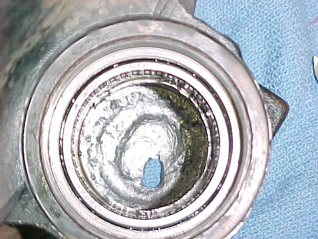

The more that gets cleaned up, the more there is to see. This is a shot of the manufacured "dish out" in the bottom of the casting (oval shaped). Of course, it all looks a little banged up, but if I can get the hole fixed, all may work OK.
If you look close at the picture in the post above, the "dish out" is shown in the drawing at the bottom of the semi-vertical spindle assembly (at the bottom of the housing between the printed letters L and M).

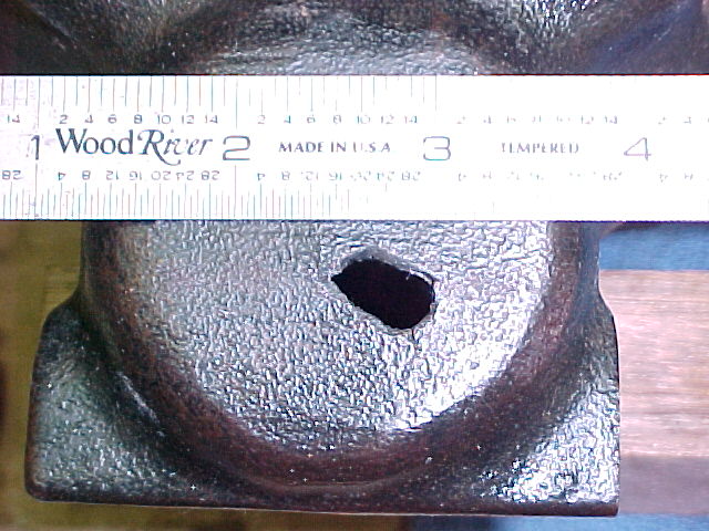

Is cast iron "all thread" a threaded cast iron rod? It's easy to find threaded steel, but I have never noticed threaded cast iron anywhere. Would a welding store have that? I have included a picture of the hole with ruler for perspective. That little ruler hasn't had such a workout in a long time. Do you think the hole is small enough just to go ahead with brazing? It is about 1/4" by 3/8".

   / Leak from Hole in front axle #48
Okie, I believe that brazing it would work just fine. If you have the race out, you should be able to sit is on a small piece of plate and start your braze from the inside if you have any trouble filling the hole. Then turn it over, knock the piece of metal off and finish from the outside. Be sure not to get a cold weld, it will leak. Getting that small area redhot will not affect the heavier metal around the race seat, Just don't get the whole area redhot.
Be sure to leave some room in the dish. The inner bearing and shaft needs a little room. Hope this helps you.

#49
Would you pre-heat the casting before brazing or maybe not necessary?
OkieG
   / Leak from Hole in front axle #50
Just heat the area you need to weld. It is fairly thin, so you should be able to keep the heat down to the other areas. It will warm up some but shouldn't cause any harm.
