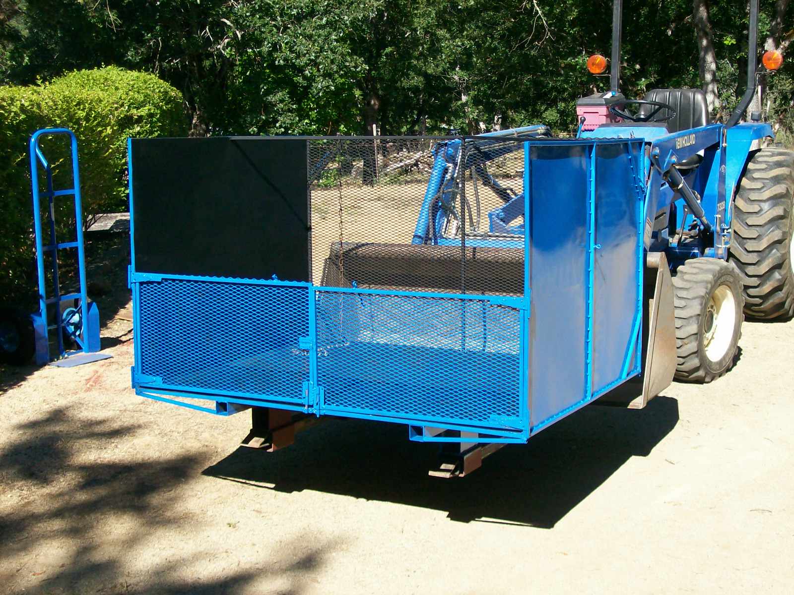

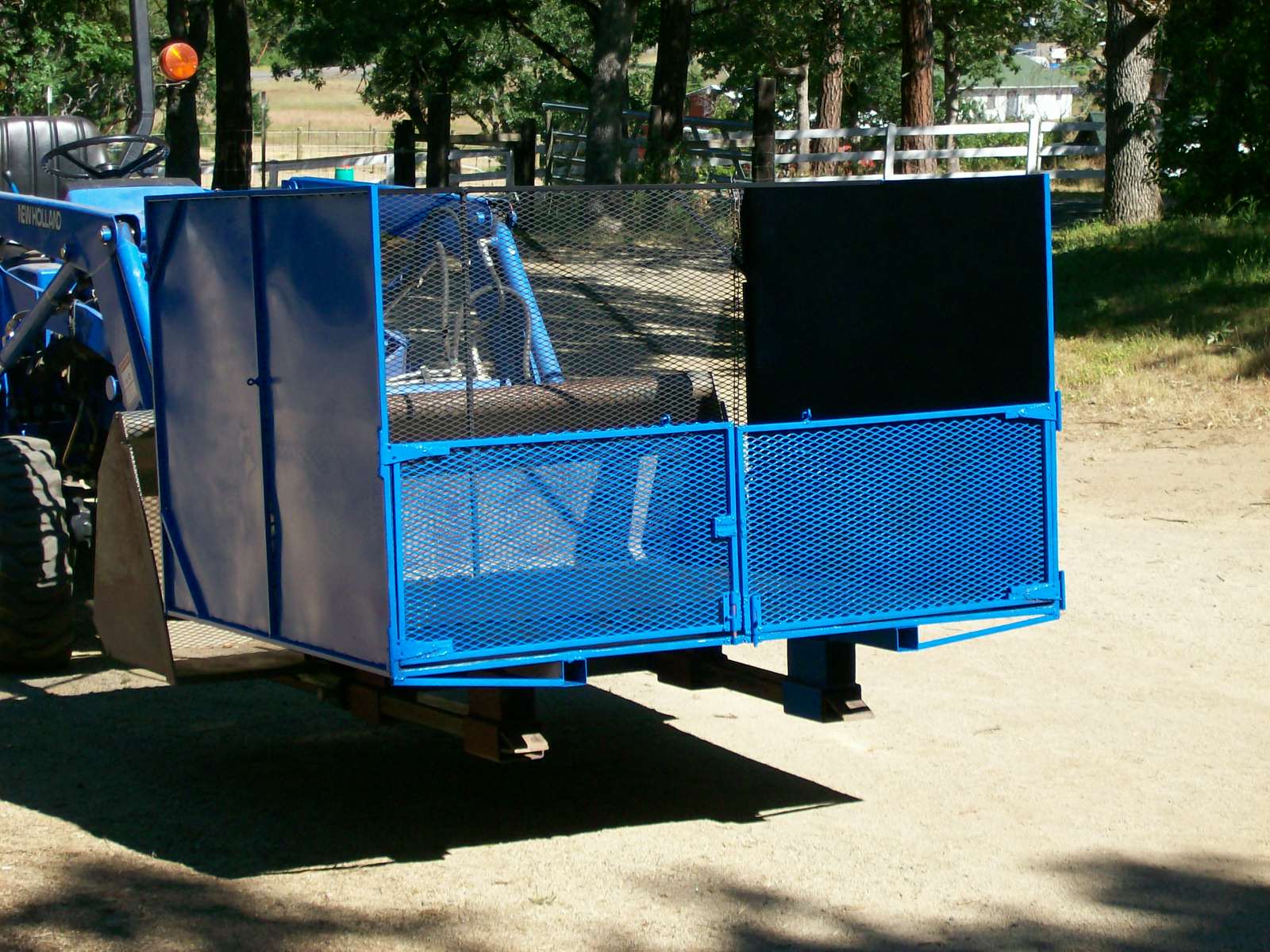

Here is the leaf bucket I built instead of the old one we had made out of a four way hardwood pallet , 2" x 4" 's and plywood .
It's made out of about 115' of 1/2" x 1/2" x .065 tubing , a little more than 1 sheet of 24 gauge , a sheet of flat expanded metal , and it sits on 2" x 2"
tubing which then sits on top of 3" x 4" tubing for the forks to slide in .
Old box , even with backhoe on , you knew it was there when you picked it up . This box , as seen it the pictures is like half the weight and with nothing on the back of tractor , does not feel like it is even there .
We have lot's of Oak tree's in yard around house , so in the fall , we usually end up picking up around 4 full pick-up loads , if not more . Wheel barrow really sucks and FEL bucket is only slightly better , but this is slightly larger than old wooden box so should do a decent job .
Fred H.

Nice job ! That should be just the ticket this fall .:thumbsup:
   / Leaf Bucket #3
Looks great, with those swinging gates you could really load it up.

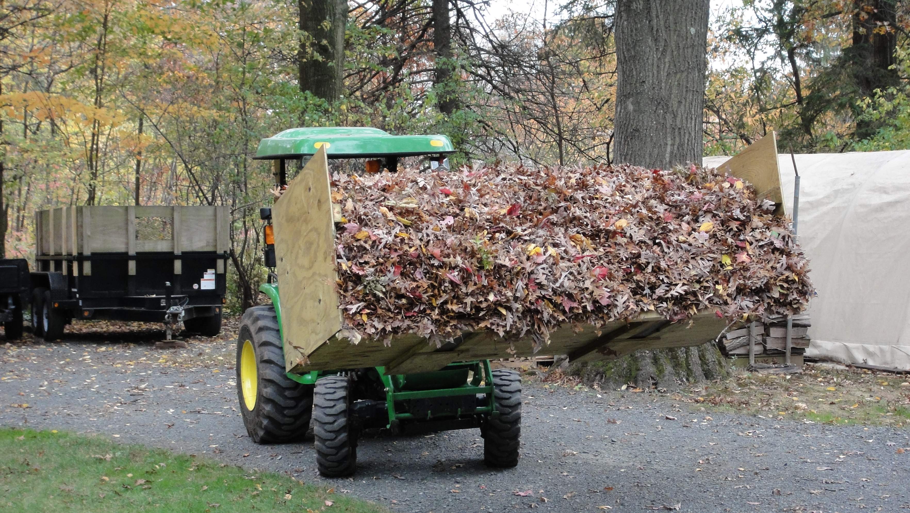

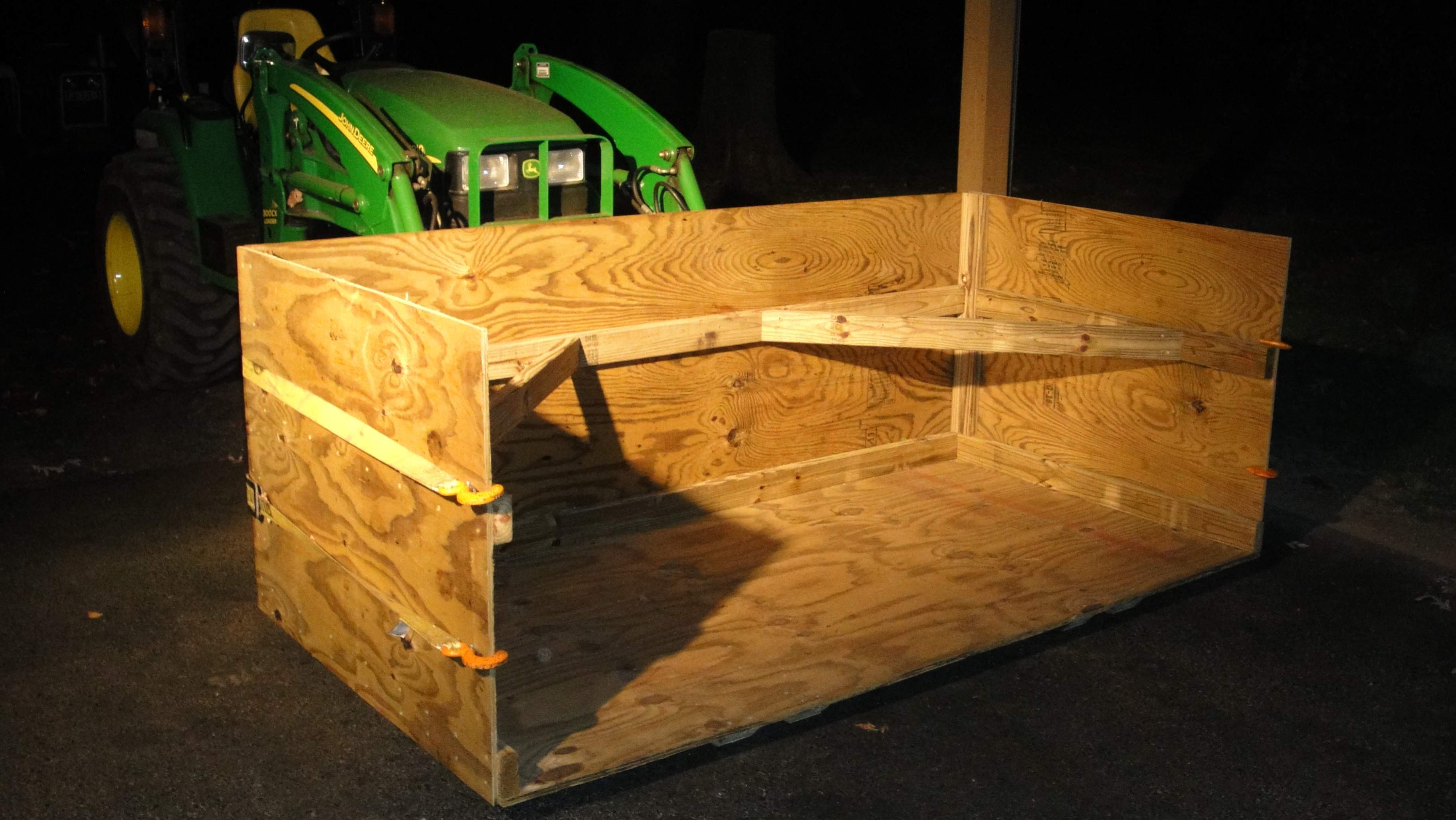

I just made a wood leaf box last year, to limit the amount of times I have to handle them. We also have alot of large oaks, we have town pick up at the curb, I use to load up a trailer then bring it down to the street and unload it.
Now I just load the box and dump it at the curb, much less work. I might do the closing door idea like yours.
I made mine to work with my forks, at first I used straps to hold it on, but now I bolt it right to the fork frame, very solid and stable.
JB.

Your wood box is similar to the one I had except I made the mistake of building mine on a 4 way hardwood pallet .:(
A typical pallet weighs in around 65 to 70 pounds , but the hardwood one's are ??? pounds more . So on my tc30 , even with the backhoe on , there was a lot of weight out front before any thing was added . Although I was comfortable on it , my better half always felt uneasy traveling or dumping . Now with the expanded metal in front gates and back panel , at least she will know " What " she is going to hit before she actually hits it . :thumbsup:
Fred H.
P.S. If you look close at the doors , the one on the right sags . Was not a positioning of hinge error , rather it was a error in heat setting on welder when putting hinges on . Hinges had rubber or plastic inserts around the pins . Well the top hinge has a little less insert as it kind of bubble / dripped out .:ashamed:
