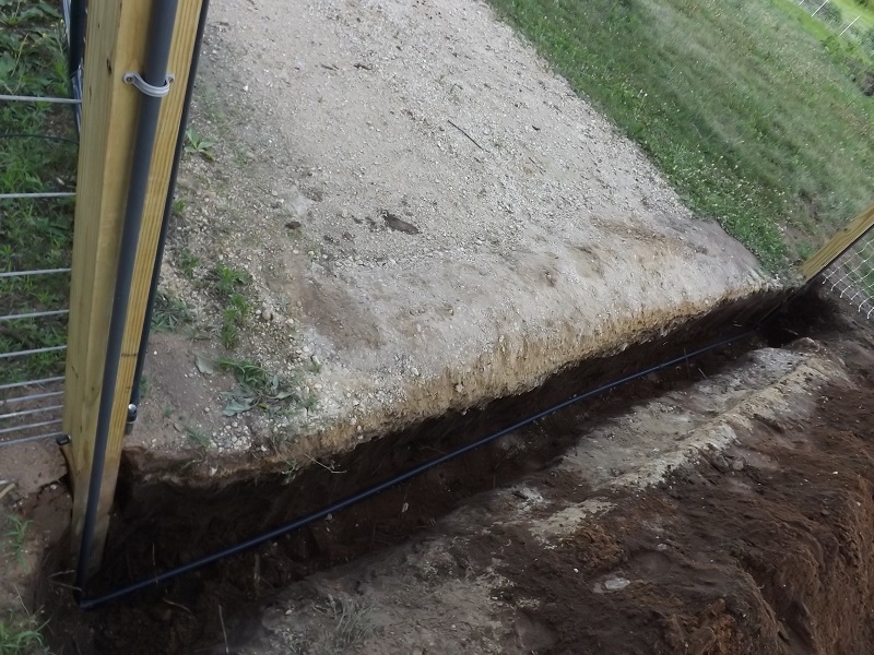

Does he own a tractor with a straight blade? I pawed and pawed the top several inches of gravel back, then used the garden walk-behind tiller to loosen the rest up, got down 24-inches in depth. Got the thickest wall PVC electrical pipe for the wire laid it all in the bottom, carefully got the soil back in, the rocks and then the gravel.
The electrical keeps working after 6 years.

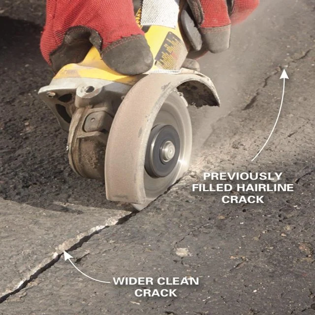

I did this too for FIL. He had a long driveway with asphalt. We cut 16-inches wide, removed the asphalt. Then carefully went at it removing everything 24-inches down. Ran the electrical conduit. Wired in all of his driveway lights, pond lights and landscaping lights.

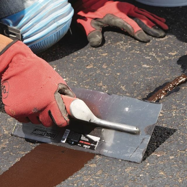

Placed all the soil & stone back. Then packed and pack and pack for about 30mins. Layered in hot-patch for the asphalt gap. You will need metal hand trowels to work it in and level it too. No humps nor bumps.
Ryobi angle grinder with diamond wheel.
sort of like the trowling tool used.
