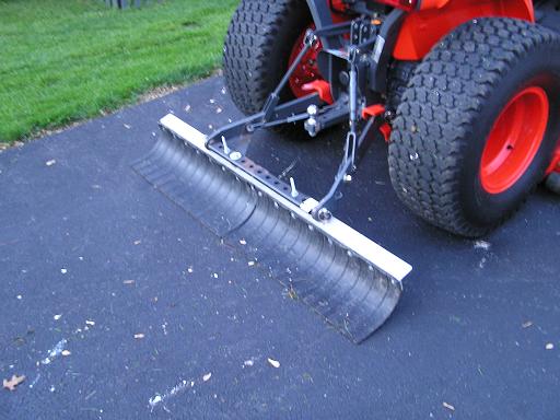

Ok, The lawn striper project is complete!
I finished collecting the components and cut the PVC bushings to size.
I'll post some pictures after my grass comes in. I know...cart before the horse!

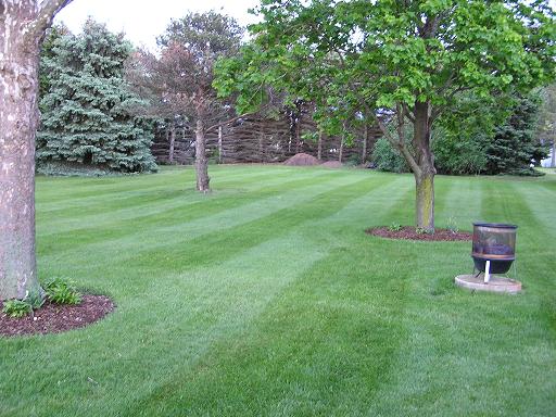

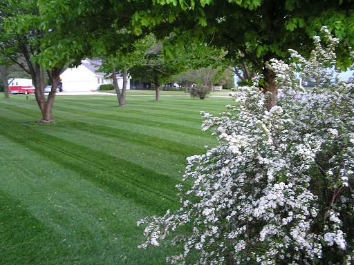

Well, Today was the first cut with the striping roller and I think it turned out OK. It is a little bit of a pain to have to lift it at the end of every row, but once I did it a few times it became second nature. If I were to build this project again, I would use something a little heavier than 16ga sheet metal for the plates - although it does make it quite easy to fix things if they get a little bent up.
