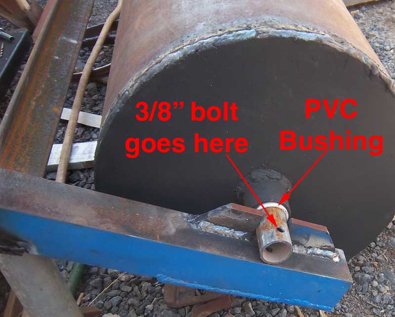

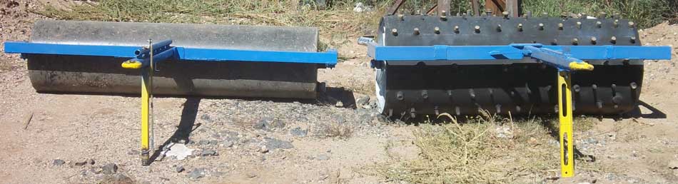

I did a complete build on a roller & compactor. don't remember the name of the thread. About 2 years ago. Think if you go to search & type in roller or sheeps foot it should come up. It can be filled with water for added weight & emptied for transport
Here are a couple of pictures.

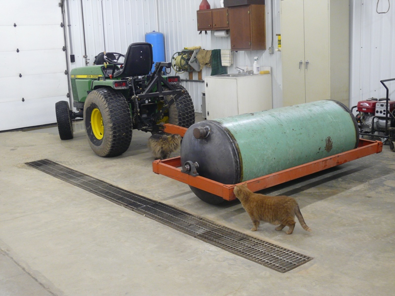

Lifting a roller with enough weight to do much good is impractical. Rounded ends like on a propane tank will keep dig in to a min men.
I made one for a friend out of a 30 gal. propane tank, filled with sand for extra weight & water could also be added. Those tanks are a little thin if you have a lot of rocks & will dent up, but still work fine.
For sharp turns pushing is much better than pulling. I push mine most of the time. Pushing takes a little practice & getting use too.

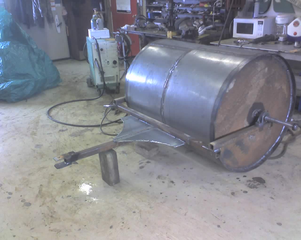

We built this one a few years back. Actually heavy enough to do some good. Also good for compacting gravel before concrete is poured, and for packing earth when doing dirt work. It weighs ~600# empty, and is 38" diameter and 4' wide. It can hold about 1900# of water. There are times it would be nice if it weighed more. There is no way you would lift a 2500# roller with a B2920. Even half that would be a struggle. Not sure what the intended uses are, so without knowing that, I cannot offer any more advise.

Did you have those cylinders rolled (or do it yourself) or did you use something existing?
They were rolled. It was a full 4x10 sheet of steel. But they could only roll 3', so had them shear it in half and roll 2 sections.
