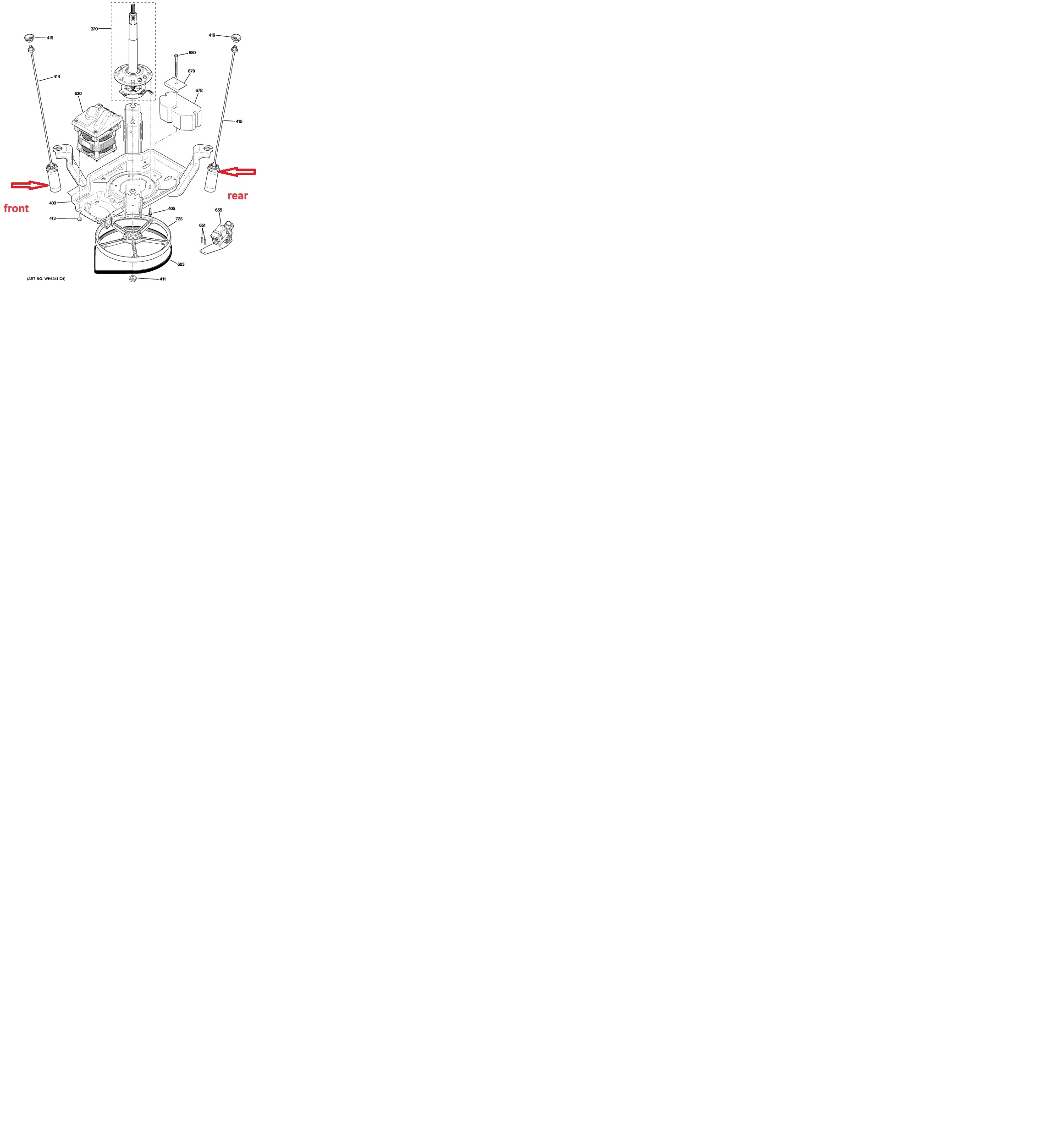

We've a fairly nice GE washer (large stainless tub, more settings than I can shake a stick at) that started making a racket on the rinse and spin cycle. Seems like the suspension is going. A quick check online shows that replacing the shocks is easy, but the parts alone are about $200 for all 4 "shocks".
Seems like a careful application of lubricant might work. The rods are metal, the cylinders are some sort of plastic.
Any suggestions for a grease to "dribble" on the shaft?

I would try silicone lube, as the plastic is not likely to respond well to hydrocarbons, especially if there is a gasket or o-ring inside.
FWIW: The suspension item is more like a gas dampener on the models that I have taken apart. A plunger goes up and down inside a cylinder. Your "fairly nice" model may be fancier, and actually be a mini shock absorber.

Don't order anything till you take it apart and see what the real problem is. It could be something entirely else. I've been down this rabbit hole of thinking that I found a solution on the internet, only to find later, after taking it apart, that the issue had nothing to do with any of the suggested fixes. For instance you might have rotted spokes on the bottom wheel or a broken rivet to the drum.
/ Laundry - GE washer suspension fix needed
I've taken the front off and sat through 3 cycles. My wife described it as squeaking.
What I found was a grinding noise timed with the motion of shock. Further surfing indicated lubrication may not help, but there may be a way to put a shim into the shock.
SWMBO's preferred replacement would be a Speed Queen (> $1,000) so $200 for parts would not be too bad, unless I have to replace some other aged part on the washer soon.

If it is just a squeak, I would try the lubricant. I had a vibration issue in a previous washer that turned out to be a worn seal, that probably damaged a bearing, and broken drum / axle fasteners. It's anyone's guess on what the order of failures were.

They have inexpensive $100 or less for 4 replacement suspension spring assemblies on Amazon.
I would say if you can get a clone/replacement for under $100 for 4, go for it.
But $200 seems like a lot when the problem could be the drum bearing etc as others have indicated.

Our last washer had the shocks go bad so I replaced them. Then the drum mount broke so I had to buy a new washer. A couple years after I bought it the darn thing started making the same banging sound that the previous washer was making. I was mad that a two year old washer needed shocks already but I bought a set for about 60 bucks. When they arrived I took the washer apart and it wasn't bad shocks. It was bad assembly. A bracket that holds a valve had come loose and the drum was banging into it. I put it back securely and still have 4 new shocks sitting on a shelf. So I would advise making quite sure it is the shocks making the noise before buying new ones.

They seem to have a ton of the assemblies for whirlpool, maytag, etc. all for about $100 for 4, but I only found 1 on Amazon for GE, at ~$100 for all 4. And again, I opened up the washer and can see that it is the spring making noise.
But I can't predict what MAY fail next, and when.
I read in your previous post about the item making noise. It seems that you determined the part making the noise was because it was in time with the drum movement. Of course whatever is making the noise is going to be in time with the drum movement. But that doesn't necessarily mean that whatever you are looking at is the thing making the noise. You are probably right though. Still, it may be a good idea to try to isolate the noise with a tube running from your ear to the part in question. Please understand I'm not trying to say you are wrong, because you probably aren't. I'm just trying to save you some money in case you are.
