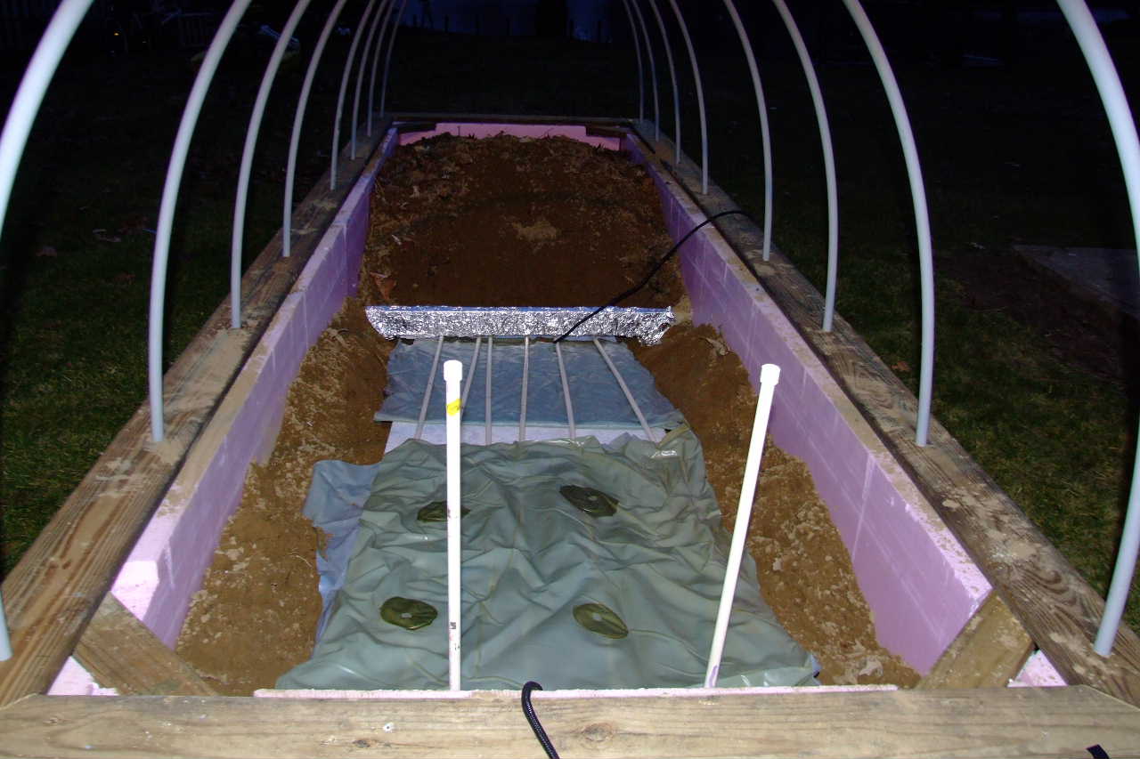

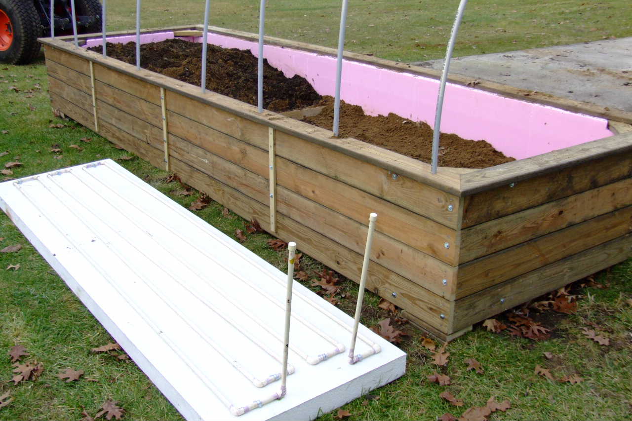

The Raised Bed Planter/Greenhouse/Cold Frame/Hot Bed/Hoophouse update.
I have been researching all the good suggestions. The planter box has been lined with 3" foam insulation acquired from a construction job surplus sale. I'm working jointly on the waterbed electric heating pad and the electric water heater options. The 'infrastructure' is mounted on a 3" aluminum clad foam scrap(see pictures) and will be buried under the surface of the soil to radiate heat upwards. The waterbed heating pad is enroute and will also be mounted flat on the 'infrastructure' piece. This keeps both options open for future development.
All comments/suggestions are welcome....
Don

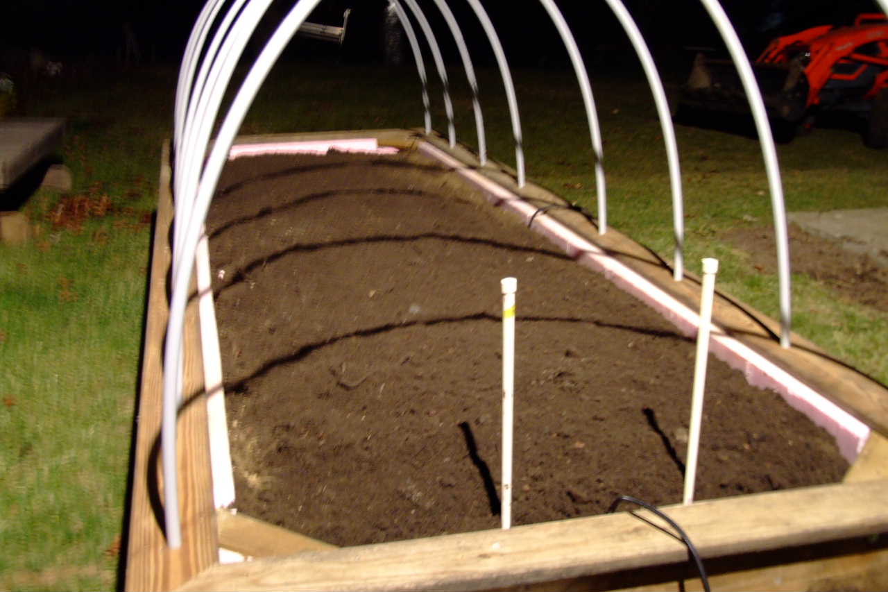

Today the waterbed heating mats arrived. It's getting dark by 5 p.m. and there's rain predicted this evening :( and all day tomorrow and with s-n-o-w :eek: predicted for the following day, there's no time to spare.
The large white piece of 'infrastructure' was installed in its permanent place and then the two waterbed heater pads were laid in place. I used an old waterbed-bag to slide over the heating pads for some additional protection.
Don

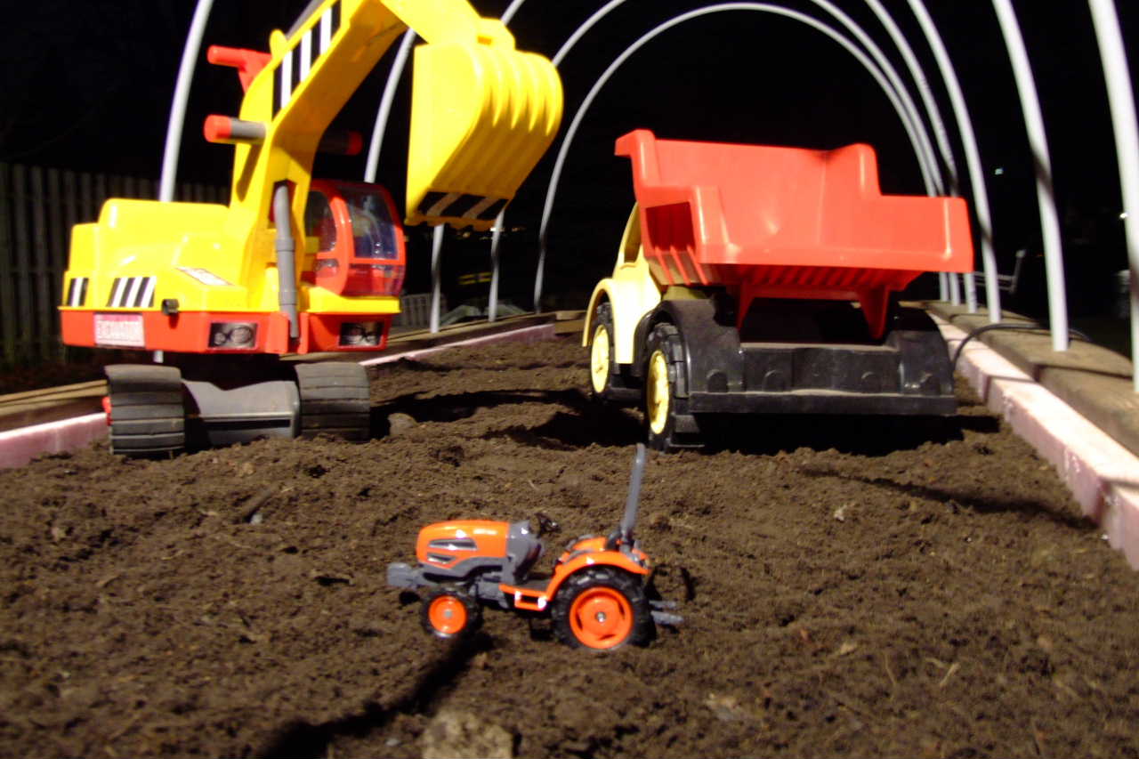

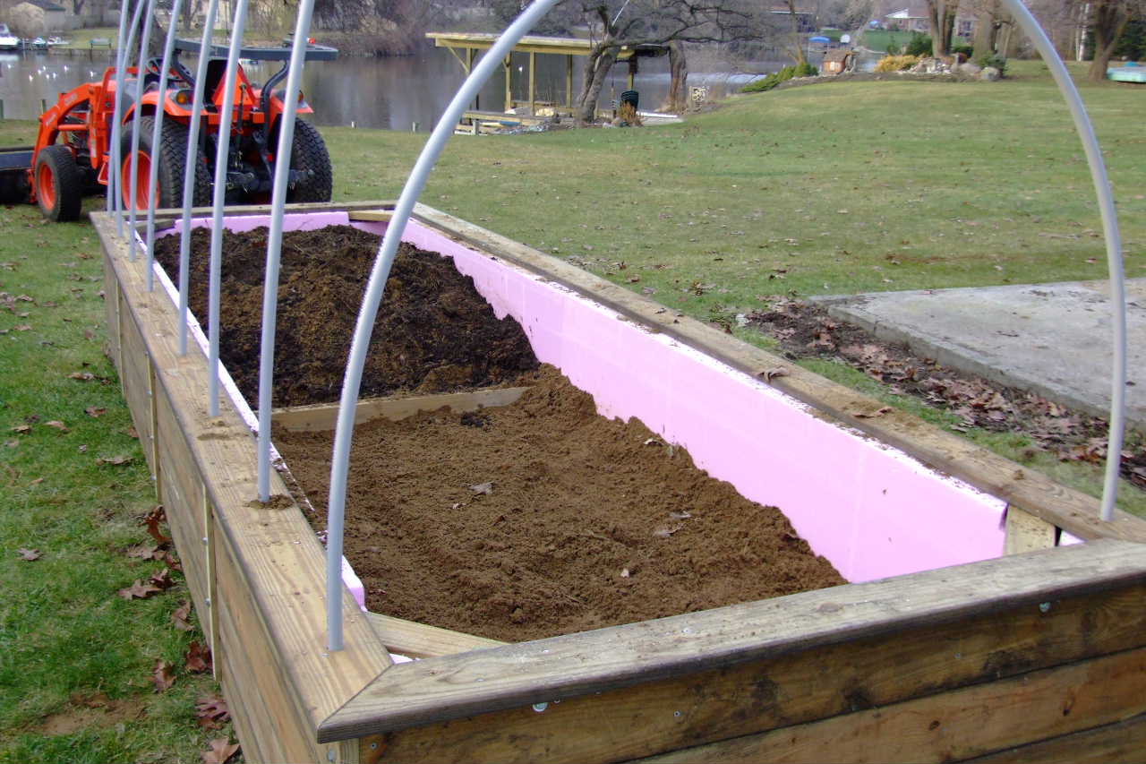

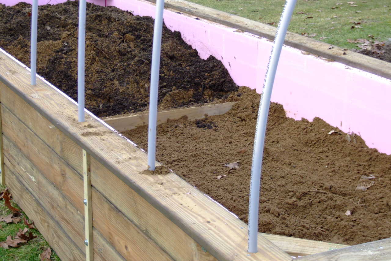

With a rain storm moving in from the west and darkness upon us, I called in some heavy equipment to move dirt from the compost area to the planter bed. The top soil I used was from this summers grass clipping harvest........and now it's rich black gold.:D
The first picture is the heavy equipment doin' their 'thing'. I parked my tractor in front for size comparison. :p
The second picture is the finished product.:)
Don

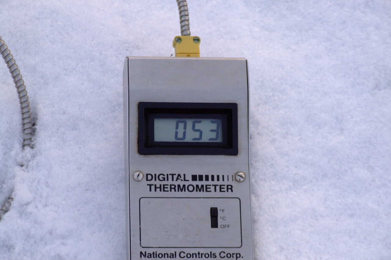

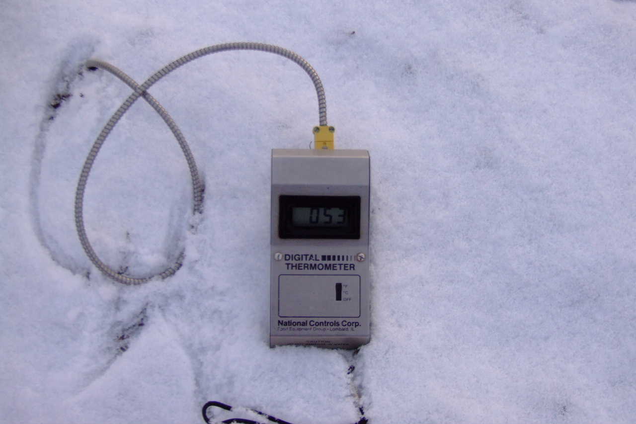

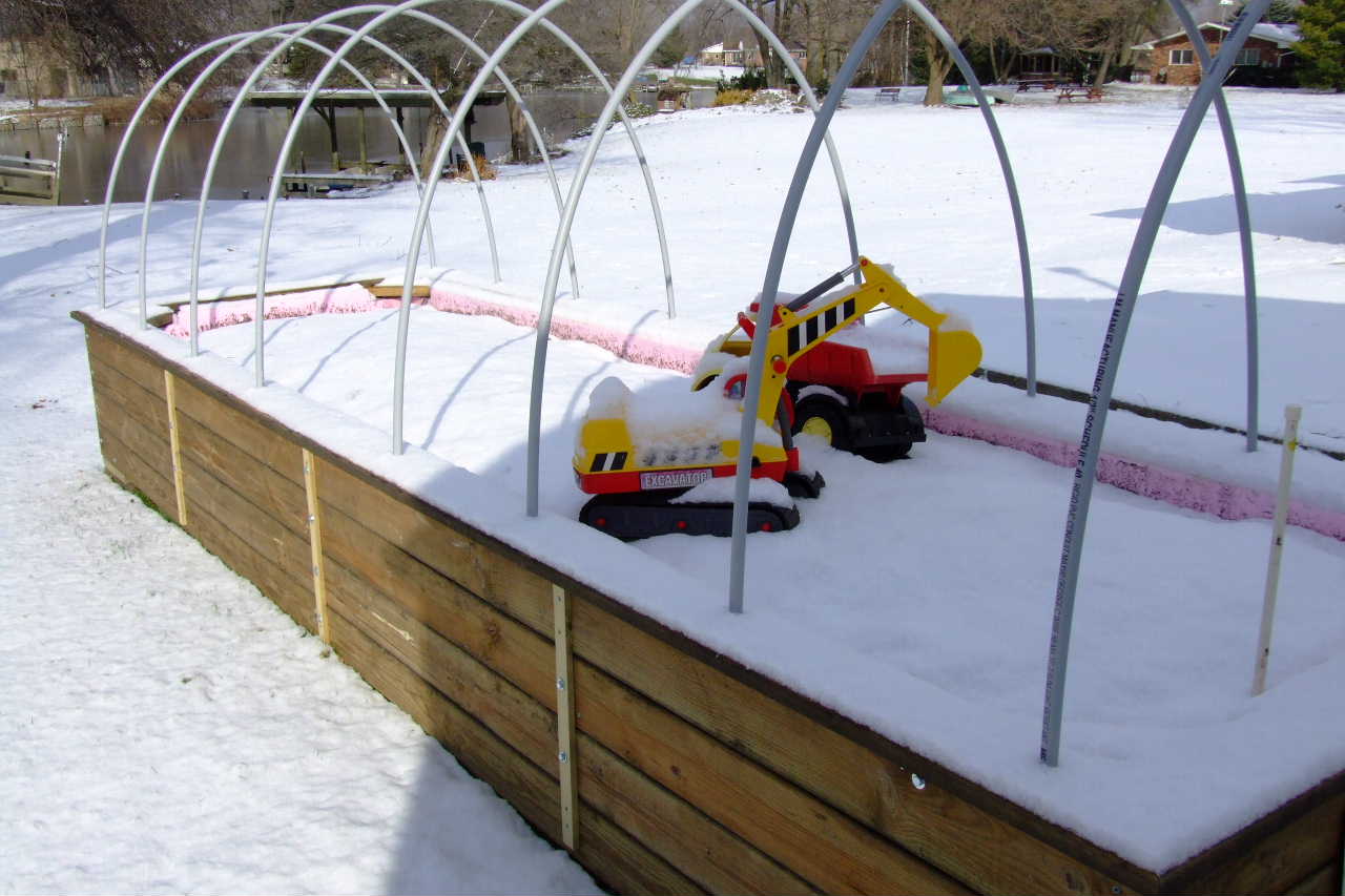

Last night we received 2"-3" of snow. Thought this would be a good opportunity to test the heating mats. Remember there are two heating mats. I'm testing one mat at a time. I used a thermometer with a long probe (about 8") and plugged it into soil. After one hour the core temp was 34-35 degrees Fahrenheit. I'm testing the deeper of the two heating mats first.
I borrowed the heavy equipment from a neighbor who's not in any hurry to have it returned, so it's still here for my use. :D Using metal pipe for increased heat transfer is a good idea. I'll remember that the next time I take the dirt out. :eek:
I set the heating mat on 'low', after 5 hours the core temperature has risen to over 50 degrees (F) :cool: ....see pictures. More later as the temperature rises....
