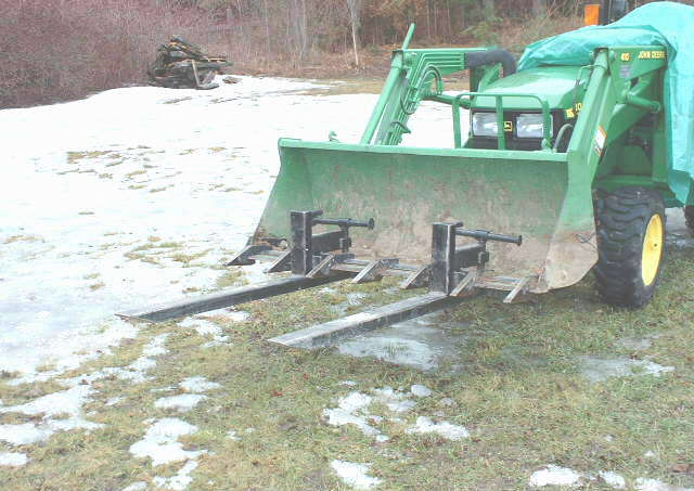

O.k. I want a toothbar and probably am going to buy it from Carver, but just one more qustion. Any of you with toothbars also use detachable forks? Can the forks be installed without removing the toothbar? I gather that removing a toothbar isn't that big of a deal, but I would like to avoid that if possible. Thanks.

John, since my forks are a home made version, yes, I use them without removing the toothbar. I don't remember what kind of forks you have, but if they're like Harv's forks, I think you can use them without removing the toothbar.
/ Last toothbar question? . . . nah #3
Fishman,
It all works together with the equipment I have. Here's a pic showing them together on the tractor.
There's 7 1/2" between teeth on the toothbar and the clamp on forks are only 6" at their widest point. As for the depth, the screw to tighten the forks is 10" back from the bucket edge and the back edge of toothbar when attached is 7" in from the cutting edge.

I have both the Long toothbar and the Long bolt-on cutting edge which I bought from Carver. I also have a pair of ATI bolt-on bucket forks which I bought from a local dealer. I have to remove the toothbar/edge to put on the forks. The moral is something like "Measure twice, cuss once."
If you do buy clamp on forks they will probably come with paint on the screw threads. Make sure you get every bit of this off with paint stripper or the insides of the nuts which the threaded rod goes though will get gunked up. I didn't do this before first use and they were a bear to get on and off.

Blurrybill, if JD's loader forks are what you need by all means go for it. There are TBN members who have mentioned having them. I feel that setup is definitely the superior choice for maximum height overhead lifting.
There are some cautions one should take when using clamp on forks. The further the load extends out beyond the pivot pin the more the max. load rating decreases. The JD loader operator's manual can supply all the different lift point ratings.
Also you have to be extra careful that something like a log won't roll out and over the back of the bucket.
A situation like that can easily happen when you least expect it. /w3tcompact/icons/shocked.gif
Originally I was willing to purchase the quick tach JD forks but was erroneously told that they weren't available for the 4100. So that led me to search alternative choices and the decision to go with the clamp on style at that time.
If you haven't already read it, this thread <A target="_blank" HREF=http://www.tractorbynet.com/cgi-bin/compact/showflat.pl?Cat=&Board=implement&Number=57452&page=&view=&sb=&o=&fpart=all&vc=1>Comparison Test--Attachable Loader Forks</A> originated by Glennmac covers just about all the currently available choices and discusses many of the pro's and cons of each type.
The clamp-on forks I have came from <A target="_blank" HREF=http://www.ringohill.com>http://www.ringohill.com</A> and run a little less than half the price of the JD forklift attachment. They are rated @ 2000 lbs lift cap. Plenty strong enough for the power of a 430 loader. Kinda an overkill for a 410 loader but that was the only size available. Lightweight, they handle easily and are quick to use. I like 'em.
