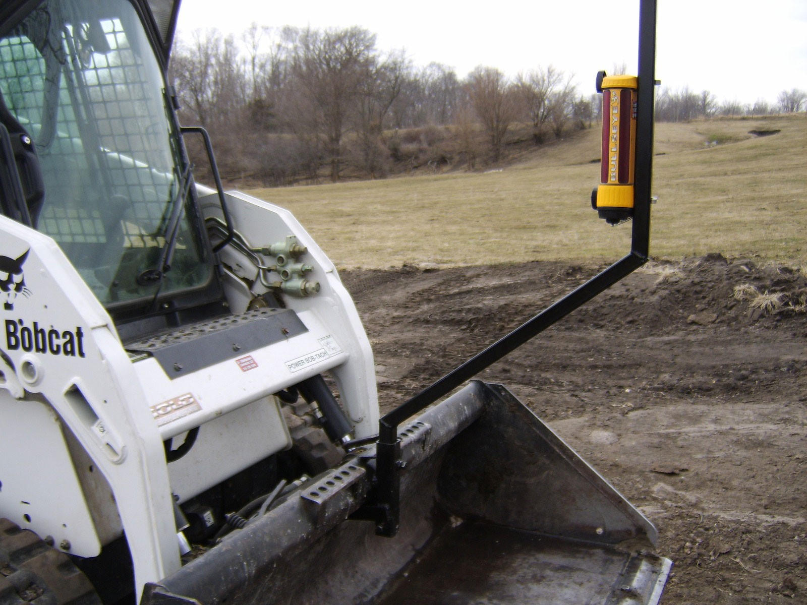

I'm going to weld up a removable laser receiver mast for my CTL similar to this. Mine will differ slightly since I will be welding the bracket to the back of the bucket.
There's a complete description of what's needed here SKID STEER BUCKET MOUNTING. Basically it's a 1.5" square tube for the mast and a 2" tube for the welded on bracket.

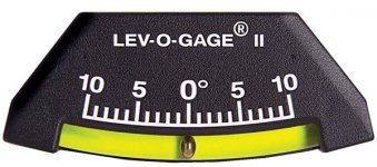

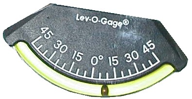

How about just having the receiver mount plate pivot? Leave the mast fixed.
Put a Lev-O-Gauge on the plate, while parked level, set the angle needed, tighten the plate then tilt the blade until it reads zero.

Xfax, your plate idea is right on track. Hadn't even thought to make adjustments from the other end of the mast. Nice and simple.
The receiver clamps directly to 1.5" square or round tubing, but it should be easy enough to bolt a swivel plate onto the tubing that has it's own piece of tubing welded onto it. I could then adjust plumb as I move lower into the cut. I'm sure it will take some experimentation to get things just the way I want them.
