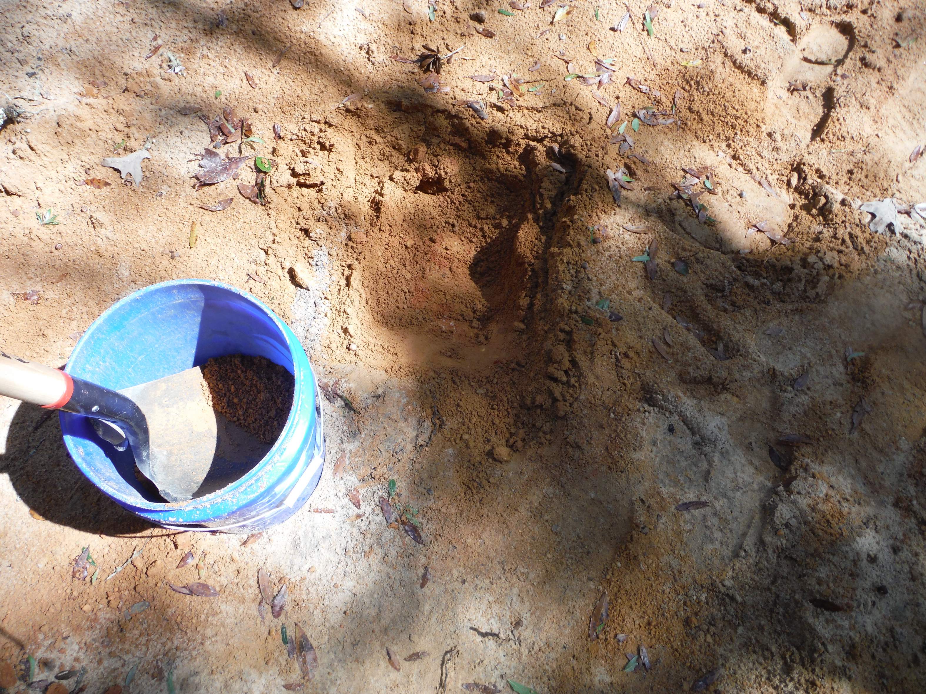

I spent most of the day here around the house. But I did get down to the camp right before dark and got in a little shoveling, including harvesting some clay for making cob. If all goes well, I might use it to make a chimney for my fox stove tomorrow.

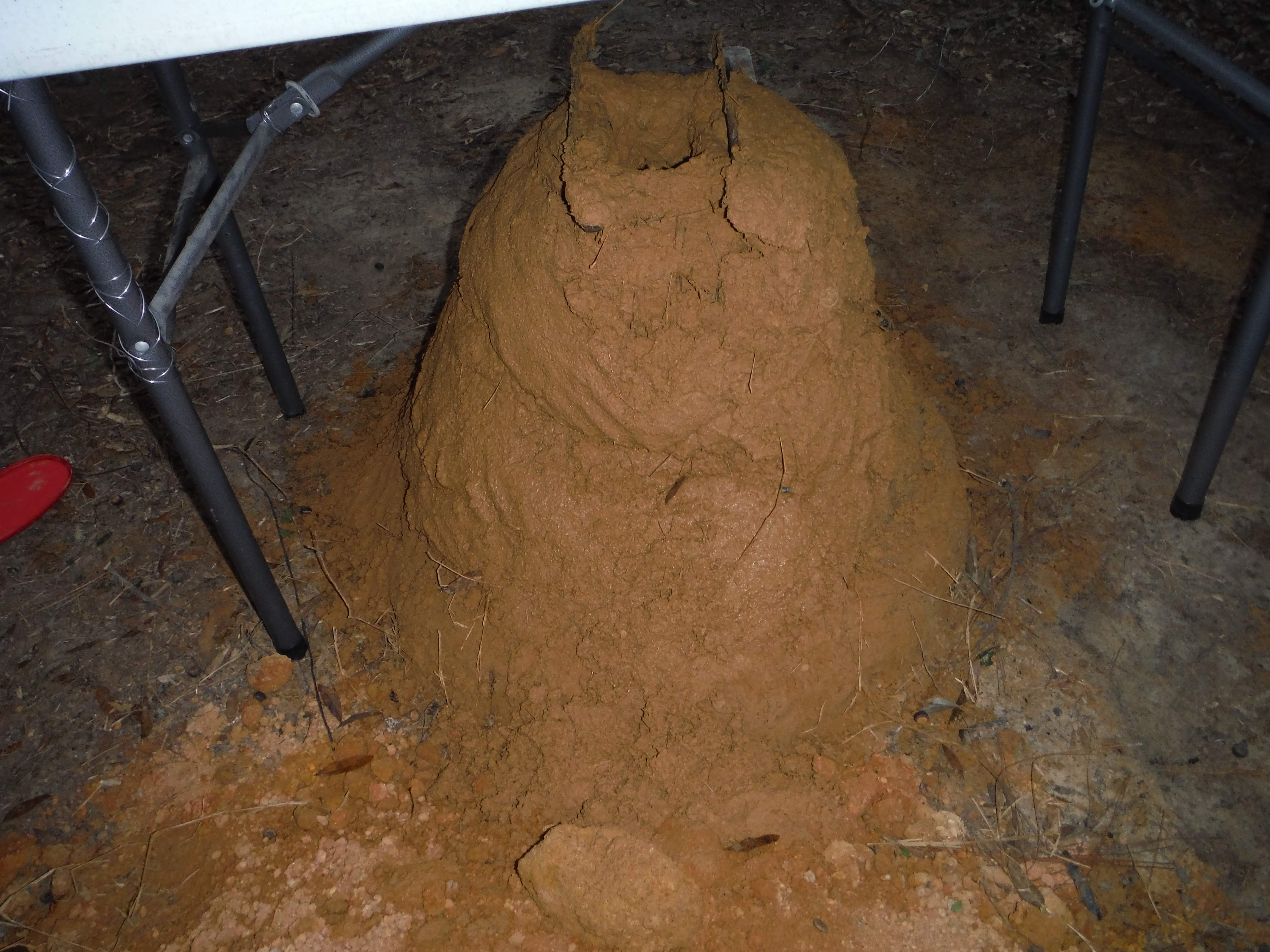

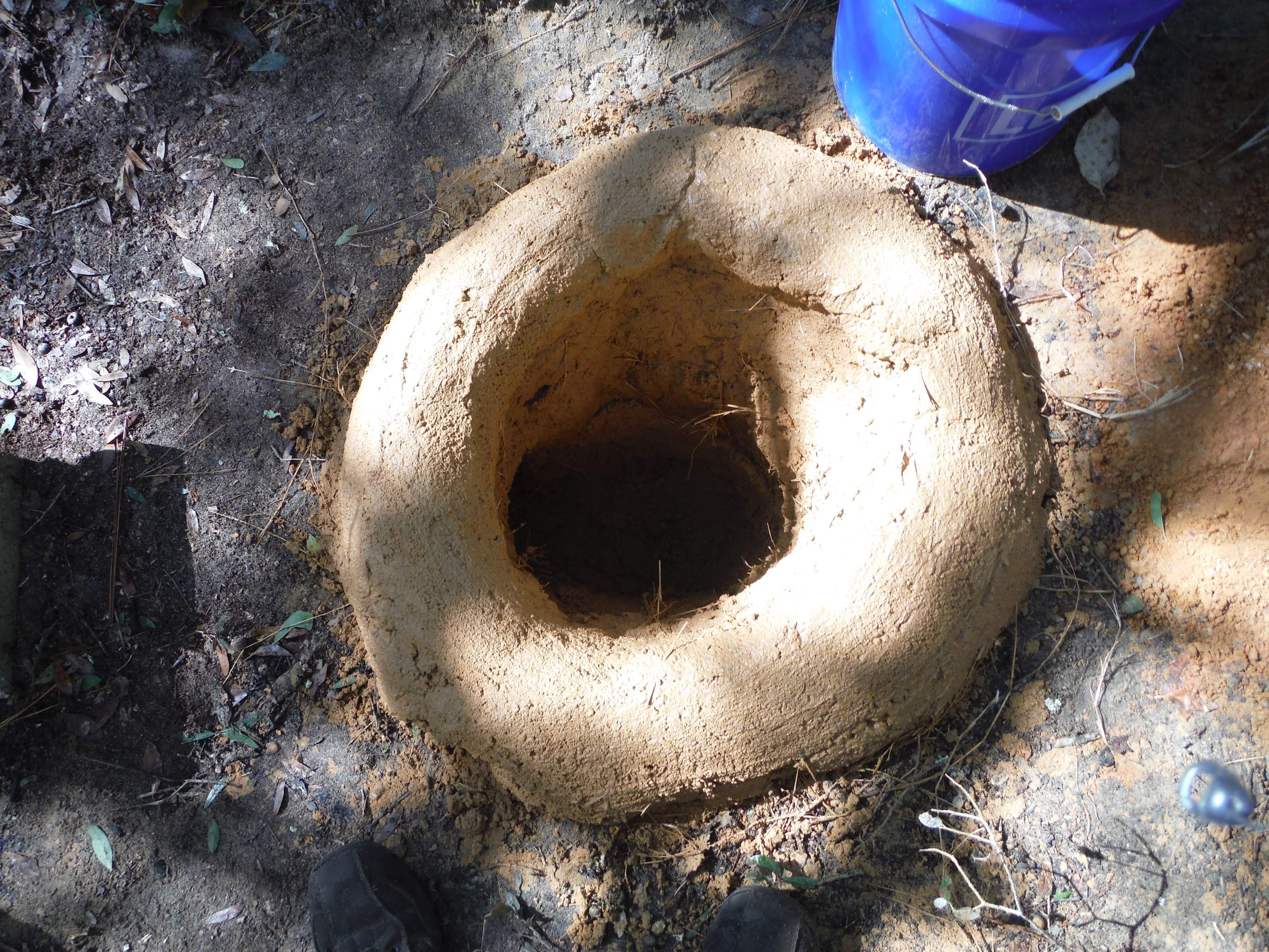

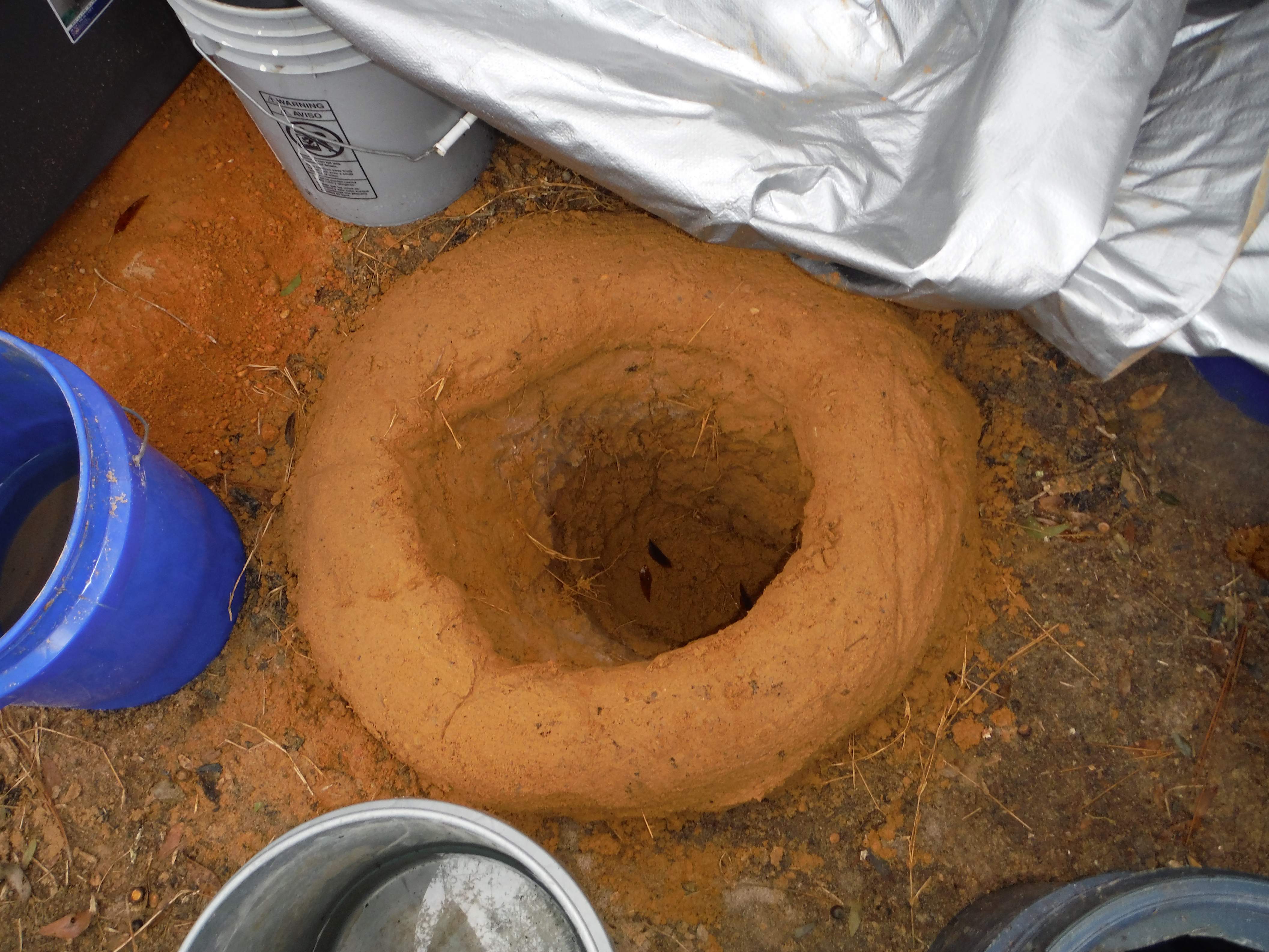

Today I turned my fire hole into a Fox stove. {or Badger stove, according to where you're at} I guess I could call it a Gopher stove:eek:

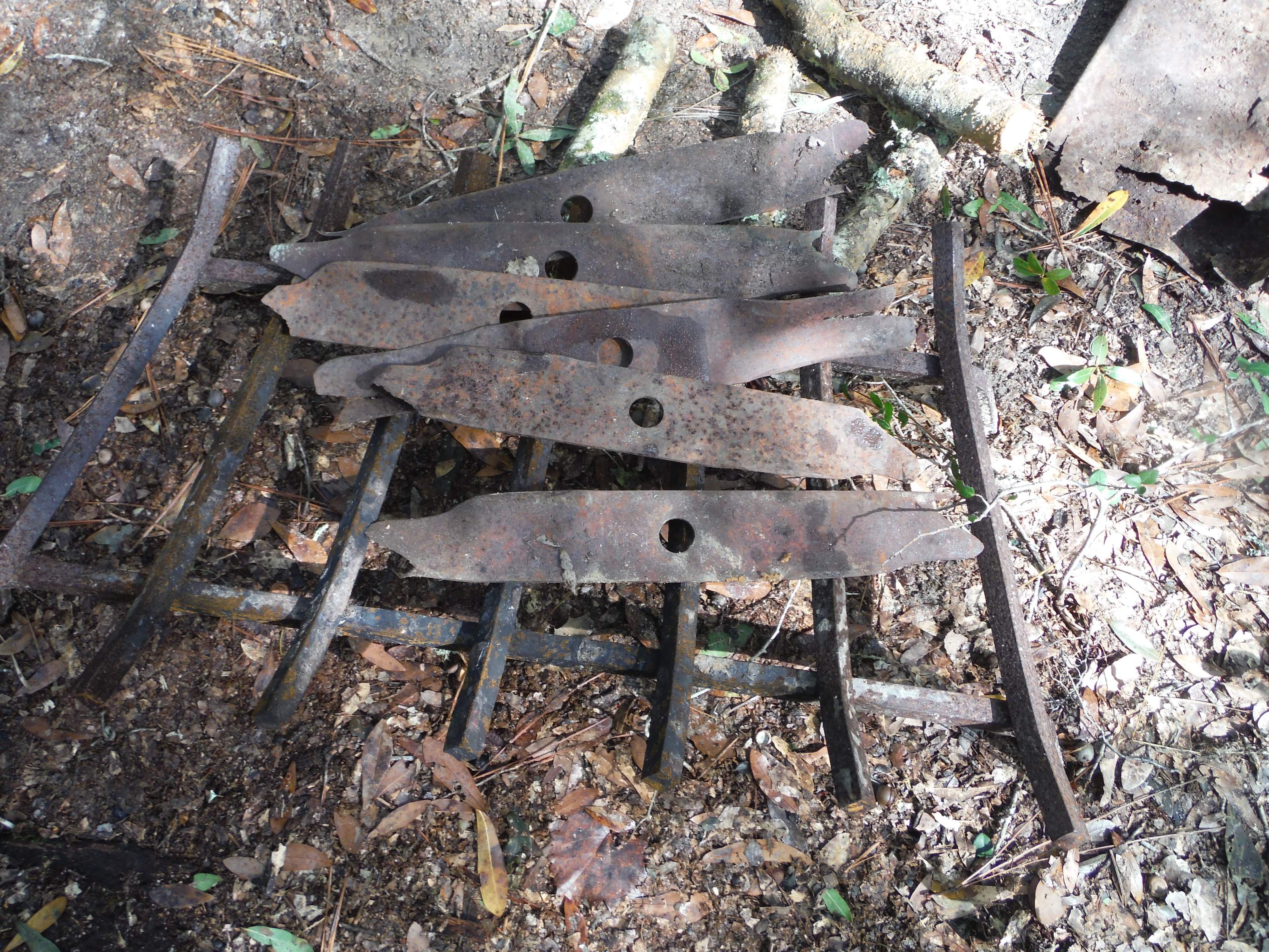

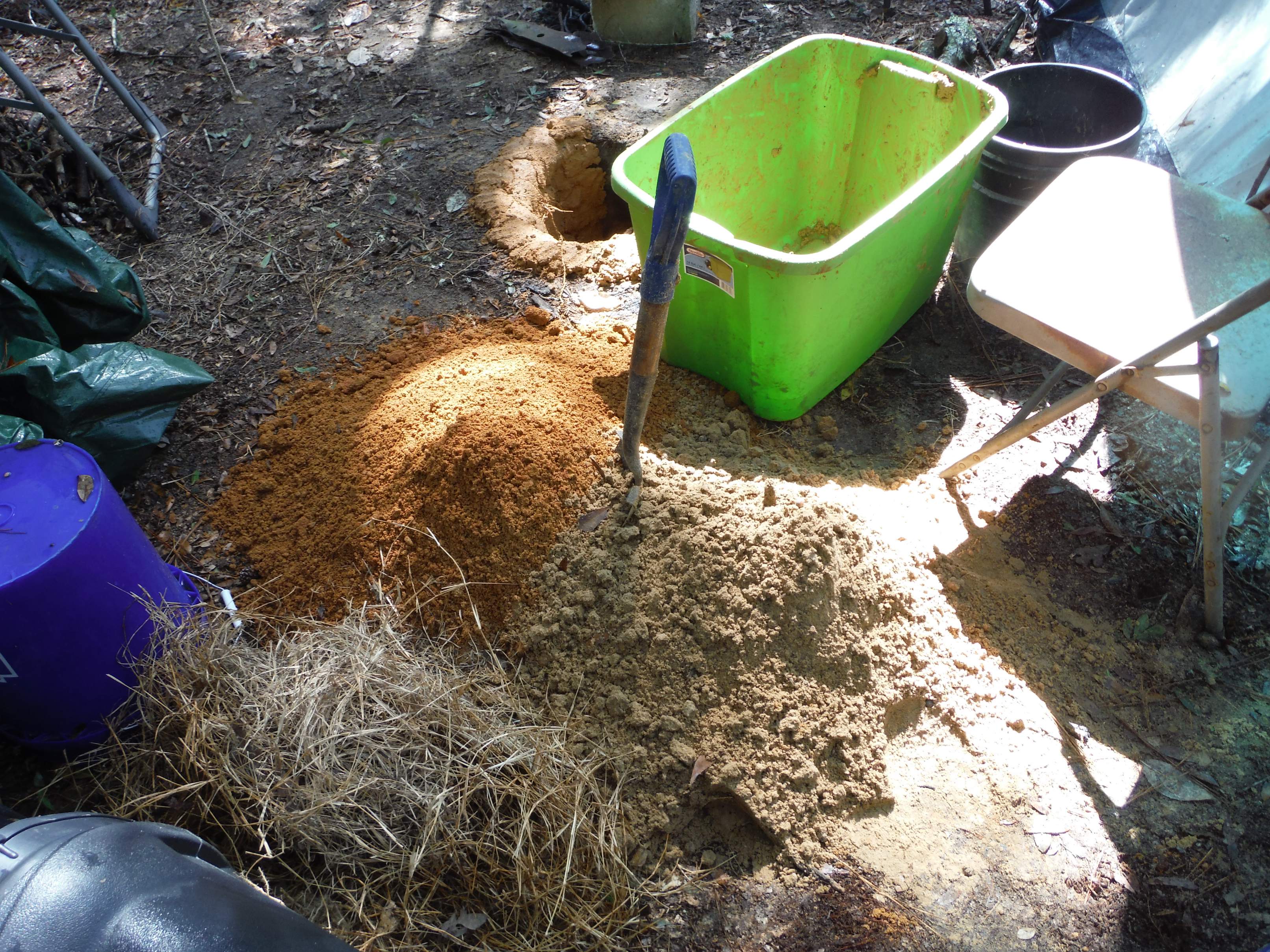

This was my first time working with cob. I used 3 parts {surprisingly good looking} clay, 2 parts sand, 1 1/2 parts water and a certain amount of straw to make the mud. I lined the bottom and sides of the hole, then mounded up a "chimney". The hole is bigger than the stove-top I had planned {used mower blades}, so I'm going to have to come up with another plan. I covered it with an old tarp so it can dry out slow. A few day's time will tell how good a job I did.

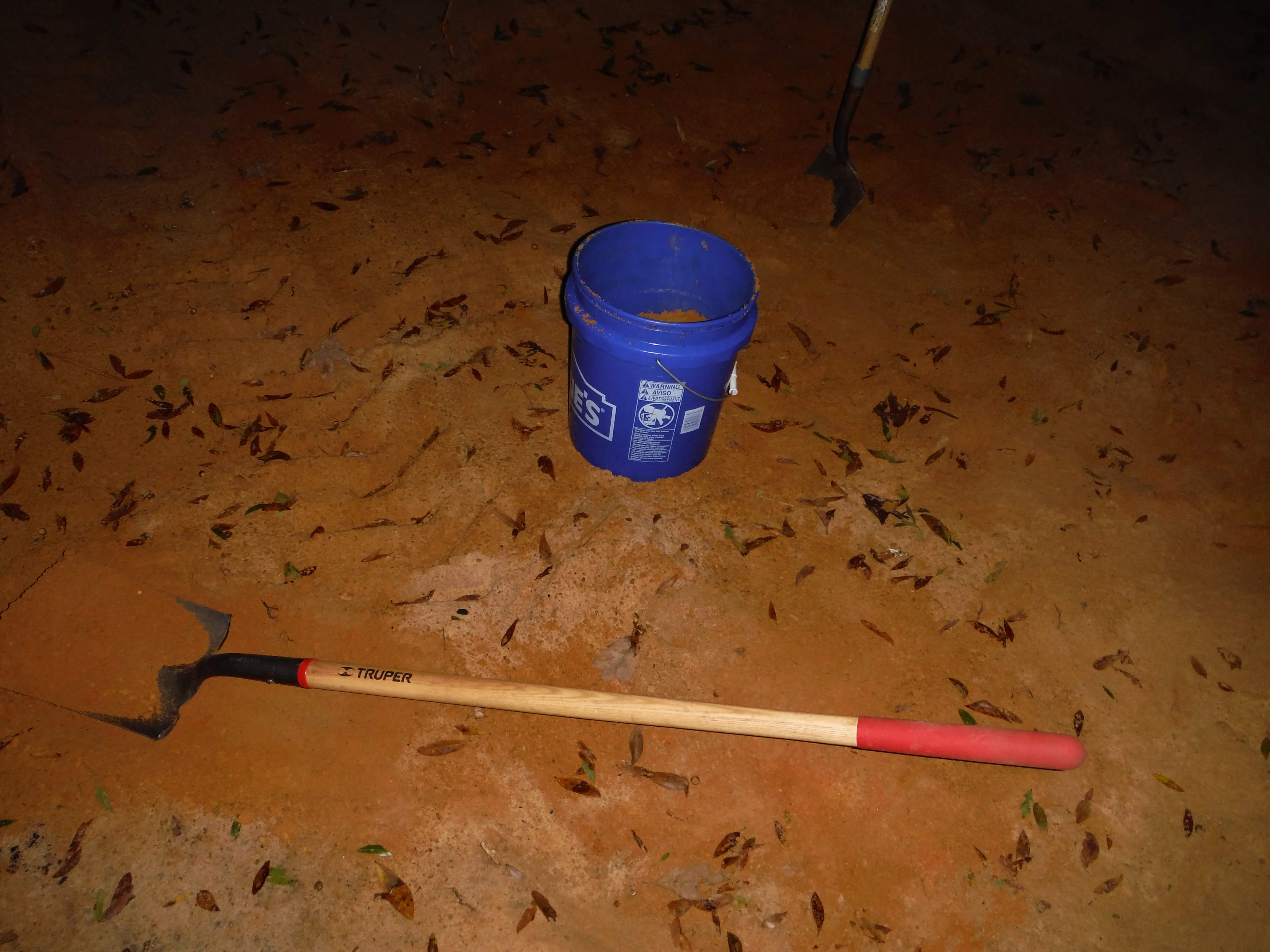

Do you have a hole or something to the bottom to feed it air?

I used hole diggers and a trenching shovel to dig the air hole. This is a nighttime picture, but you can see the fire at the end of the air hole. {the broken block is to keep me from having a broken ankle} The times I had a fire in it, it drew really well. The higher up I go with the chimney, the better it will draw.

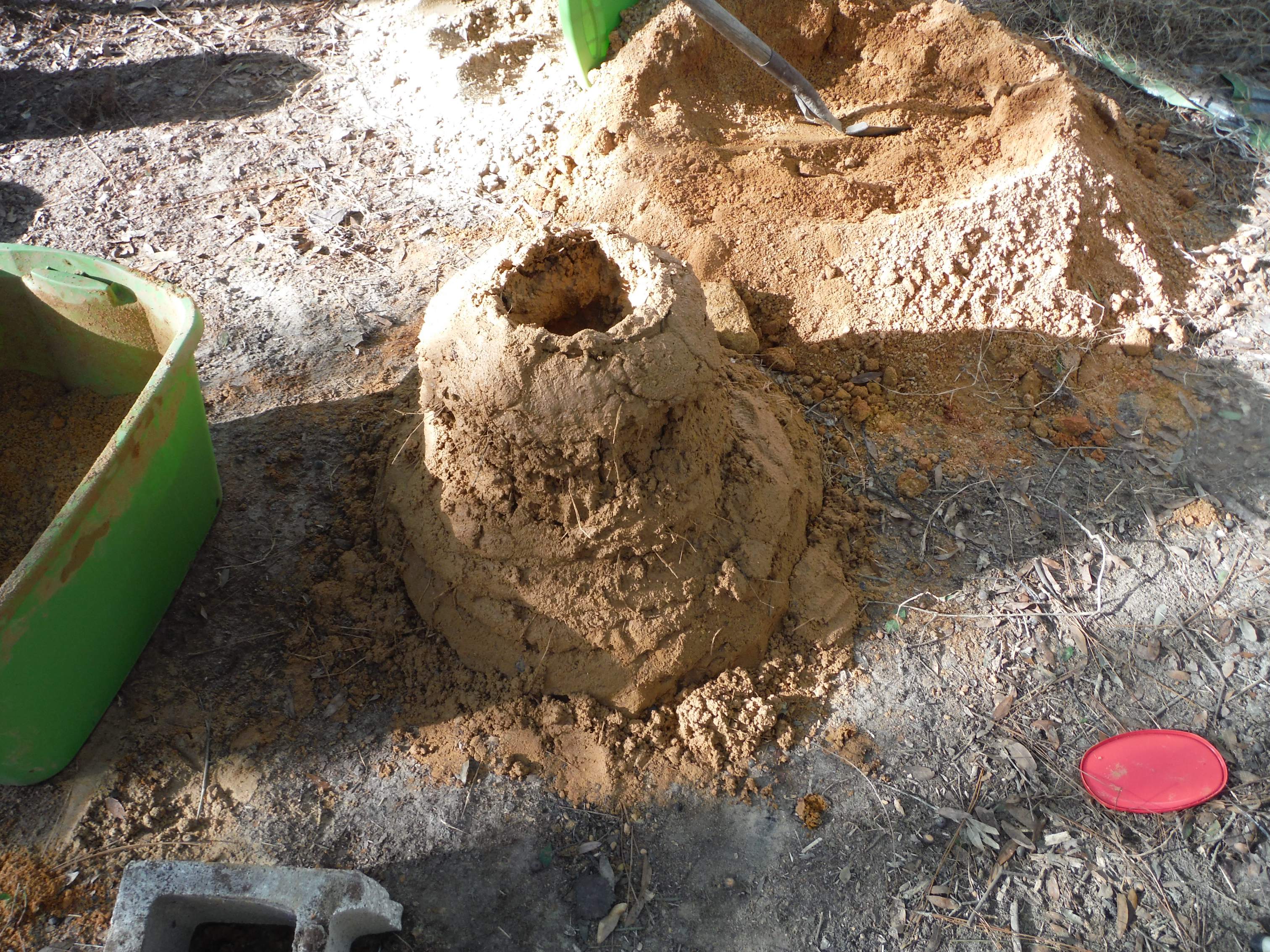

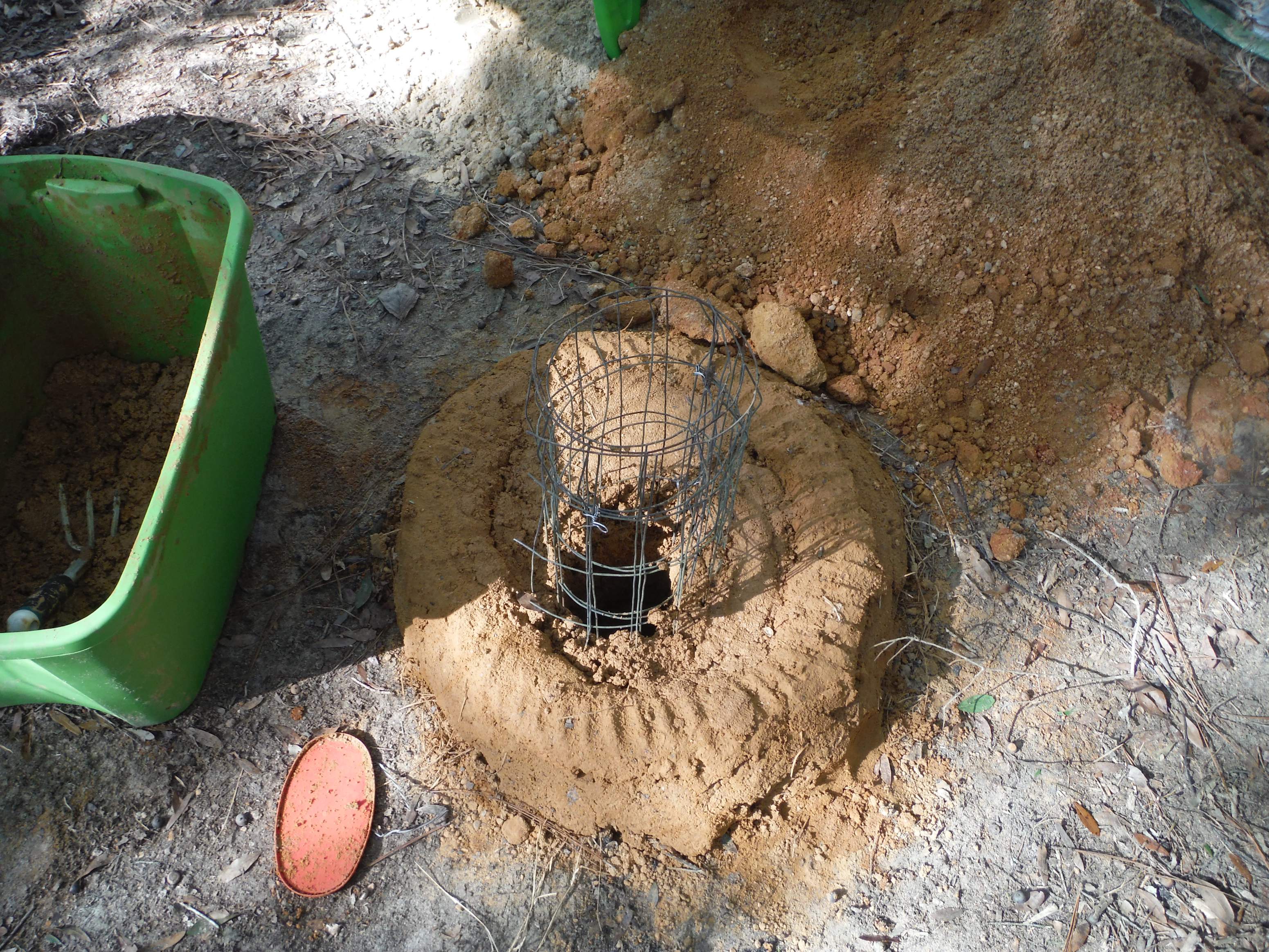

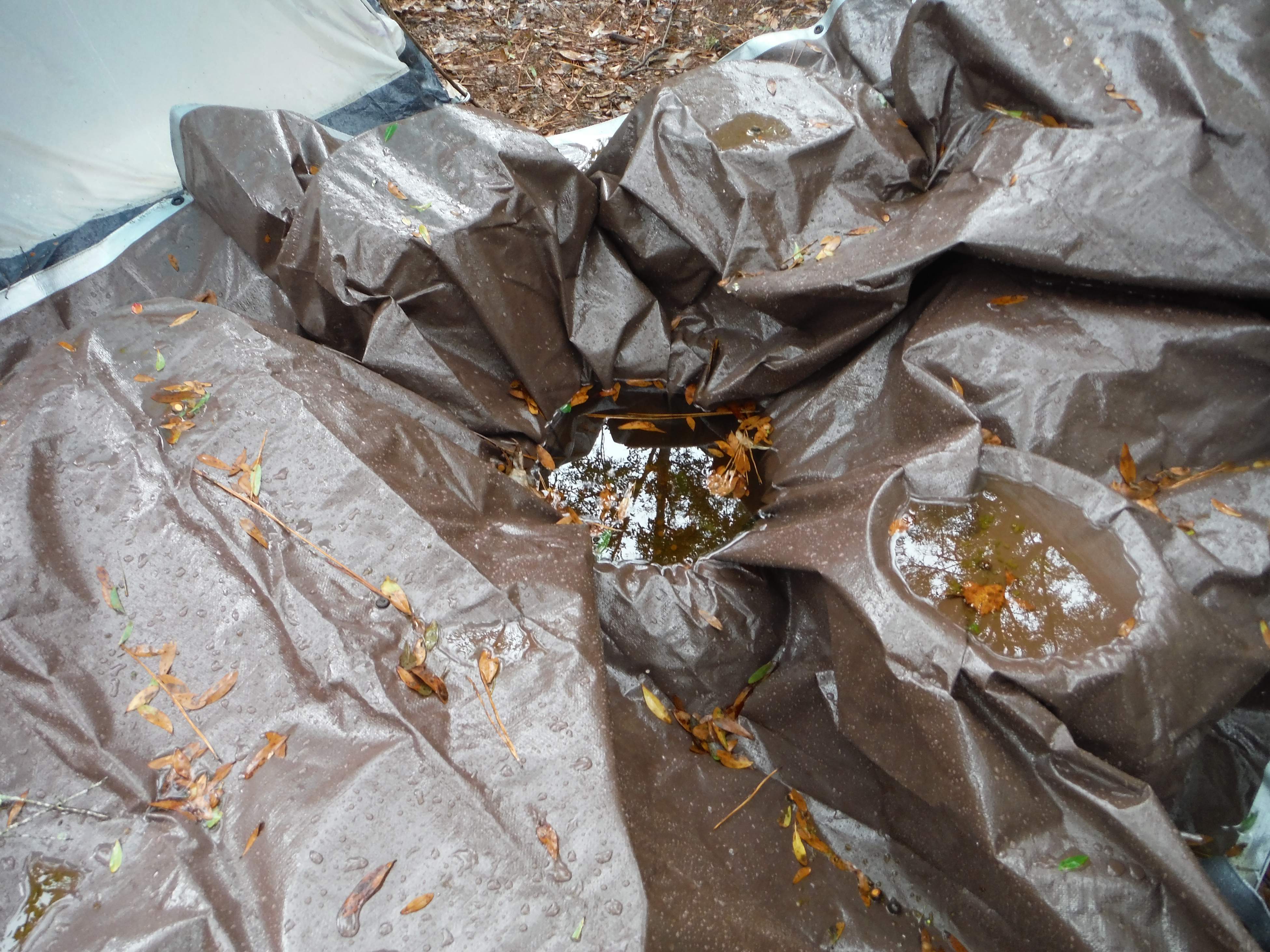

I got over to the camp yesterday and had a look at the Fox stove. The tarp was holding water in the hole, so it wasn't drying out too fast.
All the cob was still in place.
Here is what I came up with to reduce the size and increase the height of the chimney.
I did mix up a small batch of cob and put on the chimney, but I was running late for work and didn't get a picture.

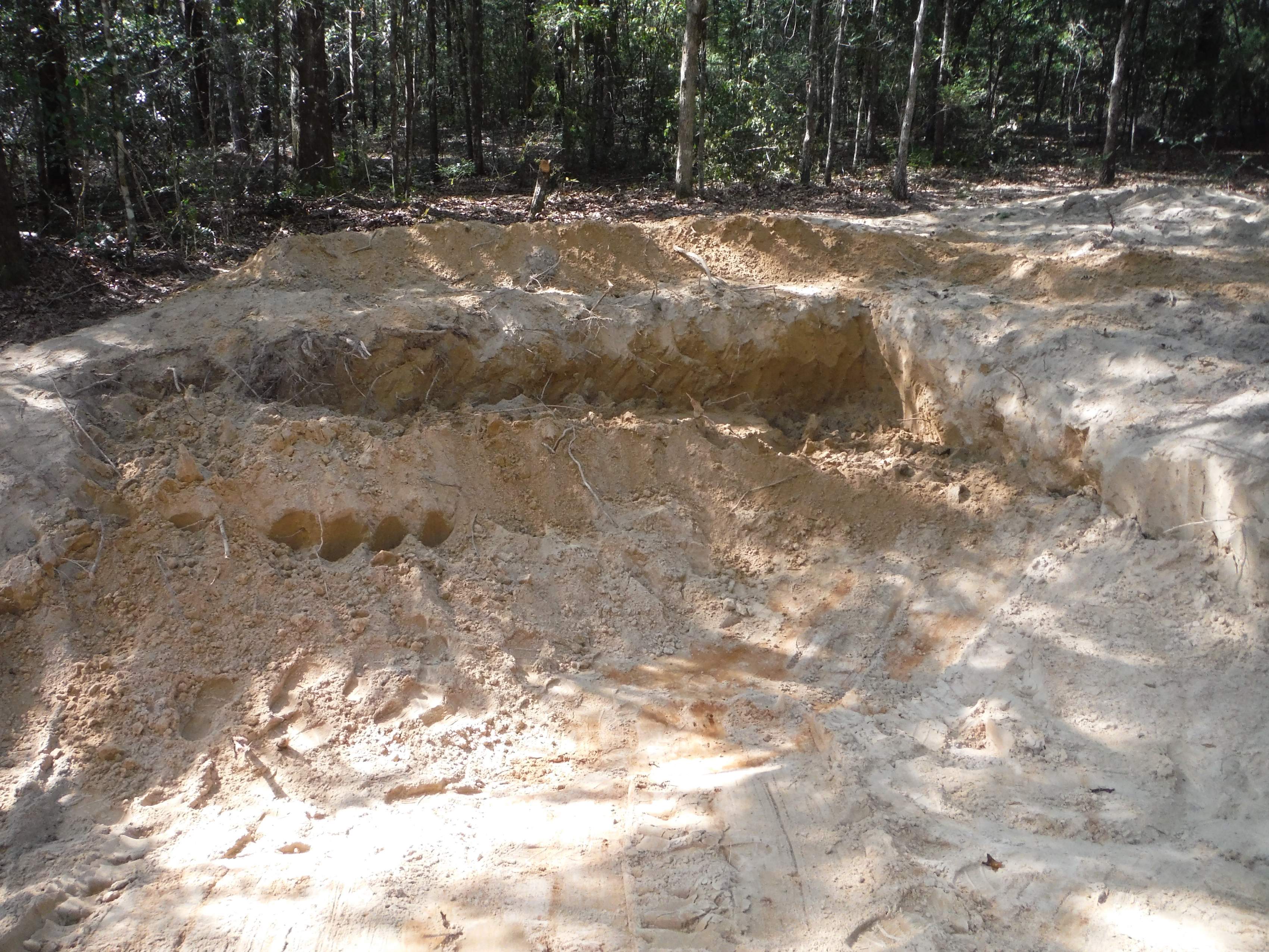

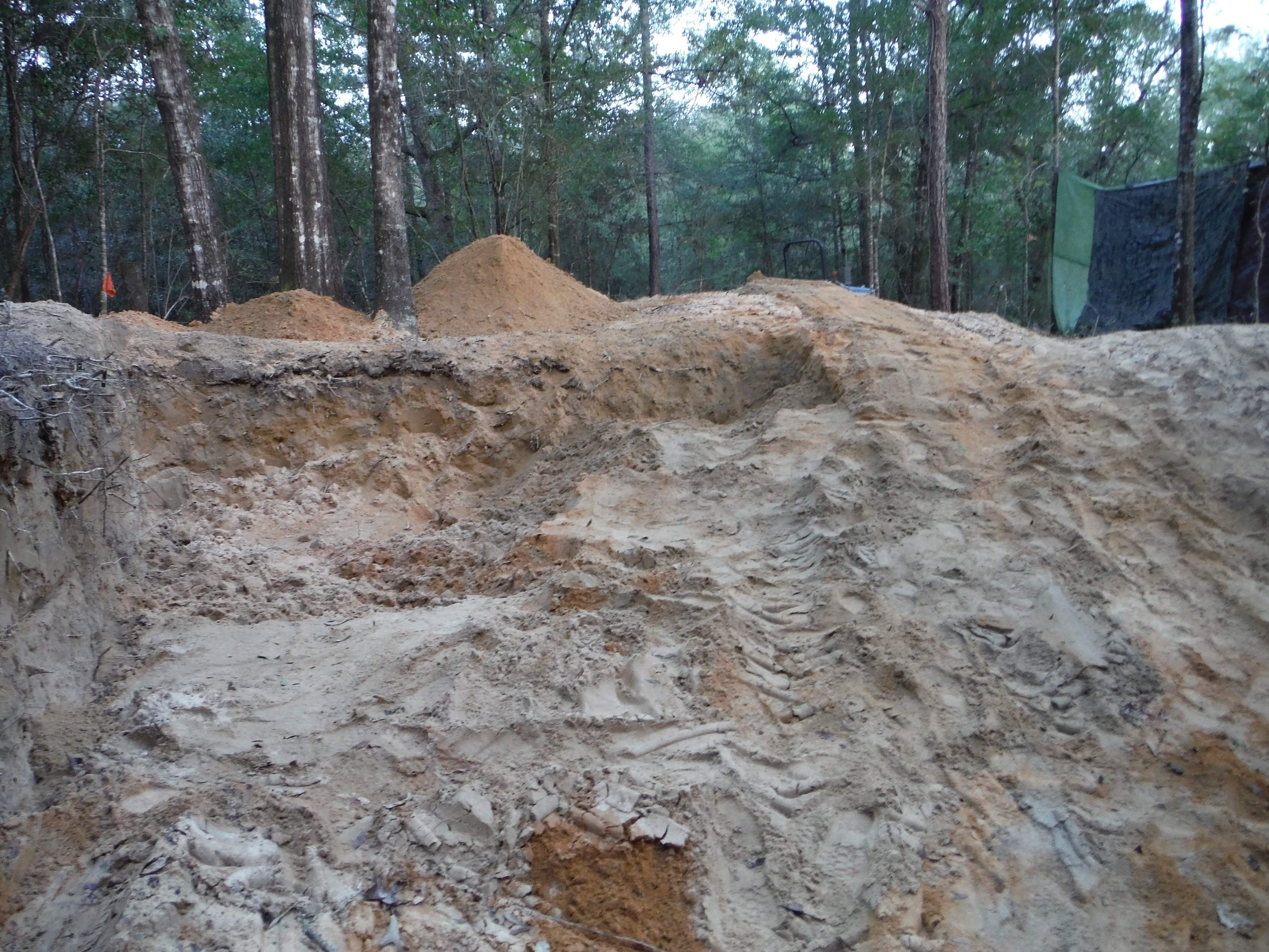

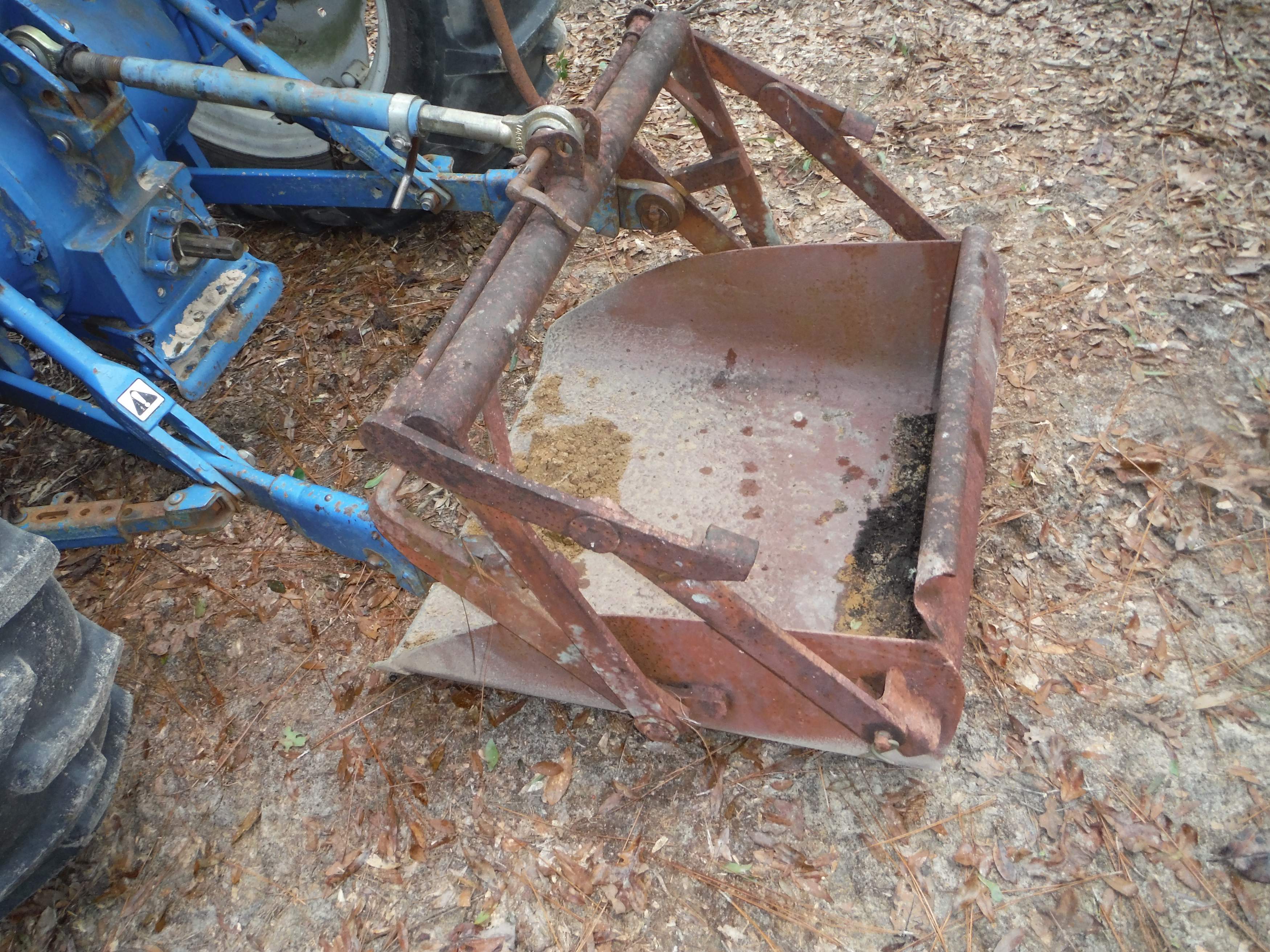

I made a few passes with the dirt slip this afternoon, but the ramp is getting too steep for the 3930. I have a small grader blade that I will try on the B75, and see if I can move some more that way. But for now I'm working around the corners and edges with the shovel.
I did go ahead and replenish my cob supply.
I bought a 4X8 pup tent at the thrift store this week. Last night I pitched it and spent the night down there. Pup tents are designed for younger folks.

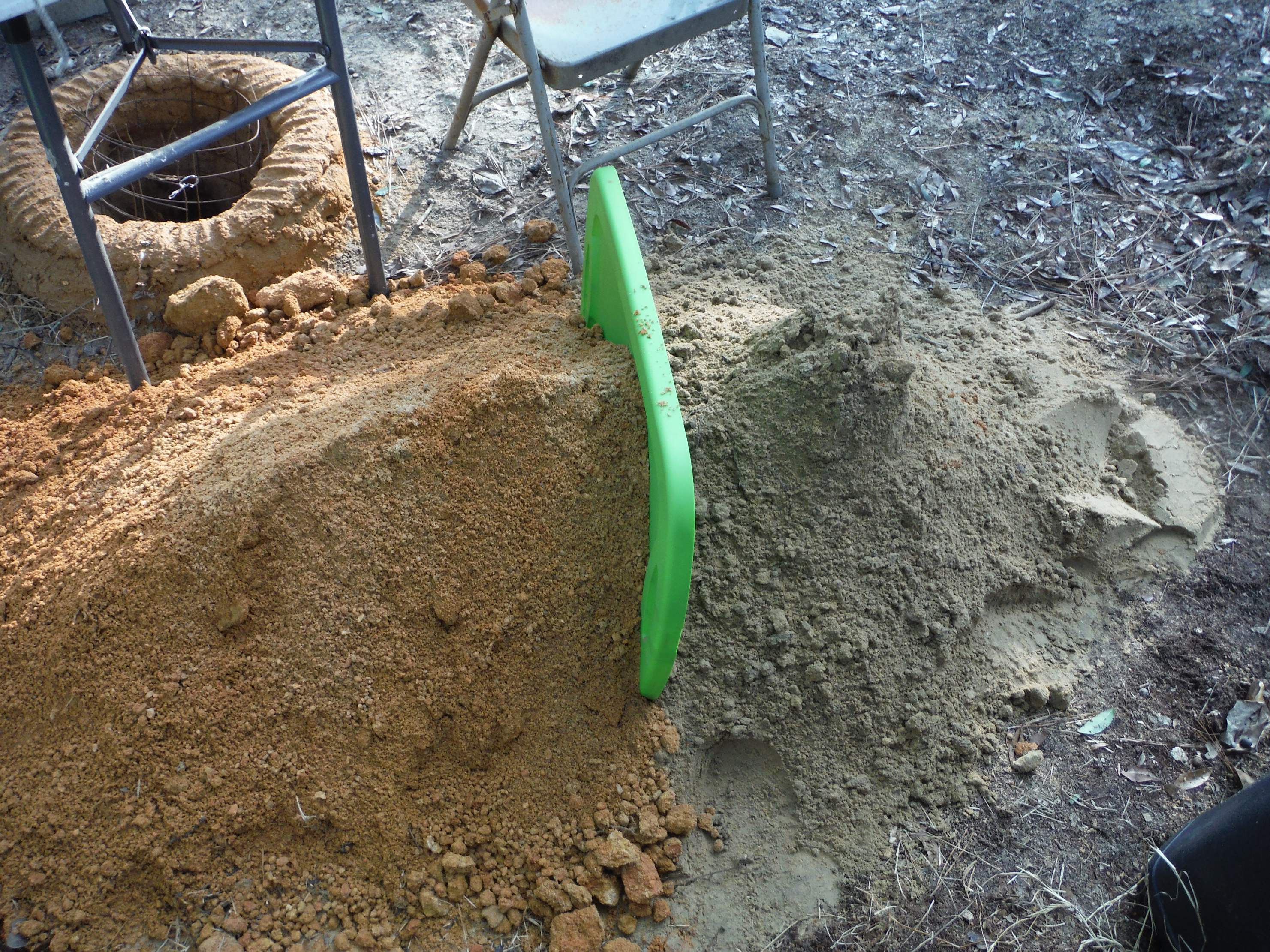

This morning when I was shoveling, I saw five or six pieces of {what we call} sandstone. It's really just big clumps of clay that looks like rocks. They will break up if you apply enough pressure.

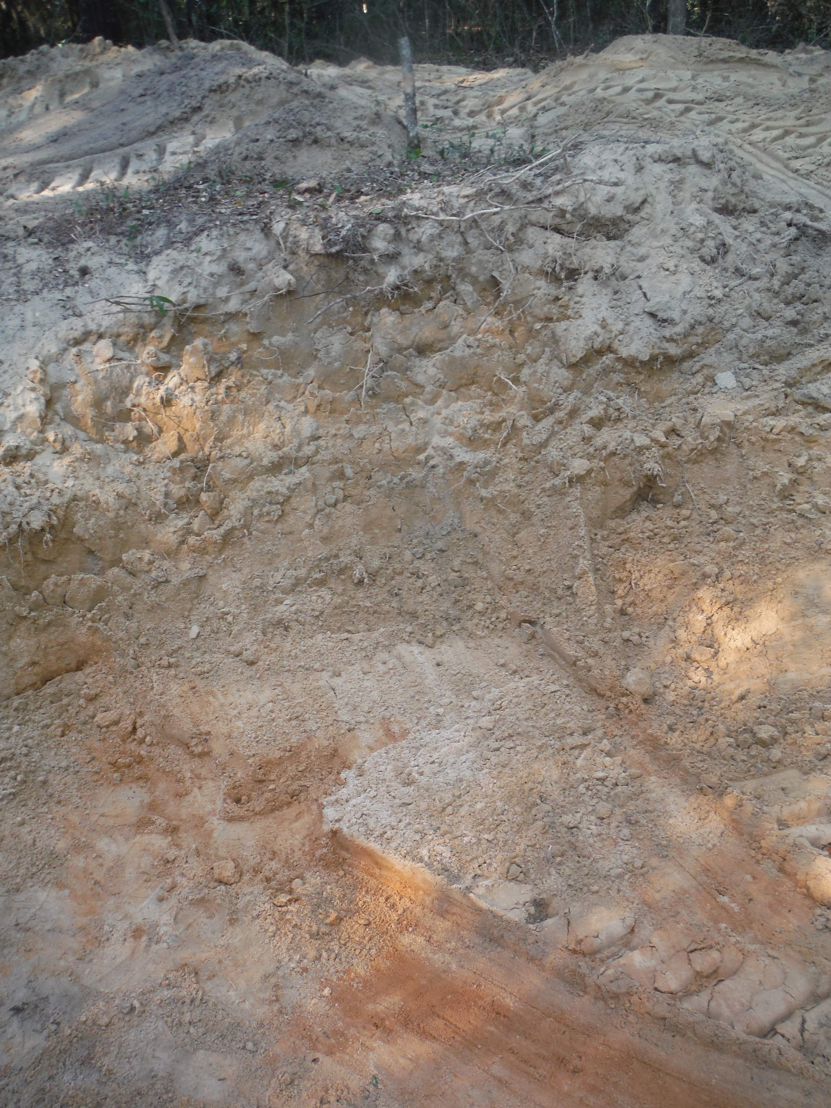

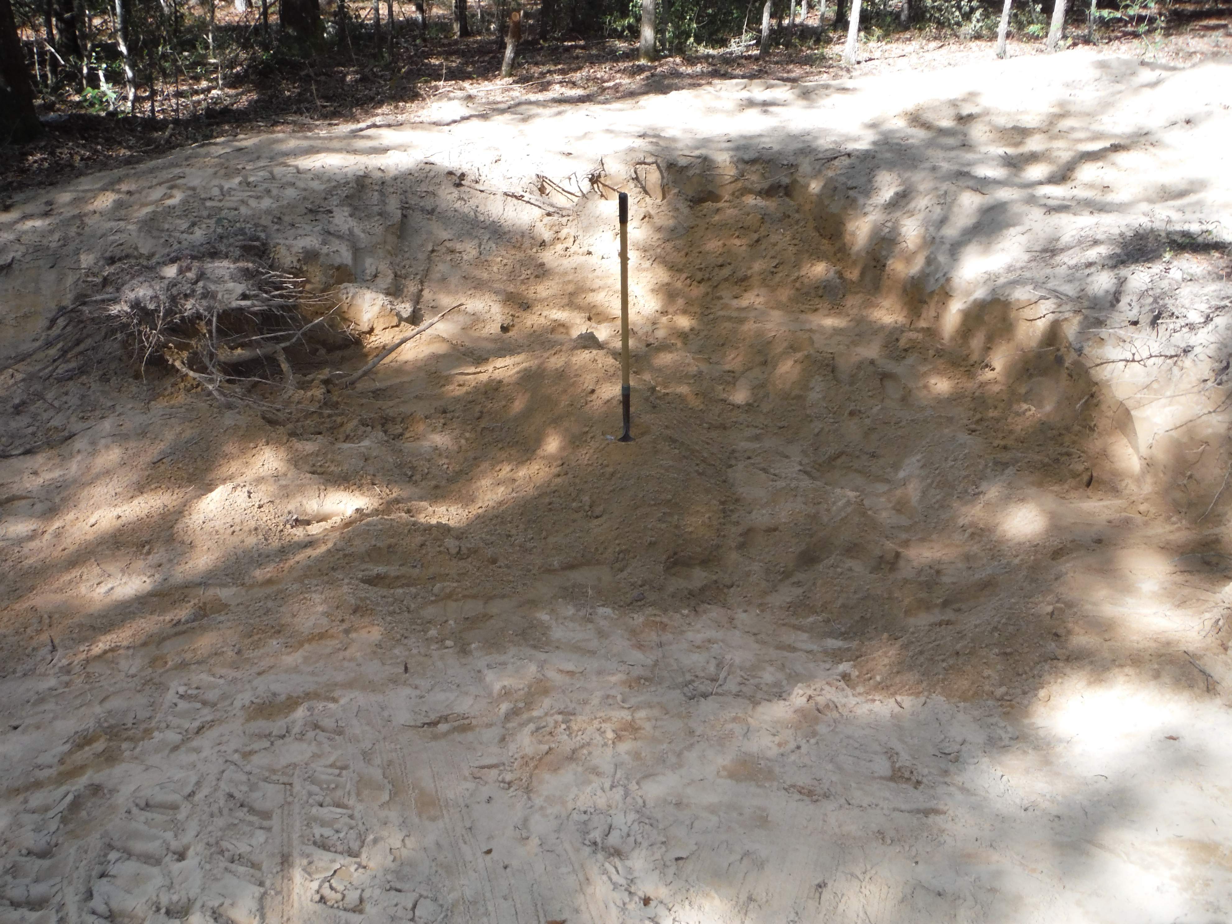

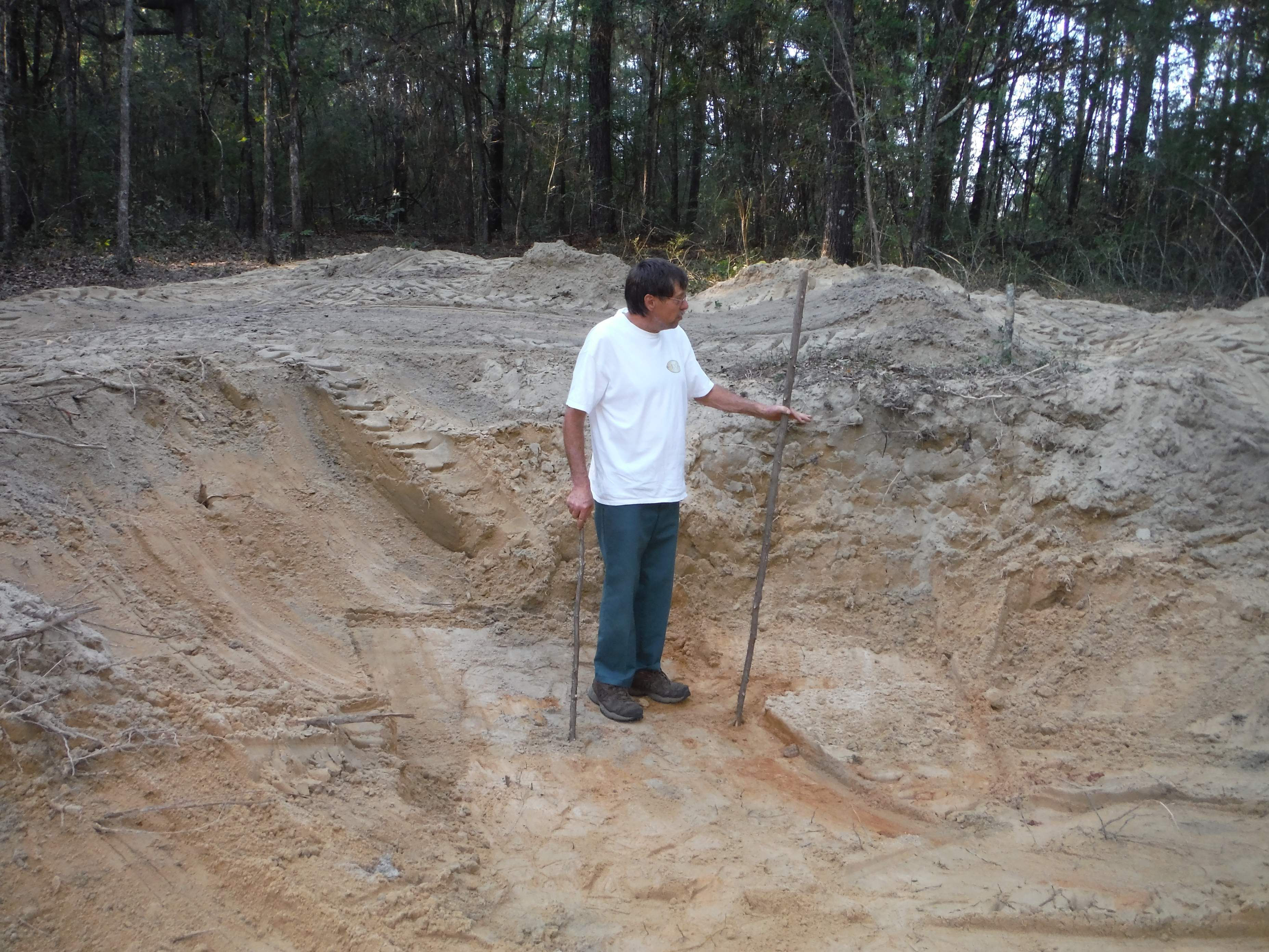

I'm down to five foot in the Northwest corner. Now I just have to get the rest of it down to that level.

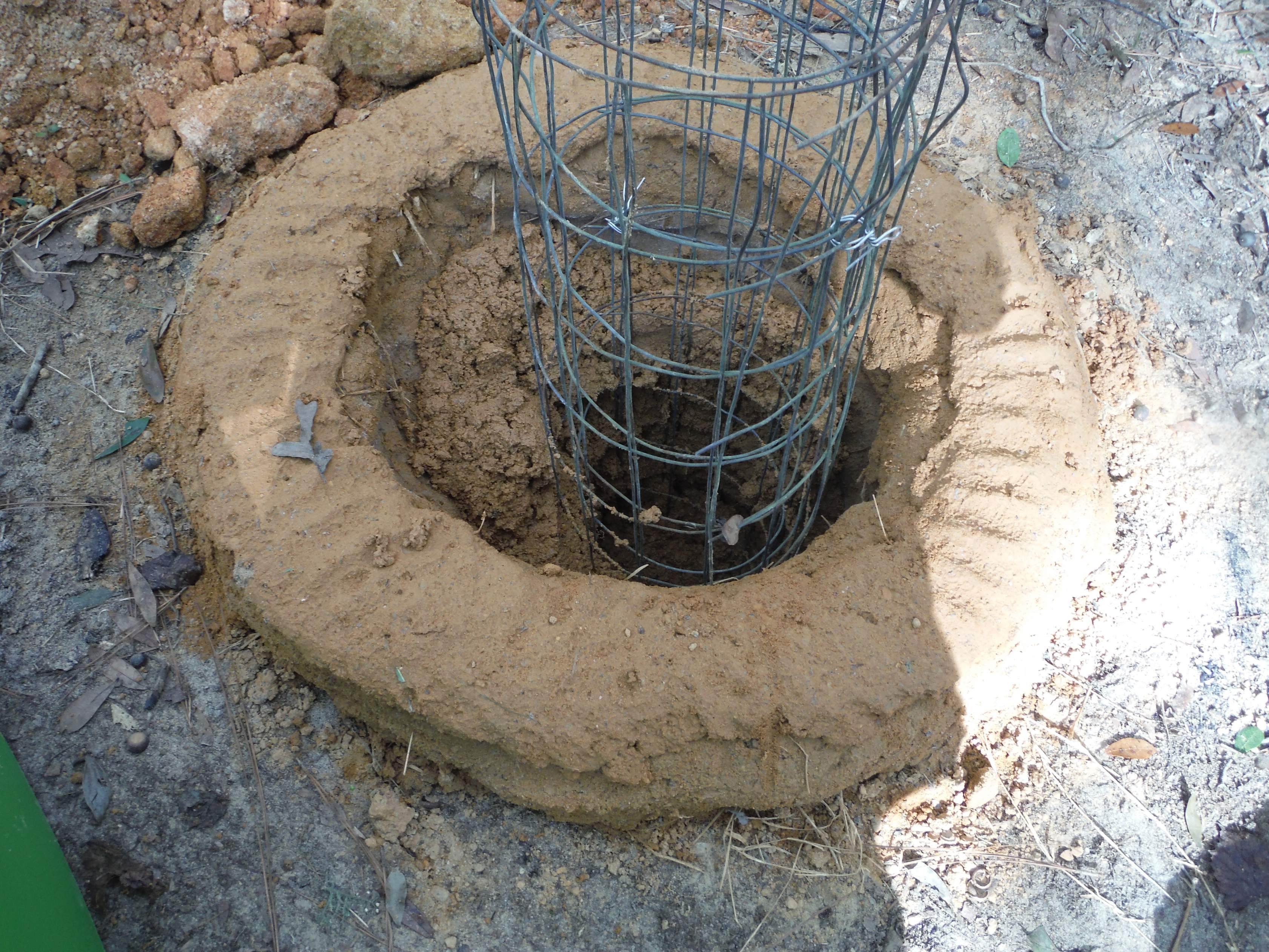

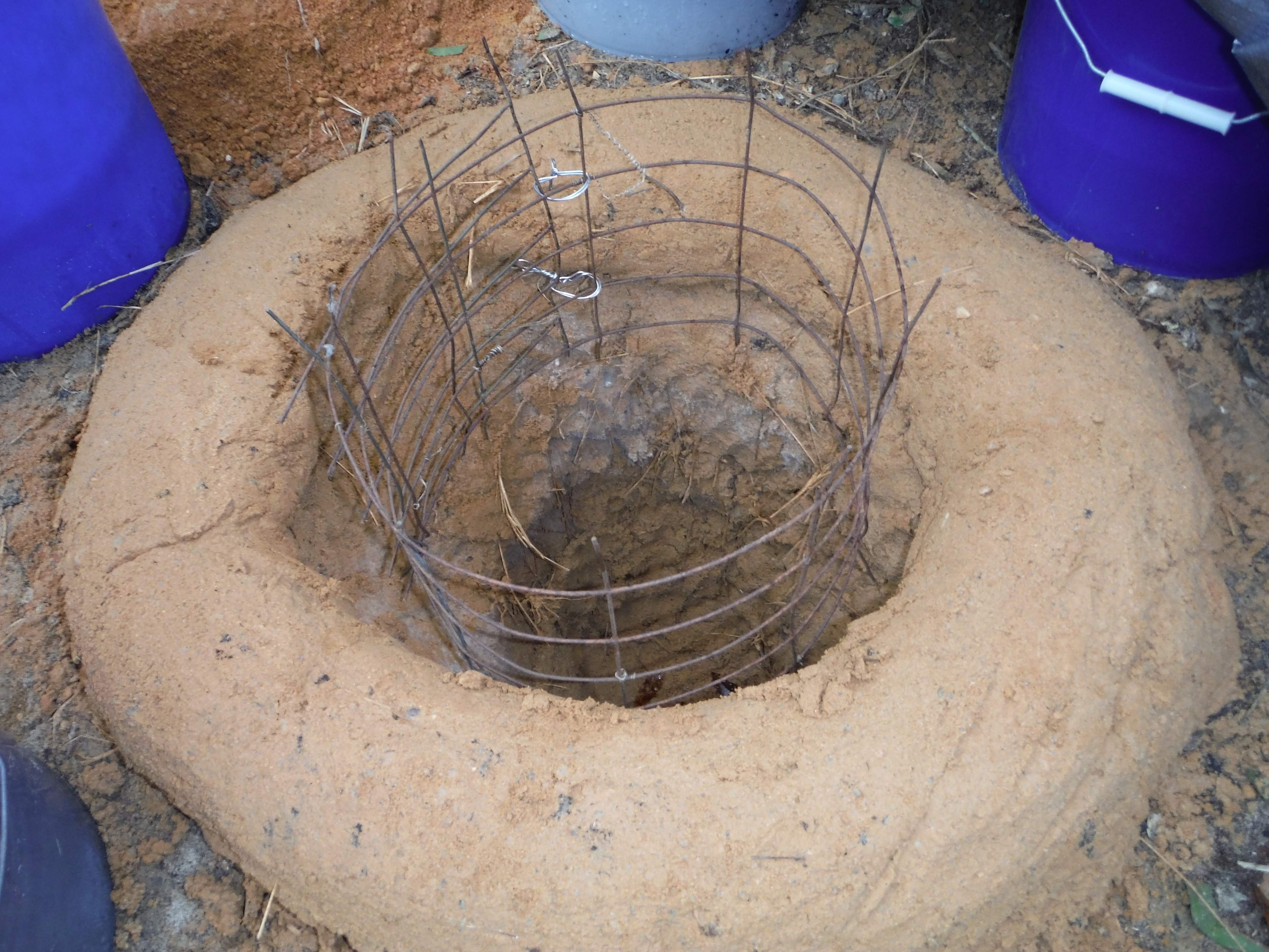

I worked on the Fox stove again today. I used some old wire to form a structure to support the cob needed to bring the chimney up. I filled in mud around the base, and brought it on up to the top of the wire. There was some major cracking going on right as I was leaving, but it was too dark and I had run out of mud, so I'll work on that in a week or so. Hard to see in the picture, but I laid two lawnmower blades on edge in the cob at the top of the chimney.

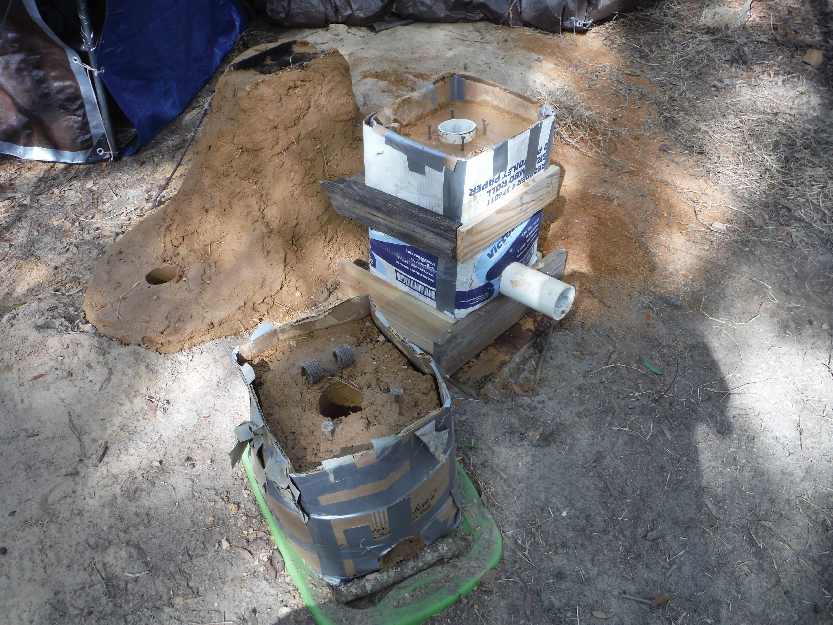

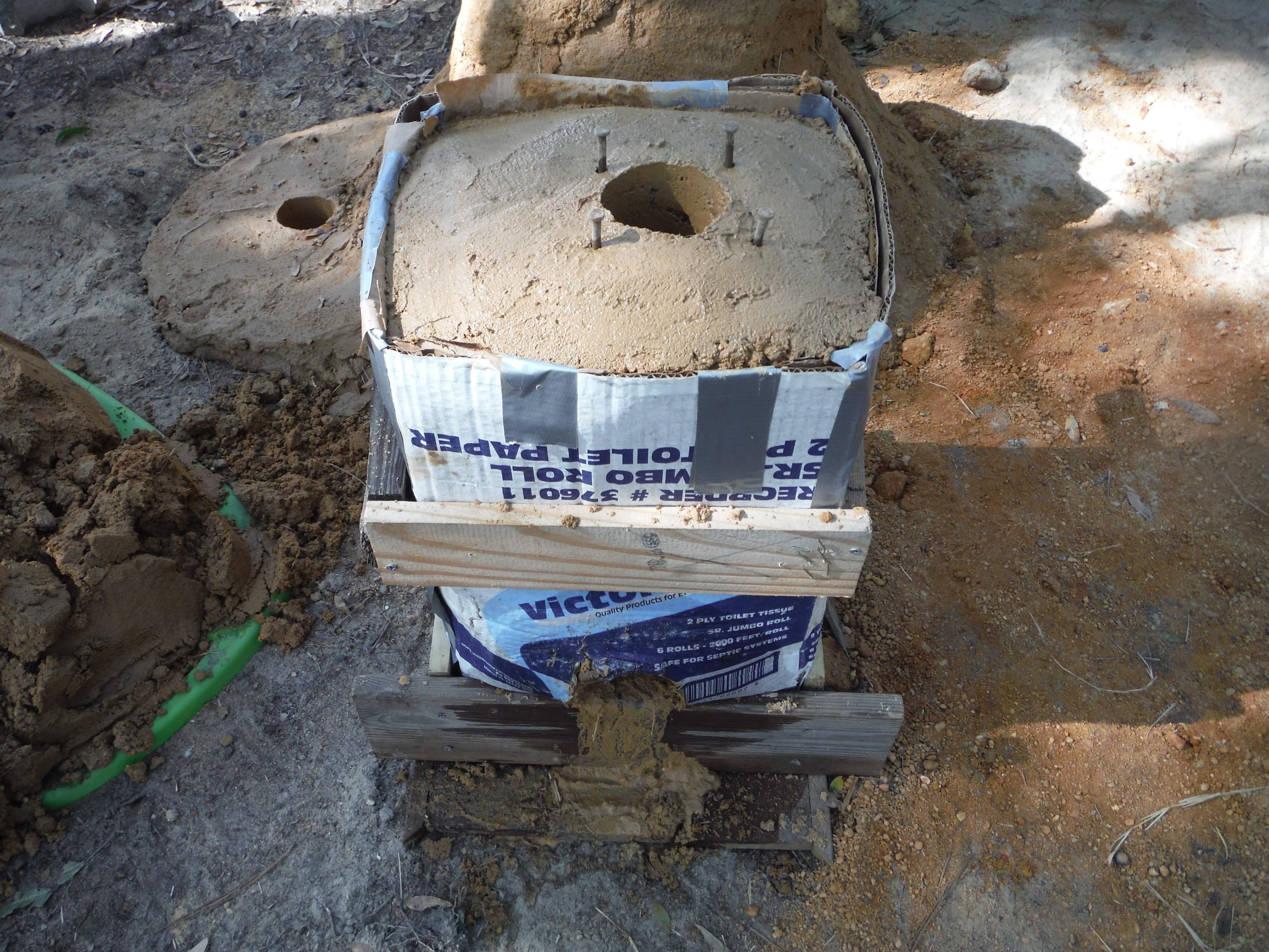

I've made a couple more rocket stoves, one of which I kept. Glad cob can be recycled, because my first cardboard box stove had bad posture. The next one with a lot more bracing held together, but I put too much duct tape on the pipes. By the time I had them pulled loose, my burn chamber and chimney were no longer level, or in the center of the stove. I may add to it to make the burn chamber level and the right length. {Or I may start fresh with bigger pipe for the holes. You can't use very big wood like it is} It burns good, but the coals roll out on the ground. I don't have a recent picture of it, but this is from two weeks ago, right after I got the pipes pulled out.
/ Larro goes underground
#79
Looking back I see I hadn't posted pictures of my addition to the original Fox stove, or the first cardboard box stove. So here is a picture to rectify that.
I don't have the right dimensions on the original stove, so it isn't as rockety as I would like it. The feed tube, burn chamber and chimney should be 1-2-4, or each one twice as long as the one proceeding it. I can fix it by cutting away part of the base of the chimney to make the burn chamber shorter, but I've been thinking about all the years I will be bending over to tend to my cooking, and I'm leaning toward starting over with an all above ground stove. As much fun as it is to shape cob free hand, building forms to pour into seems to be the smartest way to go.
