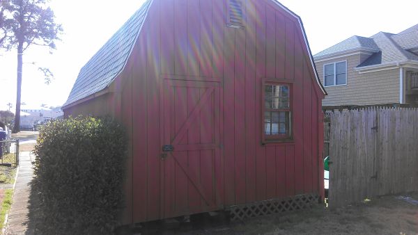

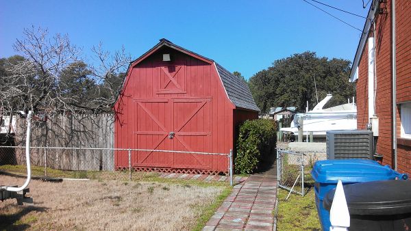

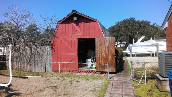

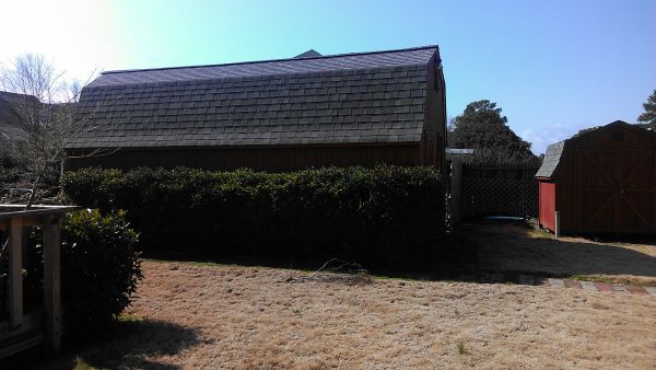

Have been working with a guy to take a shed off his hands. I'ts 12wx24Lx12'8"H. Too long & heavy for my dad's 16ft trailer, so the only guy around that could do it needs me to remove the roof. Will have to cut out the apex of the truss as well to lower it.
I'm hoping to just remove the shingles and top most apex of the gambrel but we'll see. I negotiated price on shed to $500 and the mover wants $650. It's about 30 miles away through busy Hampton Roads traffic.
It will be some work removing shingles but I wont have to dispose of them and if I have to remove all plywood from roof that will just be fartastic! So I'm hoping I can get away with removing plywood from the midpoint of gambrel to apex.
I hope that by doing this I'm saving dollars on a similar sized shed. What do you guys think? I'm nutz right?

That is a nice shed, well worth more than you will have in it if there is not rot. IIRC those would be about $3K or more here in new condition. Does it have a loft storage, it looks like it does.
   / Large Shed Move
Yep. It does have a loft/overhead storage. There was no visible rot when I looked at it. I could only briefly look underneath as it was raining but no leaks in roof while raining. It's on blocks and 6x6 pressure treat skids.
My daughter wanted an "art studio" and one side has a walled off, paneled room which I will surprise her with if I can make it happen. The other nice thing about this shed is that it has loads of wiring/outlets and it's own panel which that would probably run me another $200-$250 maybe to go buy new.
Wish I could rent a trailer to get it home without tearing into the roof but I don't think I could get one low enough.

I'd say materials wise you are ahead, providing there is no rot.
If the roof was manufactured trusses you will need to tie them where U remove the top section.
From your pics it looks to be board siding so I'd add diagonal temporary bracing all corners in both directions to prevent racking the framework. Simple 1 by stock will do this, just nail at every stud. Were it plywood sheeting that would not be necessary.
Again if the floor is planking nail furring in a big X from corner to corner again to prevent racking. If plywood, don't bother.
Re shingling the whole roof will assure you of a good 20 years service so that's no loss to re do.
No, providing you have the skills and time IMHO you get a 'cost effective' shed with lots of space.
At 12'8" H you also get a cool loft for storage, even if U need to add a loft floor.
If no loft floor you might add joists before the move as that would keep the 'box' square (and be ready for loft flooring.)
Good luck, I know that I would very consider this for myself.
Hey, with a door change you'd have a cool tractor shed.

I think you will compromise the structural integrity of the building if you cut the tops of the truss's. 30 miles is a long ways to haul a building. You should brace the interior regardless.
