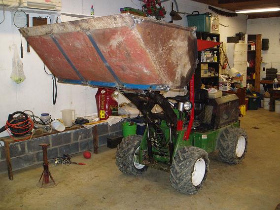

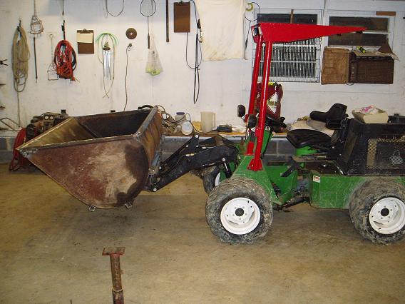

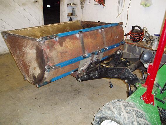

I wanted to add these picks to show the importance of how far to tilt the adaptor plate forward. The oil tanks skin is 16 gauge or about .060 in thick. 1 ½ “ box tubing, all the rest was built of ¼” plate. Except the cutter bar it being a sharpened off ½ or 5/8” bar
Weld only around the edges or closes to all edges; Reframe from putting any tacks in the middle. They can cause grief buy busting loose. Let it float inside what little it will, Tie all the braces together.

this shows full tilt foward.

This shows full tilt back. If the plate were not mounted with a foward tilt i don't believe the bucket would carry right.
