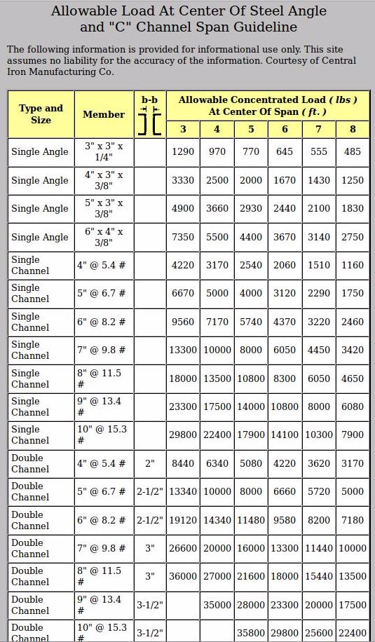

I think you'll find square and rectangular tubing to be quite expensive.
Here is an angle iron and C-channel chart that may be of some help to you.

Very interesting to hear about pricing in different location. In my area square, and rectangular tubing is outrageous in price.:shocked:
If you do decide to go with tubing, may be these charts will help. The spans are awfully short tho.:confused:
