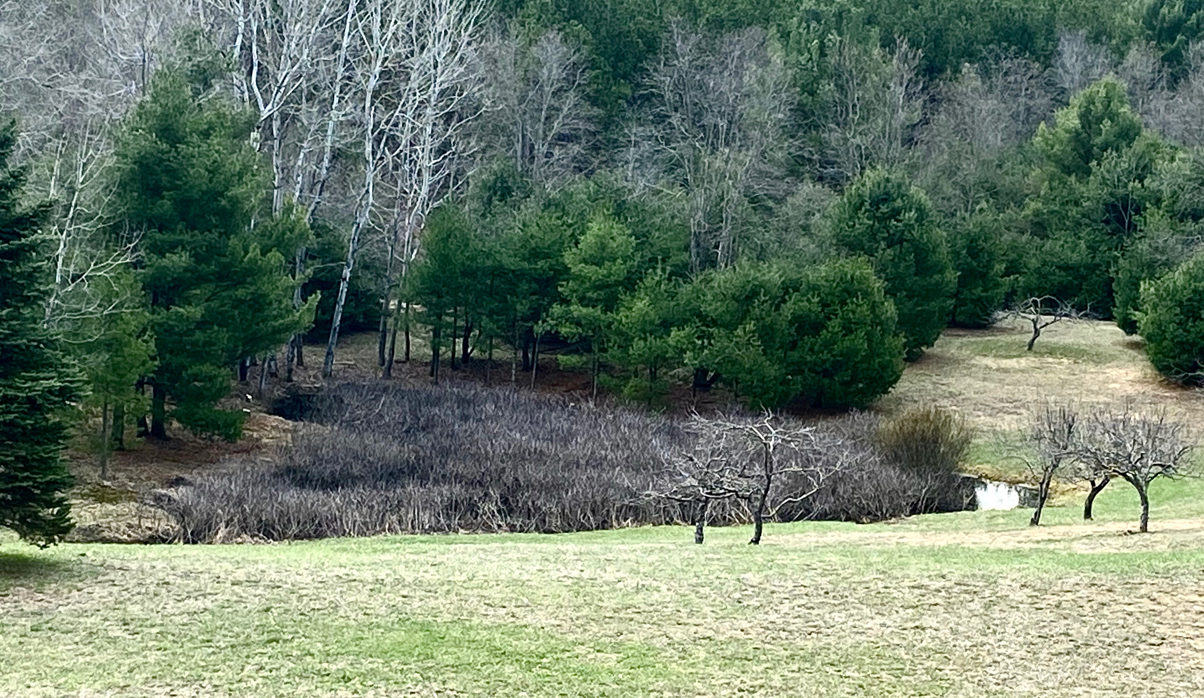

My method was to back up to the edge of the woodline and pull the gak in the direction of the pile. When I got a good rake full (of dirt and debris), I would lift the rake slowly and roll the debris up on top of the dirt windrow.
I would time all of the “rake lifting” about the same, so all of the debris was in a row or close. Then I would idle the tractor perpendicular to the windrow and, with a stone rake, pick it up and throw it in the bucket. After I cleaned the windrow, I would re-rake the area to make it smooth. IMG_0552.jpg
It did take a long time, because the debris came from a swamp dig-out which was buck brush.
It is now clean, limed, cultipacked and waiting for rain.
I would time all of the “rake lifting” about the same, so all of the debris was in a row or close. Then I would idle the tractor perpendicular to the windrow and, with a stone rake, pick it up and throw it in the bucket. After I cleaned the windrow, I would re-rake the area to make it smooth. View attachment 662551
Looks beautiful. Nice job.
