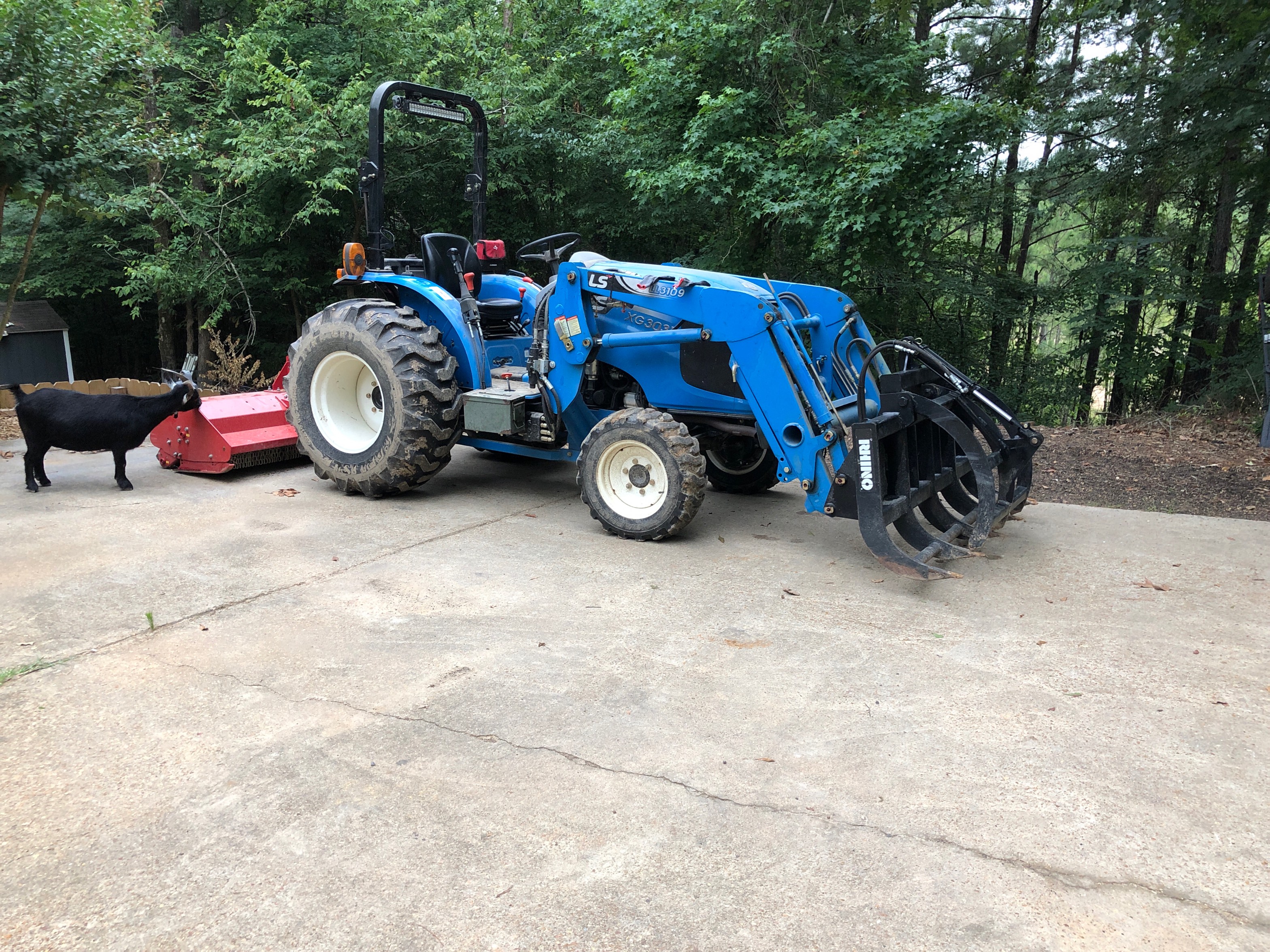

Talk me out of buying a Landscape Rake. I have an LS XG3037 and several other attachments. I think I want a landscape rake to help in clearing limbs, sticks, root debris from where I am cutting/thinning my wooded area.
I already have a RhinoAG grapple and use it in clearing brush and assisting in cutting/moving logs. However, I find it difficult to move and gather smaller debris. I use the flail mower to go through after the bigger stuff has been moved or chipped with a portable chipper shredder.
I have a box blade that I use in repairing and maintaining of my gravel drive. I WANT a landscape rake but can’t decide if I NEED one. Are there any suggestions to use the grapple, box blade, FEL bucket or anything else to keep from spending $600.00-$1,200.00 on a landscape rake?

I think from the photo of your grapple, the wide open space of your grapple fingers, means your best list implement/ attachment for gathering small twigs, limbs and brush would do a poor job at best and more likely worse than that. None of the other mentioned implements or your bucket are going to gather them without large clumps of dirt being collected along with these types of debris.
While I readily identify with not wanting to spend more money on more implements, this is another type that getting the right tool for the job is the thing to do.
You may shop around—FB marketplace and craigslist maybe others for a slightly used in great shape rake, but the few times I have looked at rakes, the owners must think they are better than new ones even with missing and broken tines. You have priced a few new ones from the sound of it, so you are well informed to make quick decisions to if a used one is worth pursuing. You may price replacement tine cost before you shop for used.

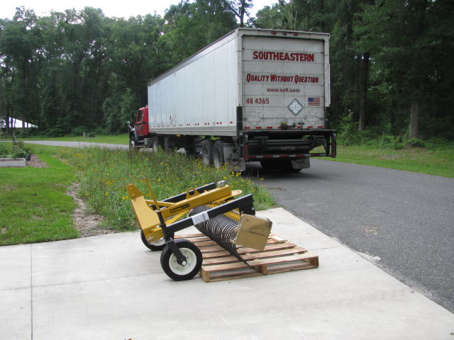

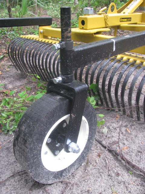

I just received my new EA landscape rake last night, haven't even unpacked it yet. I see no reason to talk you out of something unless it would take food out of your family's mouth. We have these tools because they make our lives easier. Having the proper implements amplifies our efforts and increases the likelihood of a positive outcome. If the funds are available, I would proceed. And I found used landscape rakes for less than 15% off new pricing, and have little patience for fixing others junk, so I went with the best I was aware of. Not cheap, but should be the only rake I need for the rest of my life.

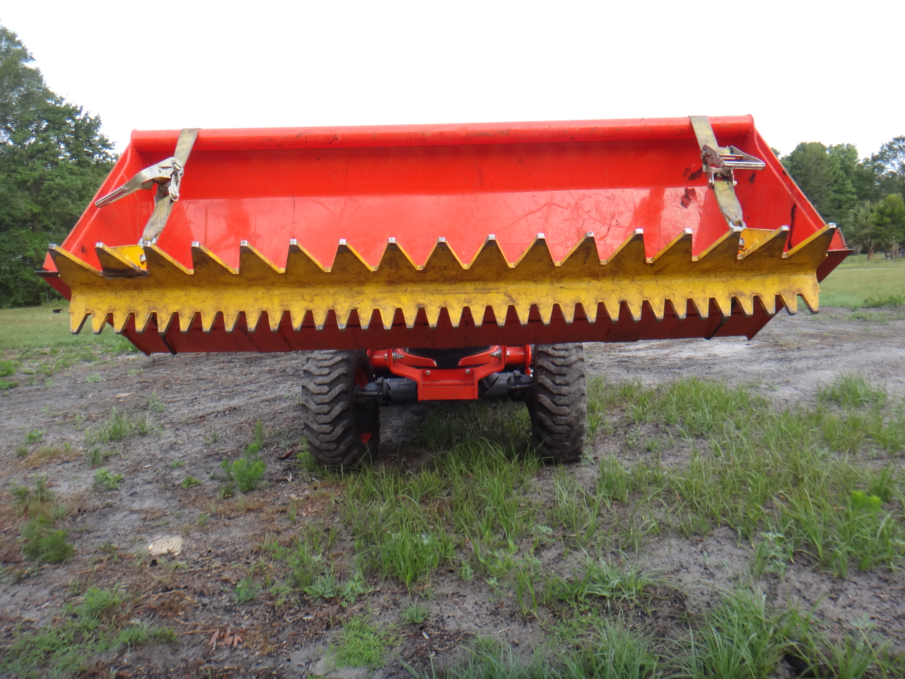

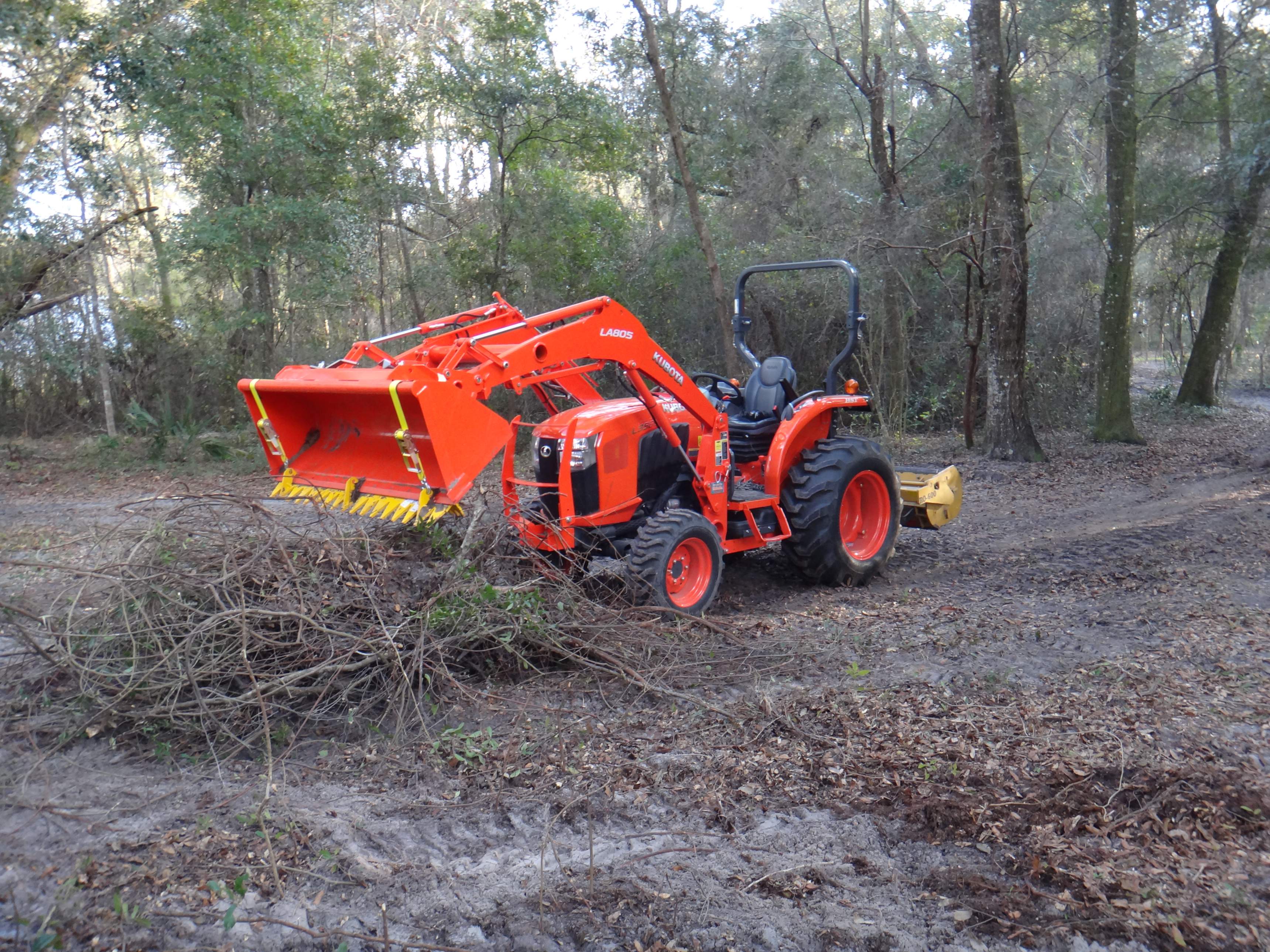

A Ratchet Rake bucket attachment is great for corralling debris to subsequently transport with a grapple.
Much better than a Landscape Rake.
Appreciated Jeff. This may be the ticket item right here.
CoyPatten,
I appreciate your reading, understanding and evaluation. It’s just what I needed to hear.

I bought a landscape rake about 8 years ago. It was very used and cheap. It has a pair of funky gauge wheels that I sometimes use and other times adjust them up and out of the way. It was very useful when we tamed and seeded a small adjoining lot we bought back in 2012. Now it gets used maybe two or three times a year. It's useful for doing areas where I reseed after tree removal, etc. Occasionally when the creek floods, there can be patches of corn stalk or soybean debris that are larger than I want to clean up by tossing it into the loader with a pitch fork. If I ever getr caught up with several other little projects I plan to make a 3PH adaptor for the FEL and use it to reach into the fence row to drag out the debris.

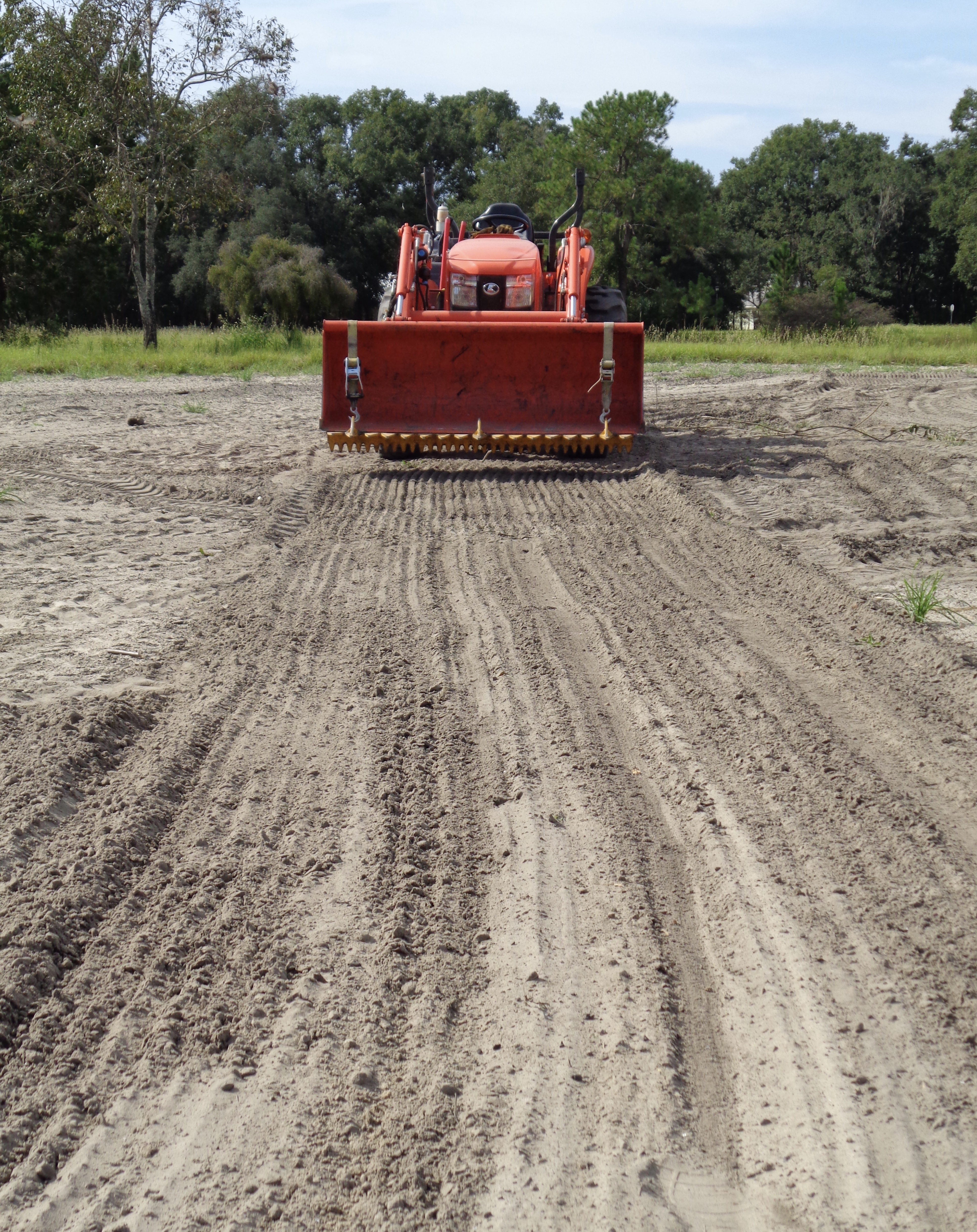

I love my Craigslist Countyline LR. I removed everyother tine and did a new food plot.
Raking gak (debri) into a windrow and then throwing it into the bucket by hand is a lot easier than chasing it all over hell’s half acre.

That had to take a while. Looks really good. What method did you use? Windrows into multiple small piles then picked up with the bucket or grapple or just raking across the whole thing.
